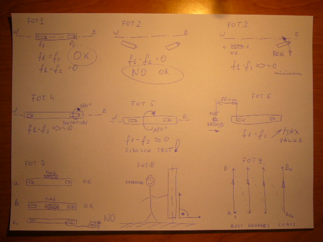

                      Calibration
                      Hi Damiafix.
                      If you will permit, then I will show, as I understand "Calibration". On desk and by hand but I came back with works near home garden just and beer drinks.
                      Fot1. Ideal situation; unreal, because manufacturer FGM3 does not sell them evaporated; they differ with frequency and inclination profile (tenderness, sensitive).
                      Fot2. Very bad!. Frequent mistake. FGM stood one should to be in line W / E it because was can in one point get apparent equilibrium, and to get in 2 different places about several degrees 0Hz even. Control and prevention how in Fot5.
                      Fot3. Regulating get one FGM minimum Hz / V in line W / E. Seem oneself, that procedure construction from square of Al Fitz it is risky, is sure Al this diamagnetic le rotational currents near frequency FGM about 75kHz 1 cm from axis of coil will give already to know and this causes inequality. I think construction Panzerfaust and Geo despite trouble is safe. This only my modest sentence.
                      Fot4. They in my construction of probe be placed in rolled out artist, I think in good axis. I regulate turning over on minimum one probe about 180 degrees unfortunately, my probes also oneself they differ a bit.
                      Fot5. Final control then turn MAG about 180 degrees in line W/E tell about completely . Evidently assembled device. They nearer zero by whole turn this larger congratulations for constructor!
                      Fot6. We do not to leave behind, that our measure has something to measure also, bringing nearer on distance metal tweezers for example 10 cm should already cross measuring range. At me MAG standing 50 cm on radiator of central heating crosses measuring range on LED also.
                      Fot7. It was can variously construct MAG how in Fot7a (Fitz, Geo, Panzerfaust) or Fot7b (Krzysztof) or Fot7c - control is difficult here near large tenderness the change of putting measure will alter indication already a lot of how in Fot5.
                      Fot8. Of measurement perpendicular position. Because, component perpendicular it is in Europe magnetical field about 45mikroT, and component horizontal 20mikroT, then every the smallest deviation from plumb - line is effective with large measuring mistake. Additionally receiver on head (some good types magnetodynamic contain solid magnet - which is already near measurements impertinence MAG), times indispensable telephone portable, batteries in metal casing. Construction Fitz possesses measure (interesting, or magnet has ?). Standing by MAG operator is not transparent also nor virtual - therefore I support Fitz - measurements then art! The Geo proposed the location between probes the small of magnet the aim of calibration recently, I do not agree, we measure very small the change of field caused through buried artefacts - about then it walks us all here - so introducing in field of measurement any magnet all will spoil. I as signalizer use small piezo on 3V it - is not amazing, but safe.
                      Fot9. How I noticed previously, it gets the smallest deviations measure in one direction only. I saw on Yutube the money transfers of video from OKM today and I fell on this, that them the alternant mountains and the valley on these pretty offences 3D this can be the reason of measurement in both directions - this would be the joke.
                      I finish and I wait on constructive criticism. I greet all constructors.
                      Best regards Chris

                        Your hand scheme is great, and I've understood perfectly your Calibration procedure; I agree totally with you. Finally someone that show clearly the calibration procedure!
