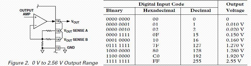

        While, about the AD557 TEST, those are the results:
        Test 2a:
        Remove the SCL or make connections to AD alone.
        Join your logic analyzer to the AD557.
        All inputs PIN1 - pin8 connect to GND.
        At PIN16 should be around 0V.
        here:0.70v
        Test 2b:
        All inputs PIN1 - PIN7 connect to GND.
        Pin8 connect the 5V.
        On PIN16 should be around 1.25 V. (50% Vmax)
        here:4.18v; if I remove the transitor Q1: 4.23v
        I think that the DAC is damaged, what do you think?

              Test2b is bad. You can not cut corners. Apply your well-connected to the analyzer Ad557.
              Measurement of the PIN14 & PIN15 & PIN16 connected together.
              Test3a:
              All inputs PIN1 - PIN8 connect to GND.
              Test3b:
              Inputs PIN2 - PIN8 connect to GND.
              Pin1 connect the 5V.
              Test3c:
              Inputs PIN3 - PIN8 connect to GND.
              PIN1 - PIN2 connect the 5V.
              Test3d:
              Inputs PIN4 - PIN8 connect to GND.
              PIN1 - PIN3 connect the 5V.
              Test3e:
              Inputs PIN5 - PIN8 connect to GND.
              PIN1 - PIN4 connect the 5V.
              Test3f:
              Inputs PIN6 - PIN8 connect to GND.
              PIN1 - PIN5 connect the 5V.
              Test3g:
              Inputs PIN7 - PIN8 connect to GND.
              PIN1 - PIN6 connect the 5V.
              Test3h:
              Inputs PIN8 connect to GND.
              PIN1 - PIN7 connect the 5V.
              Test3i:
              PIN1 - PIN8 connect the 5V.
              Test3j:
              PIN1 connect the 5V.
              Other Inputs connect to GND.
              Test3k:
              Test3l:
              Test3m:
              Test3n:
              Test3o:
              Test3p:
              Test3r:
              Good connection to the analyzer, ad557, GND and Vss ensure the stability of the test.
              Best regards Chris.

                    Hi Chris,
                    I've removed the AD557 from the pcb and placed it on a breadboad for the test....
                    Those are the results for me:
                    Best regards, Dam.
                      Hi Damiafix.
                      Almost perfect results.
                      As a laboratory of Analog Devices!
                      SCL and AD557 are OK!
                      Now search for defects in the soldering on the PCB.
                      The next test for the moment.
                      Best regards, Chris.

                          Hi Damiafix.
                          Out of curiosity.
                          Test7:
                          Measure the resistance between the AD557 PIN14 - PIN13.
                          Measure the resistance between the PCB blank PIN14 - PIN13.
                          Best regards Chris.
                            Hi Chris,
                            many thanks, I'll ceck again the pcb!
                            All the best, Dam.
                              Hi Chris,
                              H
                              Test7:
                              1.62 KΩ
                              18 MΩ (from the dac socket without the IC)
