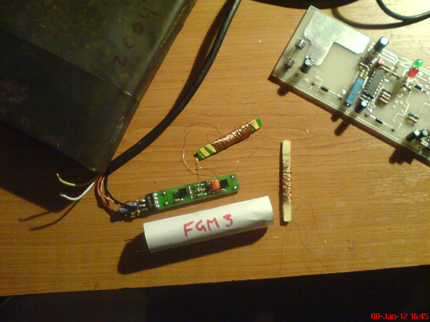

FGM 3 sensor
    With the new coil ,
    and the second inductancethe and on the same material I rolled up -I got three times better sensitivity !!!
      I thought the difference between the original fgm3 -and reconstructed !!!
        Whether they increase or decrease in frequency from the from the vitrovac ,FGM sensor 3 can achieve better sensitivity?

            Have pictures of different coil.? winding shape is not obvious.
              Hi Teknoloji.
              Typical carcass with a 3 mm, length 25 mm lens, 2000 turns.
              Best regards Chris.
                fgm3 original sensor resin removed - and vitrovac !!

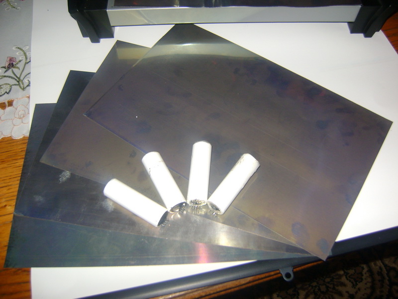

                          I would ask if you want to do one photo, but only one plate vitrovac, and leave here in the forum
                            vitrovac and 4 sensors on the picture of the tables as you know !!!!
                            And the second picture is my sensor is made but not with this material who supplies what is your picture on the left and the material in the left image but not at all vitrovac mumetal, and on my sensor as used by the kernel real vitrovac !!!
                            Left picture you sent me privately it is these miki ,I wrote a in terms of what people do, and I appropriated your picture as my !!!
                            and I will ask to look real vitrovac vitroperm or, if you care about that!
