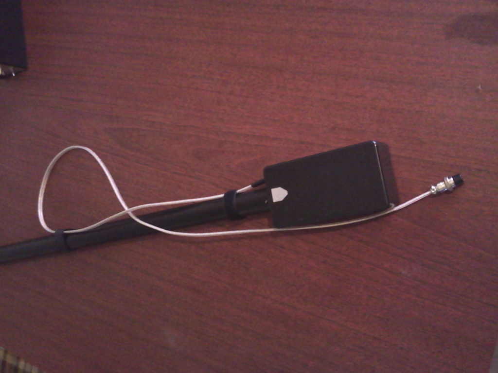

FGM 3 sensor
  • #46
    Super Sensor System ,,adjustment
    sensor 10yt to 200yt
    • #47
      I threw out FGM approach ,After much experimentation I was not satisfied ,how to change position compared to the constant magnetic field by changing frequency fgm 3 sensors and leads to inaccurate readings I am also disappointed in the FLC 100 ,He is frequently stable But with him I was unhappy with sensitivity ,,It caused me to change my approach all this and make your own design sensors that is super stable and the ability to be changed sensitivity necessary !
