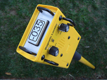

    HELLO, FRIENDS I HAVE
    Magnetic Locator DML2000-XRM. IT IS WORKING ON NONFERROUS METAL TARGETS. HOW IT WORKING? I DON'T KNOW! PLEASE EXPLAIN IF ANY ONE KNOWS.

        Not familiar with this model but I have owned 2 similar models. They are made for pipe location, etc..
        I have never seen one work on nonferrous metals.
        I have used them for treasure hunting and have found larger items with magnets in them. They are not sensitive enough in my opinion for the serious treasure hunter.
        just my opinion.
          Hello , work with metal iron ONLY it is a fluxgate magnetometer , very good for his price i have one that i buy 5 years ago ...if you need a simple but efficacy magnetometer this is the one .

              Hello Ricdel,
              A 5 gallons recipient to 2meters , a gas barrel to 3 meters , a big petrol pipe to 4 meters easy signal at this depth...I do not have images scan because this magnetometer is digital reading and audio .Like i said it is a good flux magnetometer , good electronic components and for the sensors very special ferrite , think for military equipment submarine...i say that because i have trying to reproduce the sensors without success because of that ferrite
                Syed, By itself it will only detect magnetic materials. The most common of these will be ferrous metals (incl. Co & Ni). But many minerals are also magnetic, like magnetite and a variety of hematite. Others are weakly magnetic and bodies of these may be detected if they are large enough. If you want a general metal detector, you need to stimulate electric currents in the metals, which will then generate magnetic fields that your device will detect.
