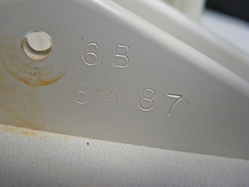

              Look at the outside left ear of your search coil
              (where the bolt goes through it). You'll see a winding
              designation stamped into it, i.e. 6B, D5, G, 8B, etc.
              D4 and D5 coils were used on the 6000/D and 6/DB
              detectors ONLY! They cannot be used on any other units.
              The D4/D5 coils were available in 8" and 15" only.
              B4 and B5 coils were used on the 4/DB and 5000/D
              detectors only! They cannot be used on any other units.
              The B4/B5 coils were available in 8" and 15" only.
              6B coils were in use since the "series 2" thru
              "series 3", Pro units, the Classics, and at present on
              the Classic I SL and II SL. 6B coils were available in 4",
              8", 10", and 15".
              F coil was made only in a BM256 (Blue Max 10"). This loop
              is totally interchangeable with all 6B coils above. It was
              manufactured to give performance to units which use the 6B
              coil similar to the BM950 coil is use today.
              G, HI, 8B coils are known as the (Blue Max) BM350, BM600, BM5.3,
              BM800, BM7.8, Royal 800, BM950, BM1500. These coils are
              interchangeable. THESE COILS ARE NOT MADE TO BE USED ON UNITS
              WHICH NORMALLY TAKE THE 6B DESIGN! TRYING TO USE THESE COILS
              IN PLACE OF THE 6B COILS WILL HAVE VARYING RESULTS. Some units
              may or may not ground balance properly (even if re-adjusted),
              but disc settings will be off and target ID's will not be accurate!

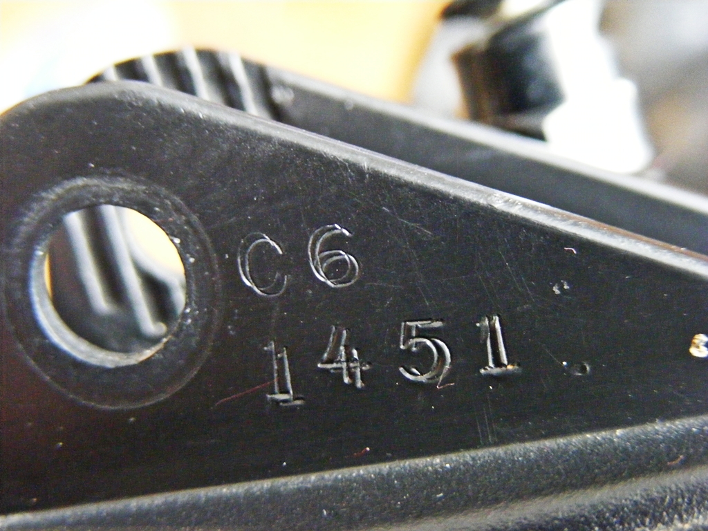

                    • Hi again guys.

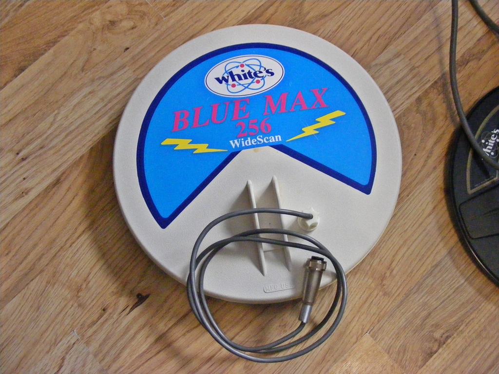

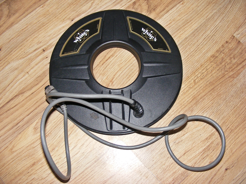

                      i have been kindly given two whites coils from a person how had them laying about for some years. they couldn't remember what machine they came off. i tried them on my whites classic 11 and they seem to work. what model is the black coil? does anyone know if these two coil are full compatible with my machine. do they ground balance ok etc. there is some numbers etc on the coil lugs if that helps.
                      thanks in advance guys.......

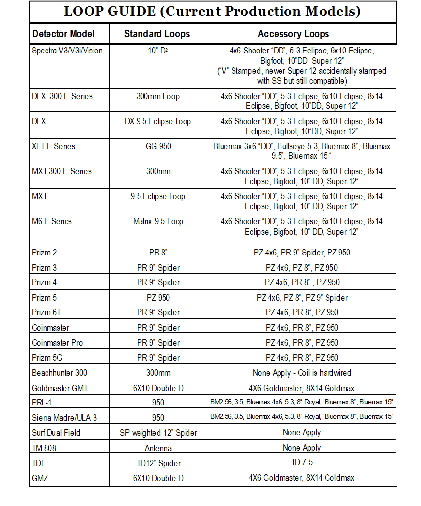

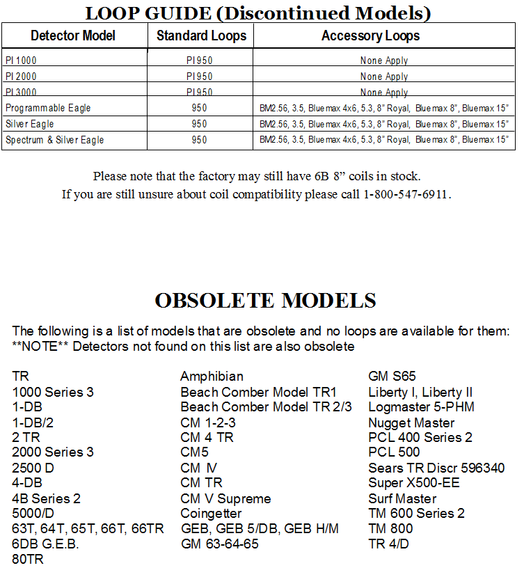

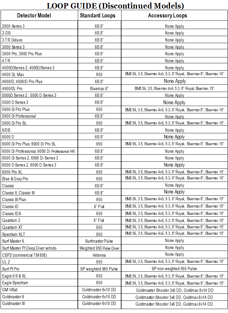

                      • Here is a list you can keep handy for quick reference
                        • read this http://forums.whiteselectronics.com/...-Classic-II-SL
                          • Keith the black coil is a 950. Both that and the 256(DD) should work on your modified C-II. Perhaps with the beach mod the narrow field of the 256 would work on the beach with a slow sweep? (possibly going along the sand ripples).
                            You are quite lucky to be given these coils. I have been scouring ebay for years trying to get similar coils at reasonable prices. All, even at auction, have run up to over AUD$200 once postage to Oz is included. That is why I now intend to make my own, even if it takes 10 tries it will be cheaper. I bought an IDXpro with Mr. Bill mods, BM6x4, no lower shaft- cheaper than I can get a second-hand 256, 8 or 950"coil for...go figure??
