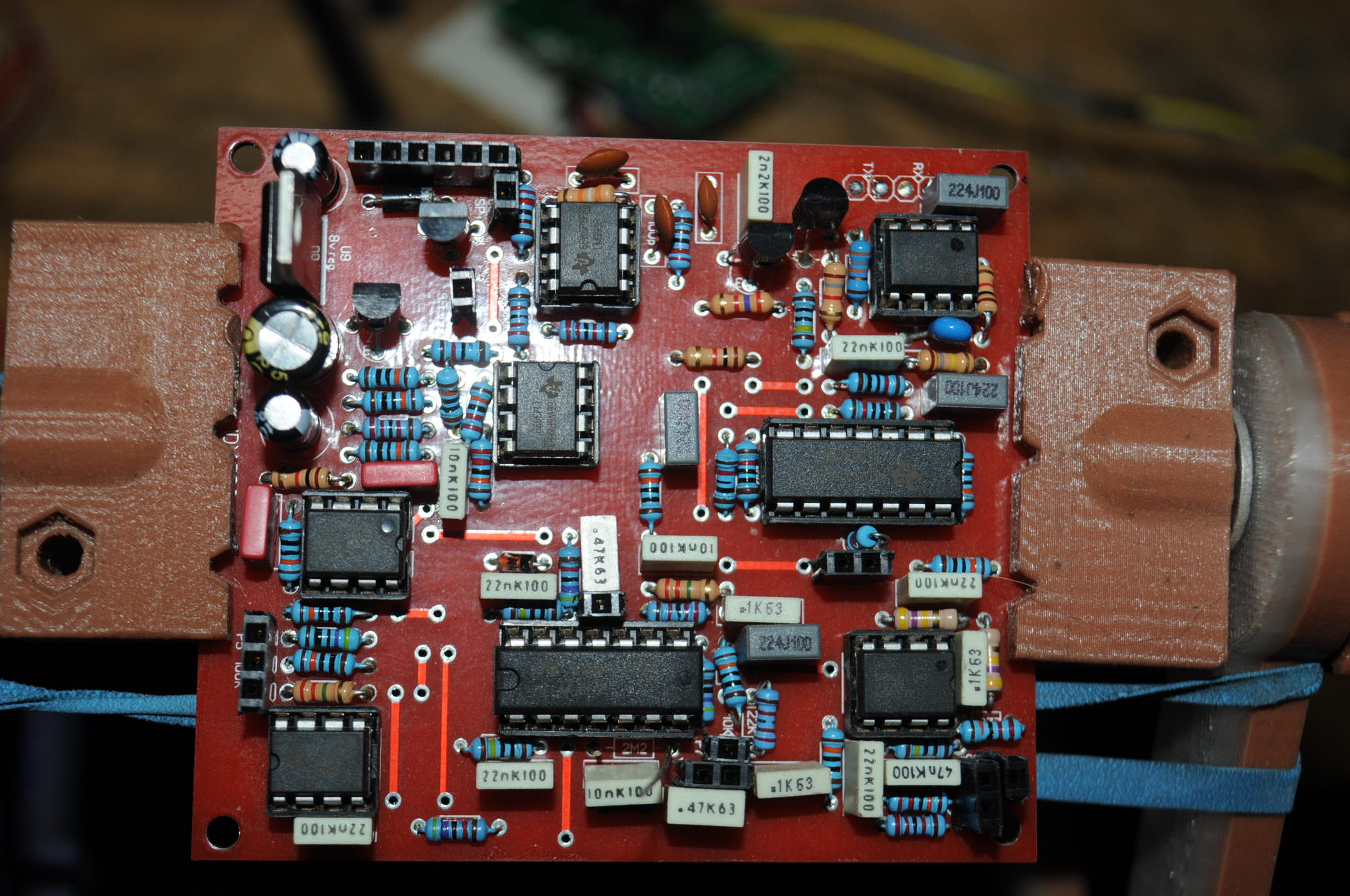

  • Does anyone know if the red IDX pro board sold by silverdog is already fitted with this mod?
    • Originally posted by Tibuck19 View Post
      I have tried the 6B on the silverdogs board
      You run out of adjustment on the ground balance. I added a resistor in series.
      But if you jumper R46 and change VR1 to 50K and it looks like it will work with both types of coil.
      The adjustment will be more course but you could gain the adjustments sensitivity back by using a multi turn POT if it will fit into your housing

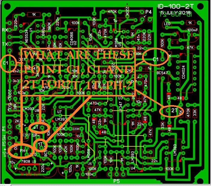

            • What are points highlighted in the picture? Anyone who has built this requested to share performance and use experience

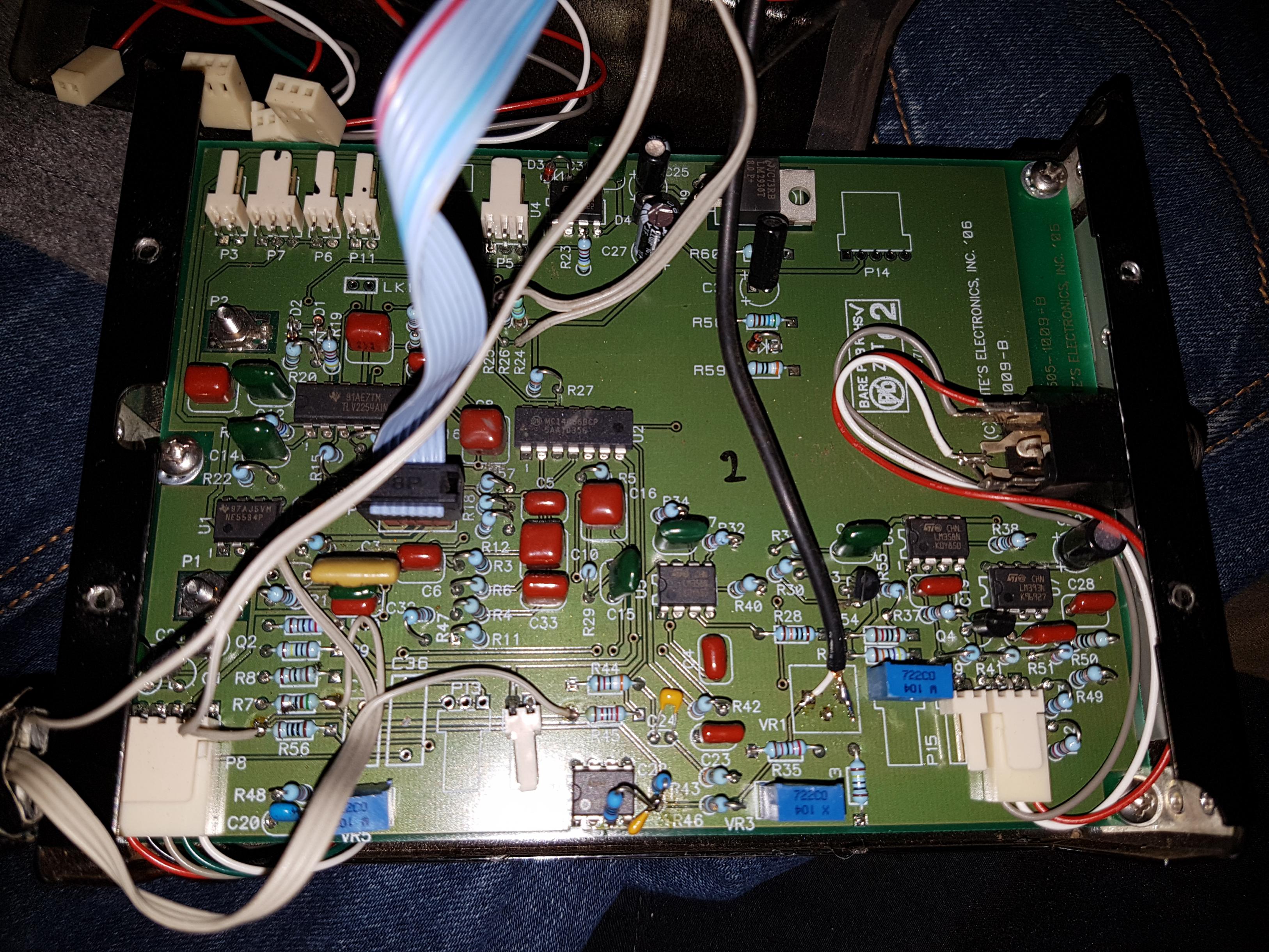

                • Originally posted by Koala View Post
                  can you tell me which is VR1 (the Ground balance is P1 on this board might be the Vr1?? ) and R46 please look at the photo of my board. Click image for larger version
                            I did as you suggested, Jumper R46 Changed VR1 to a 50K multi turn pot and i can confirm both my 6B bargain coils ( Bluemax 256 and a 6b 8 inch) work with plenty of adjustments left on the Pot. Granted, it was just outside on frozen ground and in snow but no unwanted beeping while swinging. I think I'm going to really like that small 8inch! Thanks for the advice.
