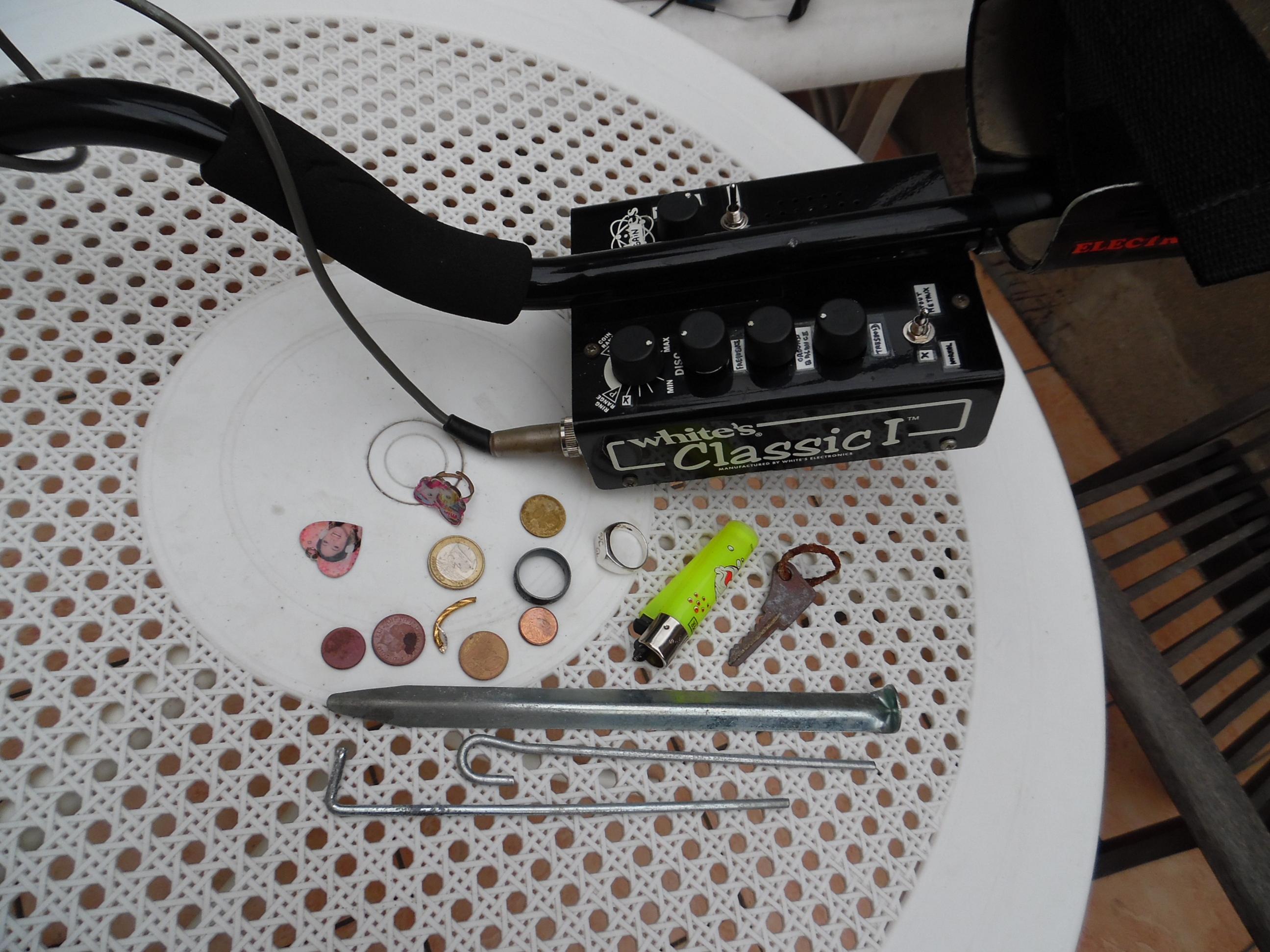

                              • Hello.
                                this is my classic 1 modified classic 3.
                                Thank you to members of geotech.
                                This is exellent wet sand.
                                My first out this morning
                                Fred to Calais ,France
