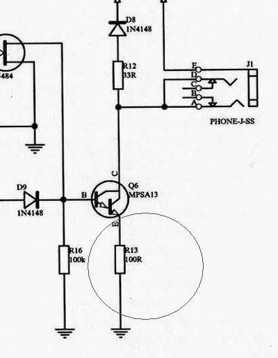

    hi all can the audio ic on the barracuda be piggy backed to increase output?
    thanks ally x
    Hi sinclairuser
    There are several points:
    -Will improve the sound a little bit at the expense of battery consumption and this is important.
    -Will improve the sound a bit and not the depth of detection.
    - of the electronic circuits audio ic some influence which is not desirable in the metal detector circuits - but if they were completely separate and isolated sufficient distance inside the box.
    -Out of electronic circuits for some influence moment the highest sound pull in, which makes the device is unstable and this is important.Or customize another battery to feed audio ic.
    *Observing all designs, whether amateur or professional away from this idea of these reasons - and depends on one or two TR.*
    I hope I explained the points.

              Why complicating and making more troubles to yourself!!?
              No need for any extra amplification.
              Just mod R13 resistor and put lower value!
              It is now 100ohms and can be lowered down to 4,7ohms or even lower.
              Depends on your speaker resistance.
              Would be good if you can obtain 16 or 32 ohms speaker.
              I am using ordinary 8ohms speaker and R13 is 5,1 ohms in my Barra.
              It is loud more than enough.
              Or... even better (more safe for transistor) solution is to lower R13 to 2,2 ohms (or just omit and short it) and use piezo speaker instead ordinary one.
              Try to find large piezo and it will burn you ears!
              Cheers!

                i will adjust that resistor now to get the best sound for my setup as it is now the sound is good just low
                i know about the oversaturation now as well after reading on the net so i will try ivconics advice and keep it simple

                  Far as the Barracuda Its worth keeping in mind that the MPSA13 was supperseeded with the MPSA14 which is higher gain and has a better over all S/N ratio same pinout, so anyone who wants a bit more bumf will proberly gain by upgrading to it, or at least worth the try, so thats another option.

                            Come on guys...Look at this as a simple audio amplifier, put a 10uF cap across the 100R emitter resistor (it's called a bypass capacitor)..Should give the result you're looking for (unless I'm teaching you to suck eggs in which case, just tell me to get lost) .
                            Also, if the audio supply is connected to the cathode of D8 then WHAT is D8 doing? Nothing that I can see, unless it's the wrong way around??

                              not at all mate that is the simple kind of idea that gets too easily forgoten when your too close to a problem as for teaching me to suck eggs thats cool we forget most of what we learn so i have no problem taking on fresh knowledge from people who know better! the diode does look wrong though
