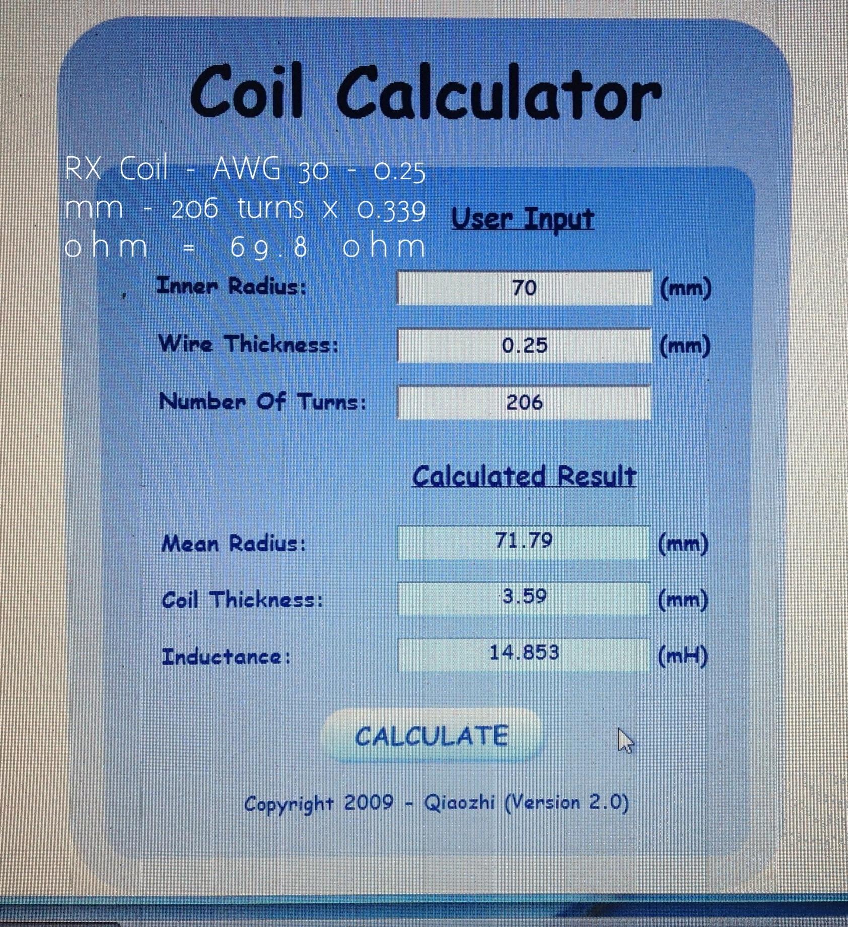

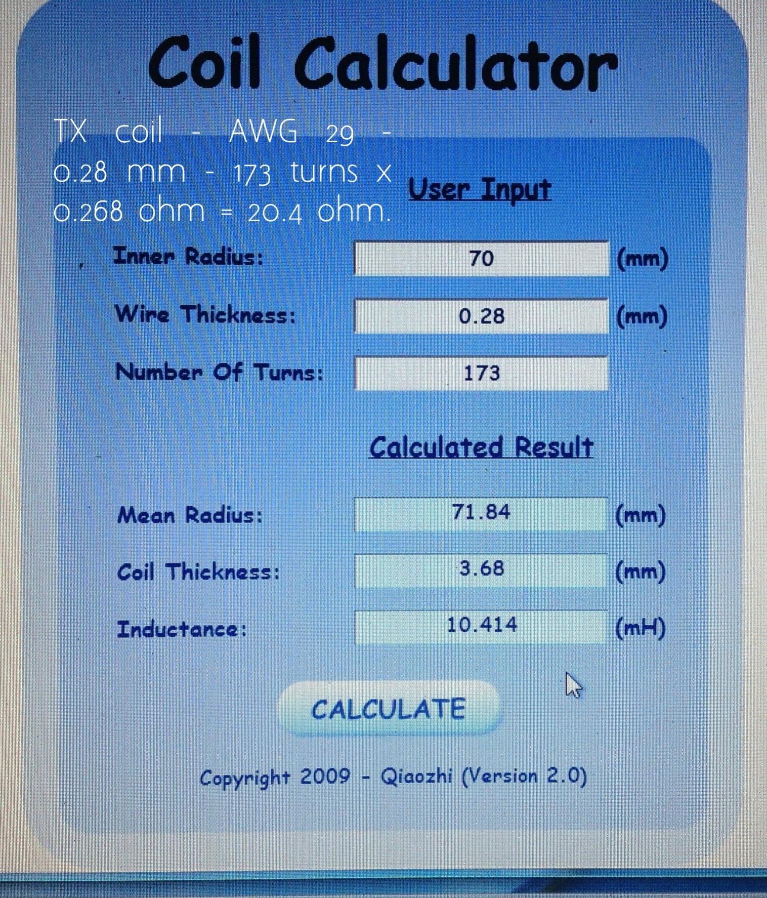

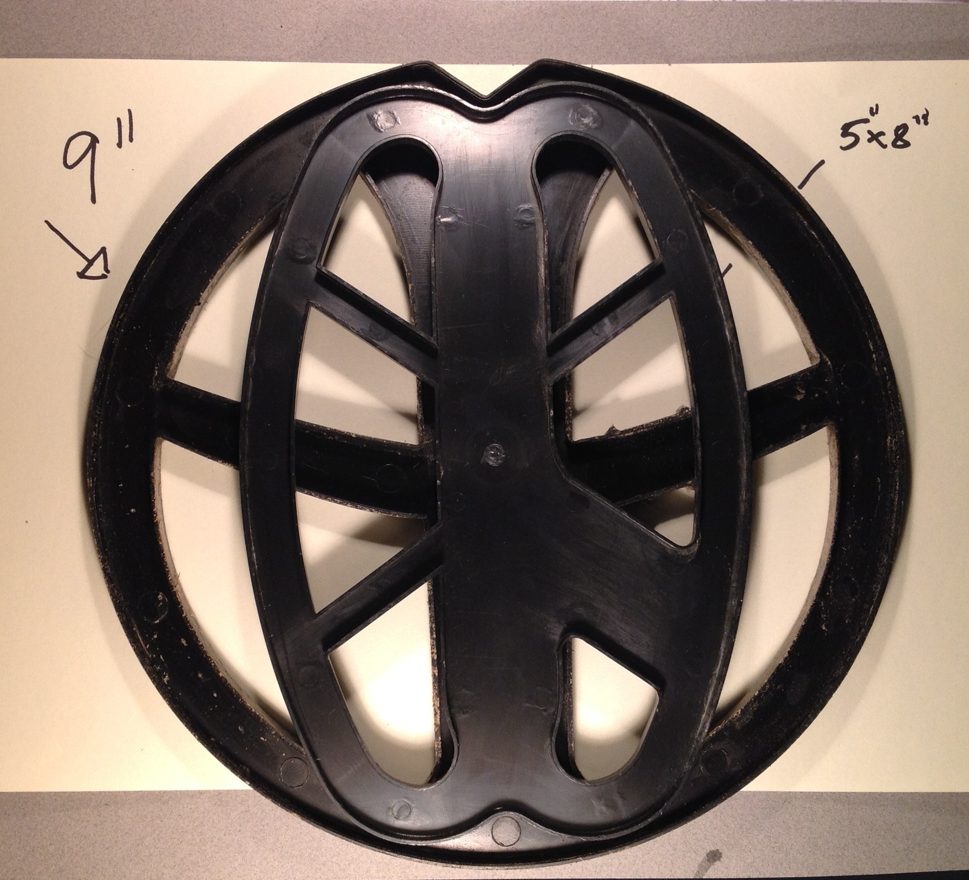

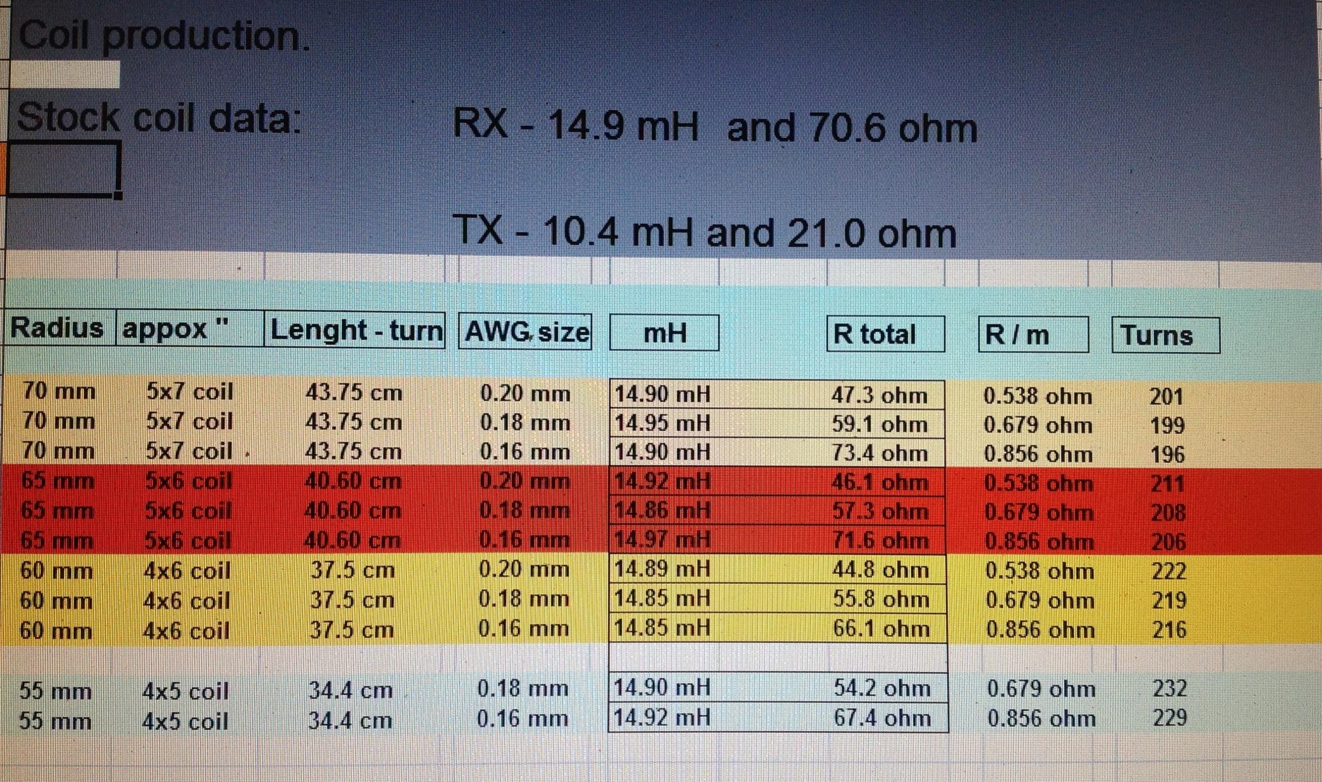

                      Hello again.
                      I was out with my 11x13" at the test bed outside... Tape to hold the Battery and the board a little lose, but It just worked nicely..
                      Next thing to do; Coil production.
                      I am ready to ordre the AWG wire... Got AWG 30- 0.25 mm at Stock, but not AWG 29 or similar.
                      Can I ask you to look at my pictures... ! The coil cover picture is to show you the different between the 9" Stock coil, compaired with a smaller 5"x 8" DD coil.
                      I was wonder.. Is the difference between the two coils to small and then the advance or idea will end up to little ?
                      Still to Remember why this project is started. I got many places (coins and relic hunting), which is so Heavy iron infested that even in the fast Deus program or with higher reaction, ist very difficult.
                      Some of you would properly say smaller coil ! maybee like 4"x 6" - but dont you think the coil will end up to thick ?
                      I made a test... 4"x 6" and to make the RX at 14.9 mH = AWG 28 (0.32mm) I would need 235 turns and end up with 19ohm (Coil thickness 4.9mm)
                      I think it would Be a good idea to sleep and think this over a Night or two.
                      All comment is Very Welcome.
                      Henrik.
                      • #56
                        You need to reduce the toe-to-heel length, so it looks at less ground and hence less targets at the same time. 5 x 4, or 6 x 4 is what's needed. As a follow-on project, once you have a perfect small coil made,[yes, we have high expectations] you may be able to increase the front-end amplifier gain, maybe by a factor of 2 or 3, to bring up the sensitivity.
                        A 5mm diameter wire bundle is not a problem, I think commercial small coils all have thicker windings, it's just inevitable, to keep L the same as the larger coils. You may be able to compromise slightly on the receive coil, and allow resistance to go up to 100R (ie. thinner wire) , though I would try and keep it lower than before, like 50R, as it is a noise source.
                        I would suggest building the coil up in a 6 inch circular housing, not a 'spider' type. This will hold a 5 x 4 butterfly coil arangement, with room for tuning bits and pieces, nulling loops wherever you want to put them etc.
                        • #57
                          thats good advice from skippy - the ellipse will pick up targets IRON under its long footprint, a small round one will give a neat focused footprint - to reduce chance of mutiple pickup.
                          Some Thames mudlarkers use a 3" Steve
                          • #58
                            Thanks...
                            I will follow your ideas.
                            I found out that If its posible to find a coil cover with the right size, its more easy to build a search coil. You know to keep it stable in all the finetune process, that could Be a little hard to find so small .. 4x5 or 4x6..
                            I found a CTX 6" DD coil cover (see picture) with a lot of extra space (a 5.5 x 5" coil could properly the result with this, using the iner diameter, if the Winding isn't to thick.) That CTX 6" coil cover will Be ordered.
                            I was thinking... ! The finish coil will end up thick/high at the place where the RX and the TX are crossing. A Dream is to learn to
                            merge the RXs and TXs Winding.. Like start with one turn RX, then one turn TX.. I saw this at a Stock coil.
                            The turns 170 and 200 is Very similar, it just to count, and Once in a while turn 1:2 so both end in the same time.
                            Next is to ordre the AWG and a 6" CTX coilcover.
                            Henrik.
                            • #59
                              How can you order the wire when you (we) have not designed the coil and worked out what size wire is needed? There's no rush to buy the wire, plus you've got to make a winding jig for it, too. Decide what physical shape you want your coils to be, then we'll go through the design process.
                              • #60
                                Your right Skippy.. I / we Need a little more thinking.
                                I had allso made a mistake yesterday... (One turn is not the same like one meter !!! )
                                Look at the new picture and you can see what I did wrong yesterday and you will allso see that we / I need Very thin AWG.
                                Henrik.
