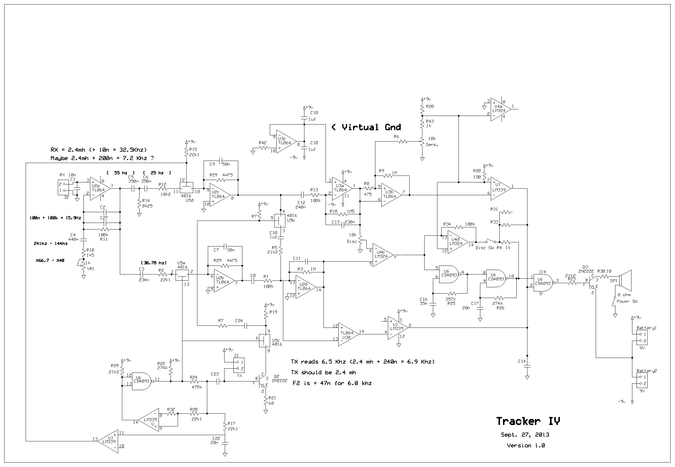

    I drew up part of the Tracker IV schematic a while ago (the rest was difficult unless you remove
    all the components). The resistors were verified by reading the values but caps were measured
    in circuit so may be wrong values on schematic.
    The circuit looks a bit different than most here and some tricky things are done when switching
    modes. (Removing grounds from chips and such).
    Mine only goes 2 - 2.5" (50 - 65mm) deep so I was looking for some improvements to gain a bit
    more depth. The RX seems to be tuned to 32.5 khz where the TX is 6.5 khz seems a bit funny
    maybe tuned to a harmonic?
    I thought I might try winding a new coil and maybe messing with the TX (though that's tough
    without the complete schematic. Maybe just tuning the RX cap would gain something? I tweaked
    the VR1 pot and gained 1/2" or so but it probably messed up the disc.
    I'm going to test some baseline targets today then try winding some coils to see what I can do.Click image for larger version

    thank you for info Silver Dollar. did you draw schematic from SMD board? Tracker IV is nice two tone detector with smooth clear discrimination.
      Yes SMT pcb that's why it is hard to find all traces.
      If I had a bad one I could remove all parts and do a better job tracing.
      I tested my gold wedding band (21 ct gold) at 5 - 6" in air.
      It's hard to keep the target straight until the measuring stick.
      I tried adding and subtracting 0.5, 1, 2, 3, 10 nf to C1 but didn't see any amazing increases in range.
      A better testing setup will be needed to tell small gains. Adding 2nf seemed to make a stronger
      signal but was still around 6".
      The TX measures 6.67 khz and around 20V P to P so I don't think you can gain much there.
      RX measures 2.46 mh
      TX measures 2.68 mh
      I still wonder why the RX is tuned with a 10nf cap as that gives resonance at 32.5khz
      Maybe I'll try 200nf just for fun!

          For what it's worth, Designer Dave Johnson (First Texas Products) thinks the Tr4 is a great design, and he's not seen any need to try and 'improve' it. So your attempts may ruin, rather than enhance it.
          If you want a larger coil, just buy the correct one. The 10 inch Magnum should be available at a sensible price. Not sure it will work as well as it might on a Fisher F4, for example, but worth considering.
          Looks like you've been reading my posts, about the F2 frequency, judging by your notes on the circuit diagram. Ther's an error in your maths. 2.4mH & 240nF give a frequency of 6630Hz (should actually be 6.59KHz, I think)
            6,6 khz is whites frequency and any whites xlt, classics coil will work. 9'5 xlt rainbow coil is preferable.

                            The TK4 should air test in the 5 to 6 1/2 inch range on typical coin size targets. Almost anything you try to do to improve it will actually screw it up although casual air testing may not reveal the screwup.
                            The BH Junior and its various clones marketed in various venues, is a lot easier to screw around with if you're so inclined. But this is electronics and you still have to understand what the heck you're doing.
                            The basic problem with trying to modify a commercial metal detector to improve its performance, is that a real beeper engineer already did that before the product went into production. In some cases some sandbagging was done to tame the thing down, and if you know what you're doing you can take out the sandbagging and make the thing more radical. Of course if you succeed, then you get the problems that come with doing that.
                            --Dave J.
                              Thanks for your input Dave. I think I came to the same conclusion that there's not much you can do to improve it.
                              I actually bought it thinking I got a case, stem and coil for a good price and planned on making my own detector
                              to go inside but I learned a few things and thought why not try to improve it...
                              Now about the sandbagging...
