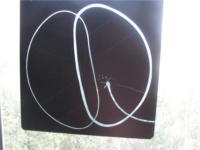

                1. what inductivity of YOUR coil?
                2. what resistance of YOUR coil?
                3. pics of YOUR coil under X-ray? (an example attached)
                  I have no idea what the significance of those questions is and have no idea of the answers. I have no technical knowledge in this area.
                  I have the standard coil that comes with the detector.
                    can you give a data of the standart coil that comes with the detector going to neigbour TVs set service, PCs service, mobile phones service, etc, any electronics services, near to you, asking those people to measure L and R?
                      http://www.findmall.com/read.php?26,...04#msg-2400104
