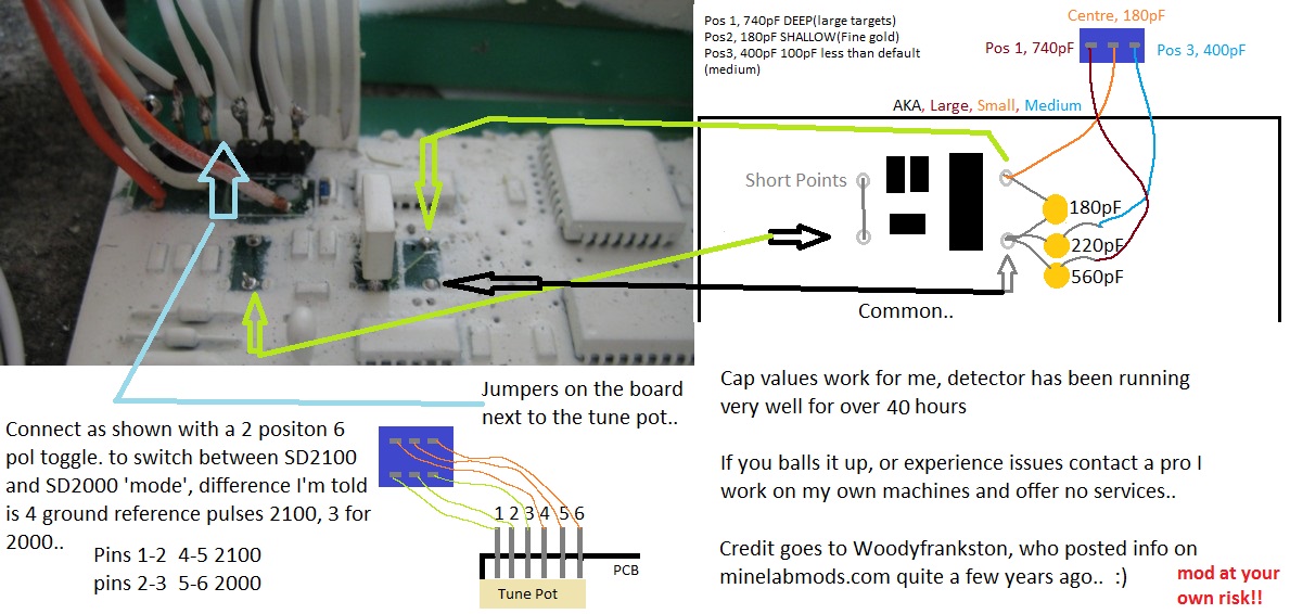

        Found some simple mods that improve sensitivity and depth
        Just remove 2 1nF caps, short one, replace the other with a 180 or 220pF cap for sensitivity, or connect 3 in parallel with a 3 position toggle, to switch in and out capacitance.
        img below
          switched out the 560 to a 5nF.. depth is better..
            Okay final setup, 180pF base, switch in, 330pF and 860pF.. gives best results on super fine, and at max depth..
              You can go further with the C values but you will run out of GB adjustment on Channel 2 , but you can change the scaling resistors to get extra range.
                Nah, think I'll stick with it as is.. performance is sweet... thought it gives a bit of a scream when switching back to 180pF...
                  It will do that when some of the coil ringing starts getting into the receiver, try extra damping.
                    Okay, cool. so how would i go about doing that?
                      Hook up a coil and change the value of the 390 0hm damper resistor or bank of resistors that = 390 ohms (depends on detector) observe coil ringing on a cro, observe the results, do not kill any target signals by squashing it down too much.
