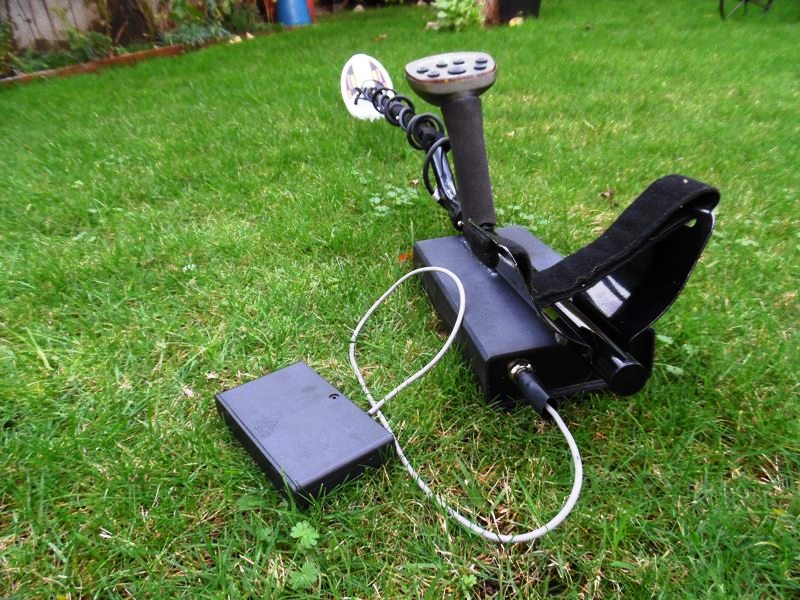

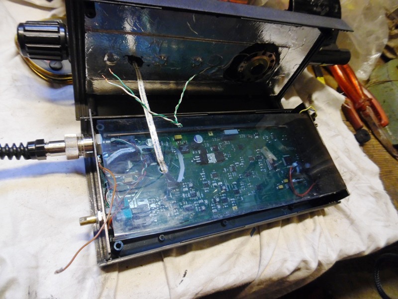

    HI

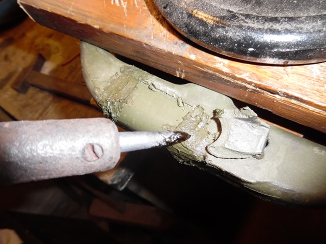

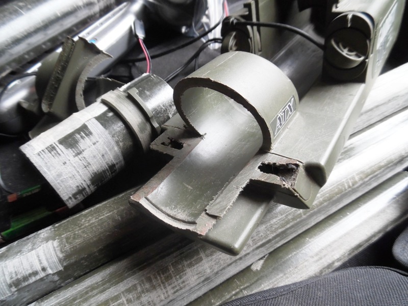

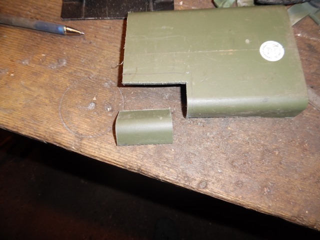

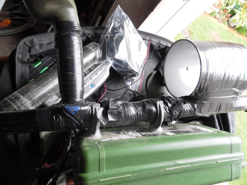

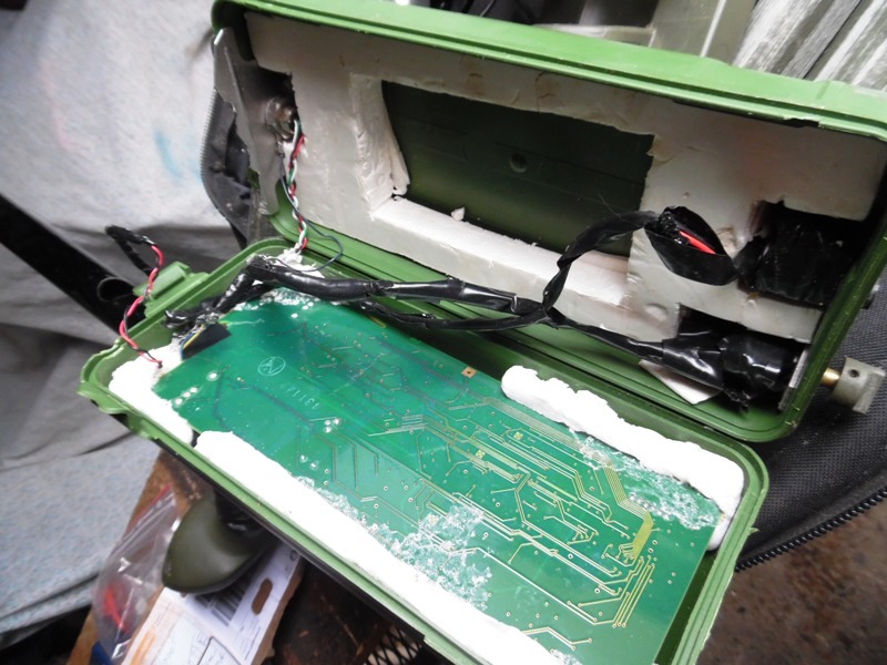

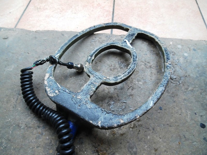

    This is my latest project.
    i buy a ATX in poor condition; it was cut to alleviate and break the coil.
    I buy a coil 5X10 infinium his works.
    I go up the pcb abs in a box, I graphiter inside the box and ride on an old white cane's.
    I am happy with the result, but I'm looking for an original coil atx but it is expensive in France.
    For information, I speak very little English, I use google ... traduitor

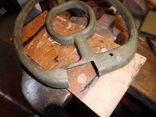

    the coil is hs ...

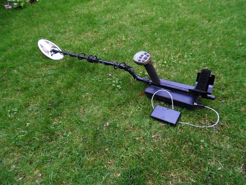

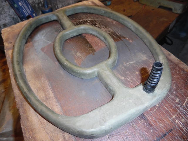

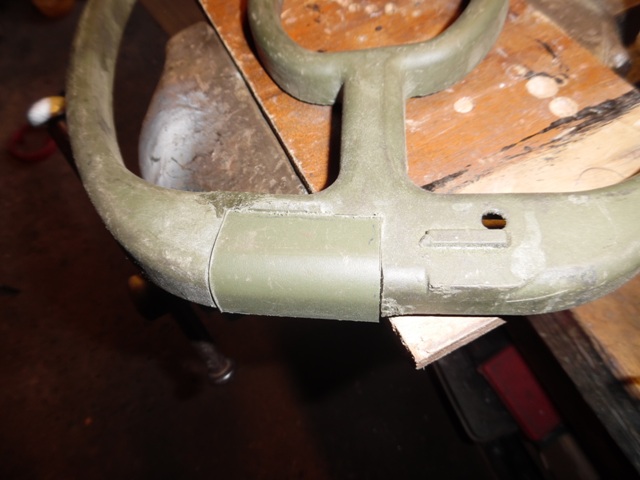

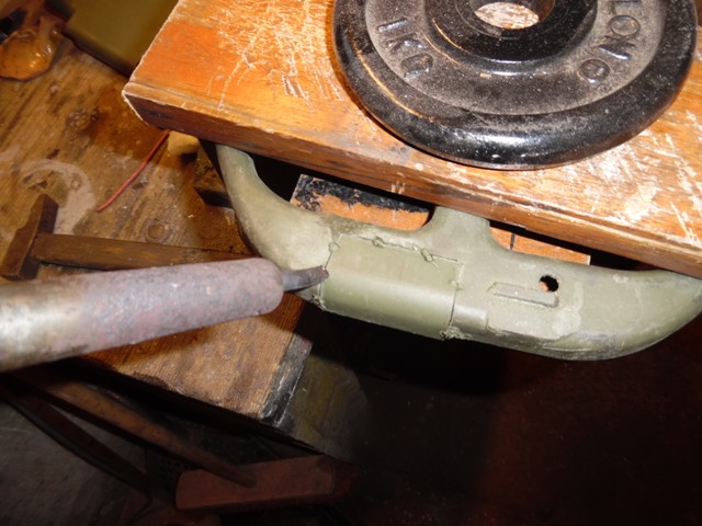

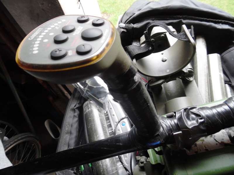

    And this is ma restoration ...it is very light but not waterproof.

    Nice job!

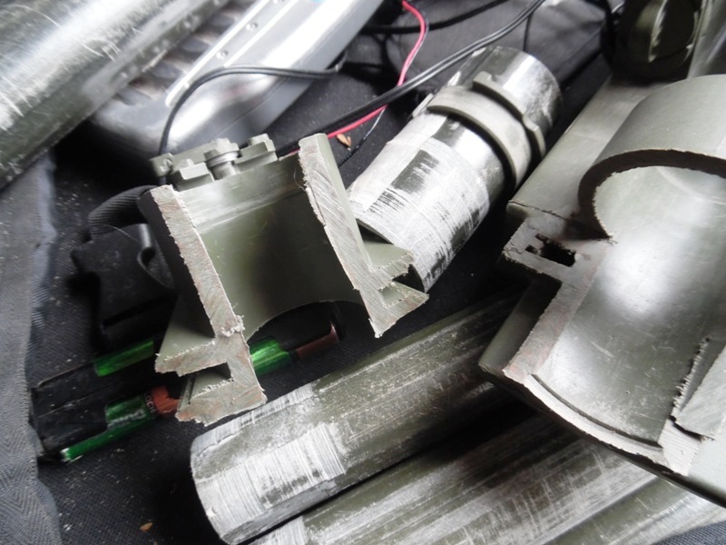

    Why was it in such a bad condition? Is it ex-military use?
      Thank Qiaozhi
      No, not used by the military. The previous owner was cut to make a light detector.
      But break everything .... and he walk the coil
        Hello friends

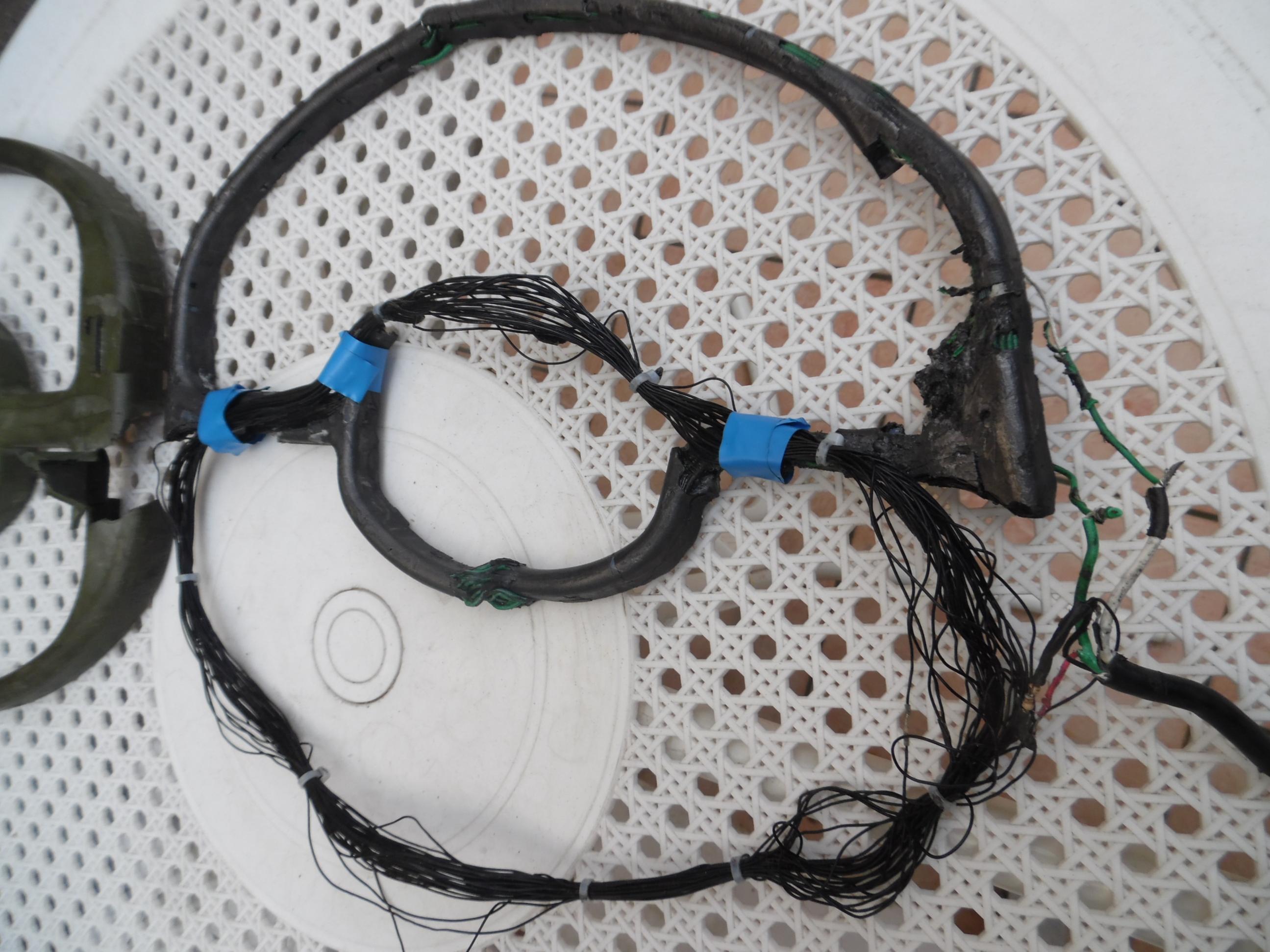

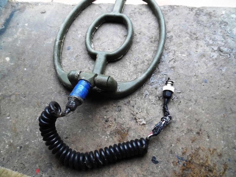

        Here is the coil that the previous owner broke
        I will try to repair the coil but i need advice for winding.
        have you schematic or advice?

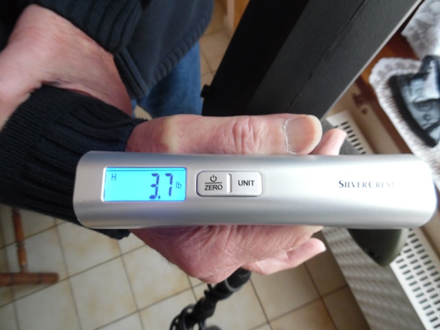

        the weight of the detector weighs

        very light atx

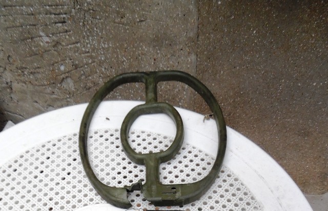

          Hello Tifred what did you do with the windings of the coil ? do you still have the wire ? can you remove the wire from the potting mix so we can learn how garrett made the coil ?
          do you have any more pictures of the coil ?
            HI 6666
            Yes I have the number of turns and type of wire, but there is resistance and I have no value, it is breaking.
            I have pictures but I do not know if I'm allowed to show, there surely has a garrett patent.
              Thanks for the picture it confirms some theory's about the coil construction .
                It was only obvious. I'm a bit surprised to see plain magnet wire, and no trace of tidiness. With proper initial geometry it must be very easy to balance.
                  hum,
                  so basically inside it's arranged like this then ????

                      I made some coils in that configuration and when they were balanced there was a lot of difference in over lap distances from original atx coil,
                      it only required a small amount of overlap to balance,
                      Bending the coils more to the atx shape I could not balance them with placing coils over each other like the atx design, I had to move them father apart to balance, without having an atx coil to test, my conclusion (right or wrong)
                      was the atx coil is not IB.
                        PI detectors with separate TX and RX coils do not need the coils to be induction balanced. There are two possibilities here that I can think of:
                        1) The sensitive area is within the centre circle, whereas a standard DD configuration would have a thin sensitive area from front-to-back.
                        2) It was designed to make the casual observer conclude that the coil is actually a concentric.
                          After watching a video , you may be right, the video showed detecting a small gold clasp that other coils could not detect.
                            I was also watching YouTube. Quite respectably distance on a .1 gram gold nugget. Pinpoints really well.
                              I believe the second...
