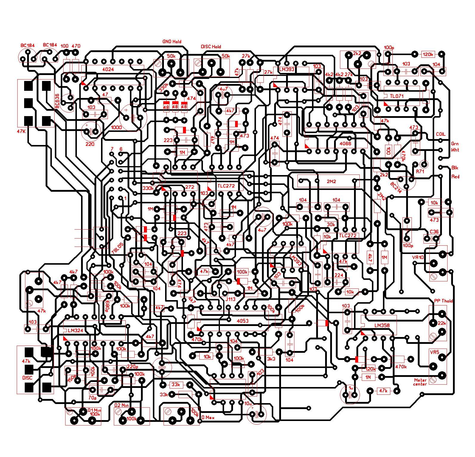

          Here i am attaching my redraw from the past, all the trimpots are commented.
          You may compare and see if there are similarities and matching.
          You may achieve minor tweaks by experimenting with some trimpots, but be sure to mark and remember previous positions, in case you don't like what you achieved.

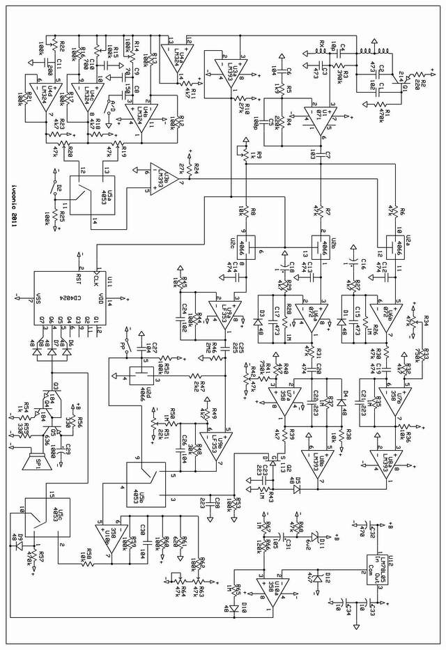

            Schematic attached.
