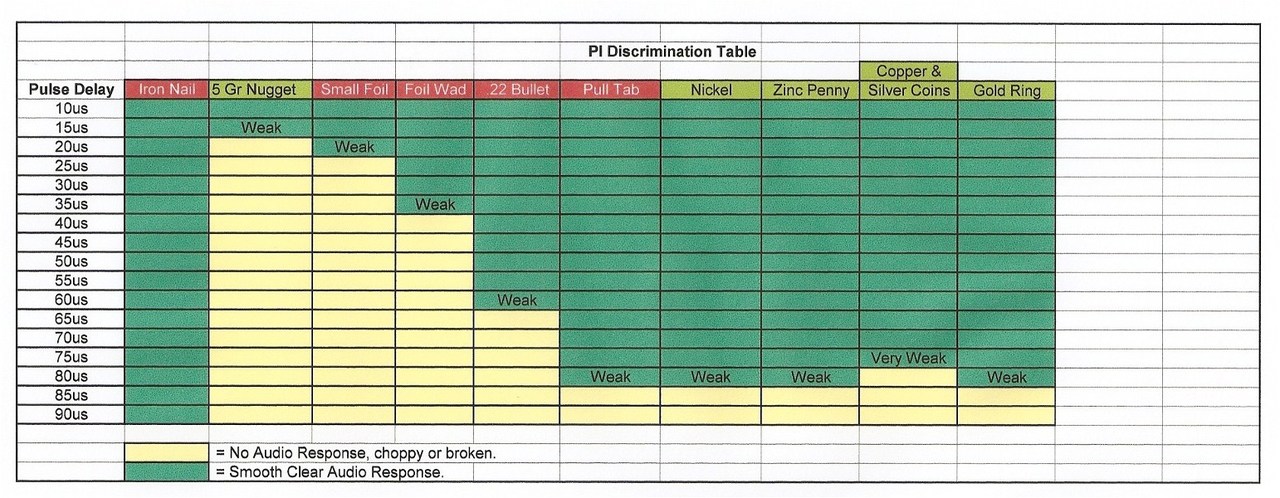

      Here is an example of the type of targets you eliminate as you increase the delay.
      Hello 6666,
      I have been test at my MD, if delay 20uS , my 1 gram gold ring, cannot detect,
      What kind gold ring at table list?

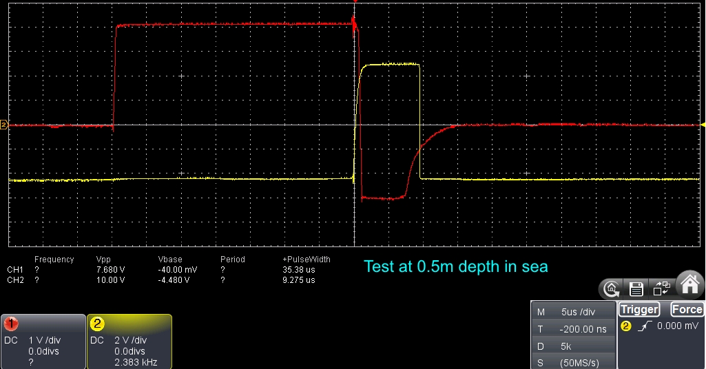

                Hi dime196604,
                Hmmm, I don't know the surfxx!? Maybe you can post a picture of the board.
                Just read more thoughrougly and see you have only one channel on oscilloscope. That's a bummer, but not the end of the world.
                I am posting a screenshot of surf PI signals of PIN6 5534 & PIN10 4093 so you can see the time/voltage adjustments you
                approximately need. The yellow one is the delay time.
                I would suggest probing the pins of the 4093 whilst adjusting the delay pot, you'll see the yellow part getting longer/shorter.
                This is of course assuming the surfxx is built in a similar fashion.
                Good Luck!

                  So if I am reading that correctly, your delay is at about 10us in the pic?
                        Yes.
