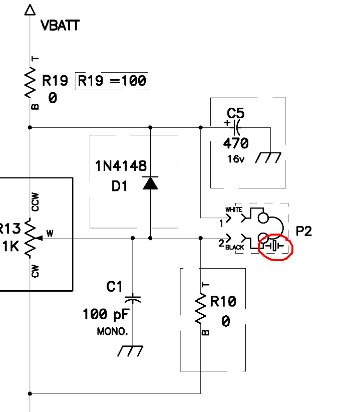

            I really want to come back to the speaker low/high impedance question... I don't really understand why a low impedance will alter the functionality of the detector...
            Q1 is for allowing to "activate" the speaker when metal is detected. Would it not be possible to change the voltage the P2 (headphones) are sourced, or to alter the resistor values? (Talking about this schematic)
            Adding D1, C5 would it alter the functionality of the Surf Pi Pro? Is only for protection/stabilization?
              again same question. underwater headset is PIEZOCERAMIC one, NOT you maybe guess thats ordinary type
              you wear now with pc. the piezo is some kinda A CAPACITOR, ceramic plate with metal layers on both sides, and HAS NOT 'Ohm' conductivity AT ALL.
              is it OK for you?

                        The impedance of the speaker would only change the volume, wouldn't it? Maybe when the resistance of the headphone is so small, it would destroy the audio switching transistor (or am i totaly wrong?)
                          where you see resistance of speaker if there is not resistance of speaker? HEY! STAND UP BUDDY!
                          either i am idiot or... why people with zero basic in electronics thinking here are the teachers of electronics?
                          if i am teacher so why you do not want to hear me?
                          this is ORIGINAL White's SURF PI schematic particle attached.

                              @kt315: I don't know what you want... YES i know, the symbol you marked is a piezo!
                              A piezo speaker has high impedance (high resistance), some headphones have low resistance. WHAT and WHY will low impedance headphones alter the function of the detector?
