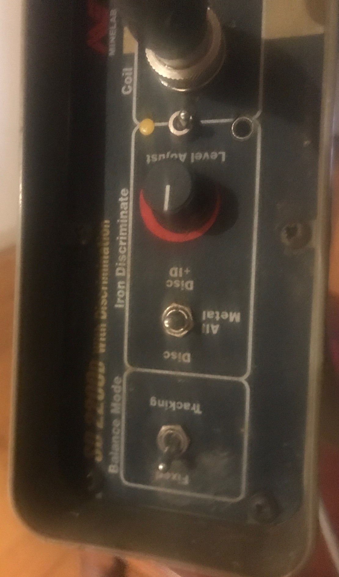

    I've just sourced SD2200D with some mods done, however can't identify who done these mods and what they are and how they work.

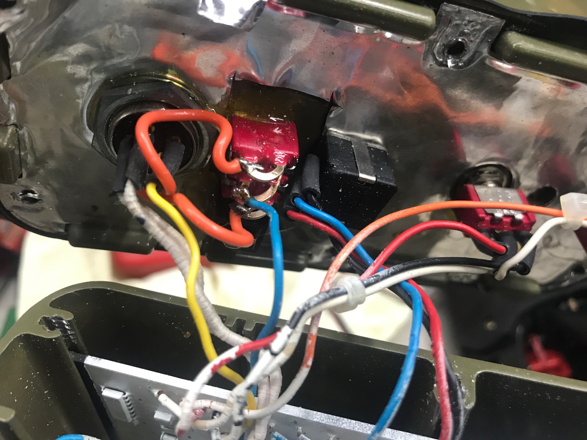

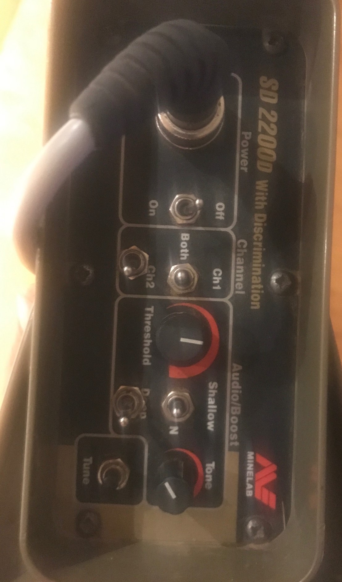

          yes the 3.5mm jack apparently is for connecting remote switch for ground balancing . The two switches at battery side are for changing frequency and timing(msd and m1 s m2) , just the little switch at the coil side panel I can't figured out yet . It is connected to the coil socket??
            If it is close to the coil plug it could be a DD/mono switch so you can use a DD coil as a mono.
            Cheers Mick
              Cheers Mick
              it could be, however when flick the switch decrease sensitivity dramatically( with DD coil), not sure how it works.
              The two orange wires are connected to the coil plug..
                Mono/dd switch.
                When you have a mono coil on, the switch will do nothing.
                When you have a DD coil on, in one position you will be receiving from the rx coil and the other position you receive from the tx coil.
                Discrimination won't work in mono mode. Sensitivity will be less in DD. More ground noise in mono, depending on where you detect.
                Cheers Mick
