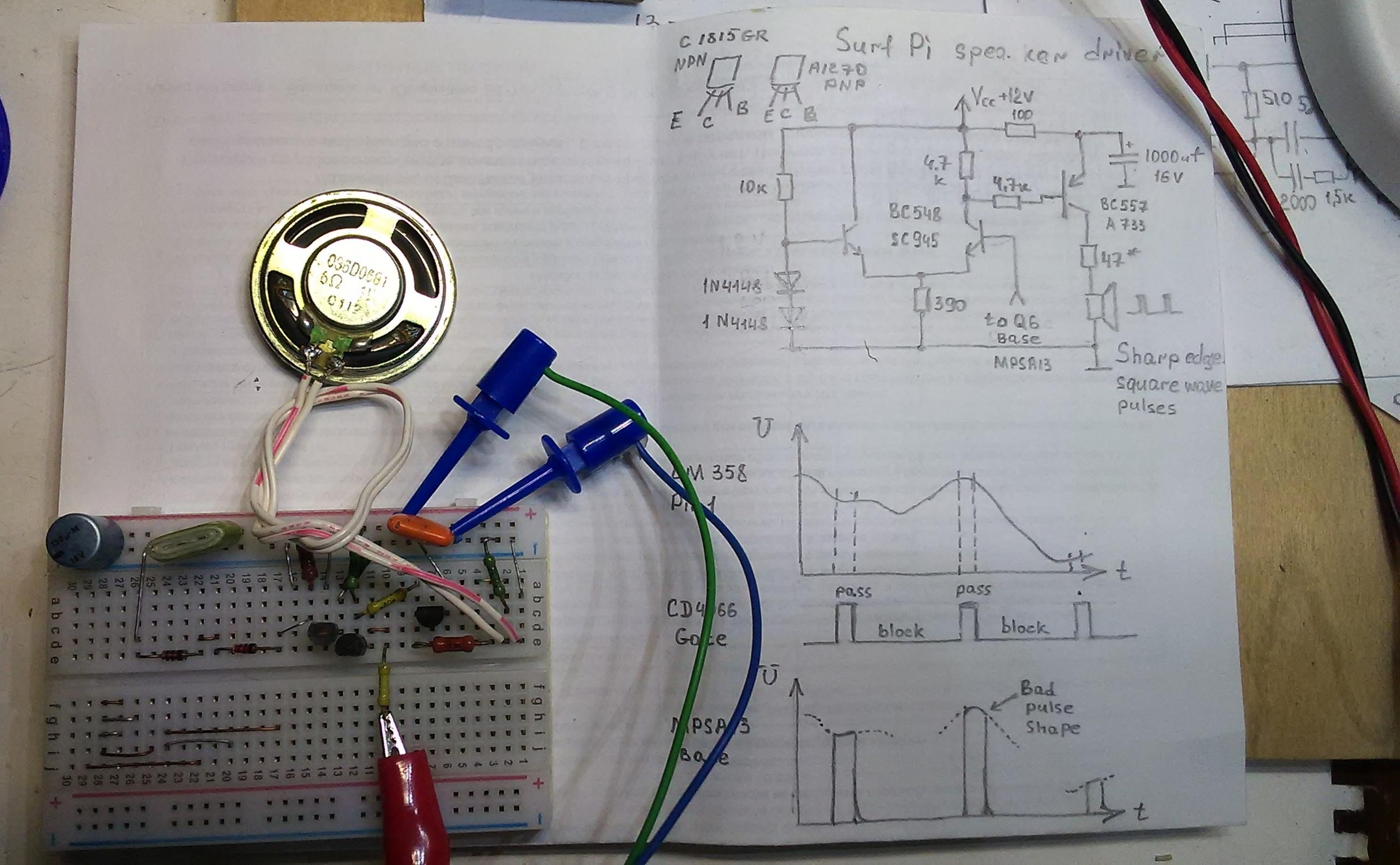

    Hi!
    This circuit based on comparator so it produces well sharp shaped pulses at the output and drive low impedance speakers. In this video i drive a cheap 6 Ohm speaker with aditional 47 Ohm resistance.
    circuit

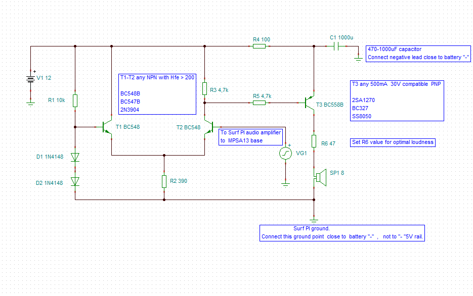

    nice, but the schematic is a bit confusing, c1815, a1270, bc548, bc557 and mpsa 13 are all mentioned but which did you use?.
    as for the mpsa13 i have found that mpsa14 is easier to find and has more gain, the mpsa13/14 is a good replacement for some darlington paired transistors too.
      Hi Sinclairuser!
      Yes, i redrawn circuit. I use two C1815 and a1270. I just have this transistors and last one is power related for load driving purpouse. Thanks for your knowledge, last time i combined two transistor to make a darlington pair and had better results than with mpsa13, for next time will look for msa14.
      Heres the circuit.
Name:	Surf PI efficient speaker driver_circuit.png

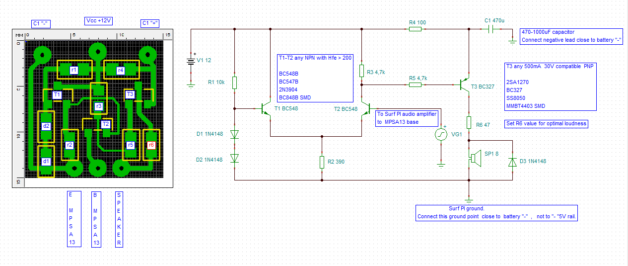

        Some minor corrections for circuit and SMD layout
Name:	Surf PI efficient speaker driver_circuit_v0.2.png
        Smd 15x15mm PCB
        SurfPI_speaker_driver_SMD_PCB.zip
          thanks vadim18 for clearing that up, nice simple mods like this can make all the difference sometimes.

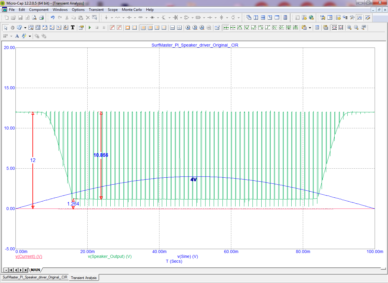

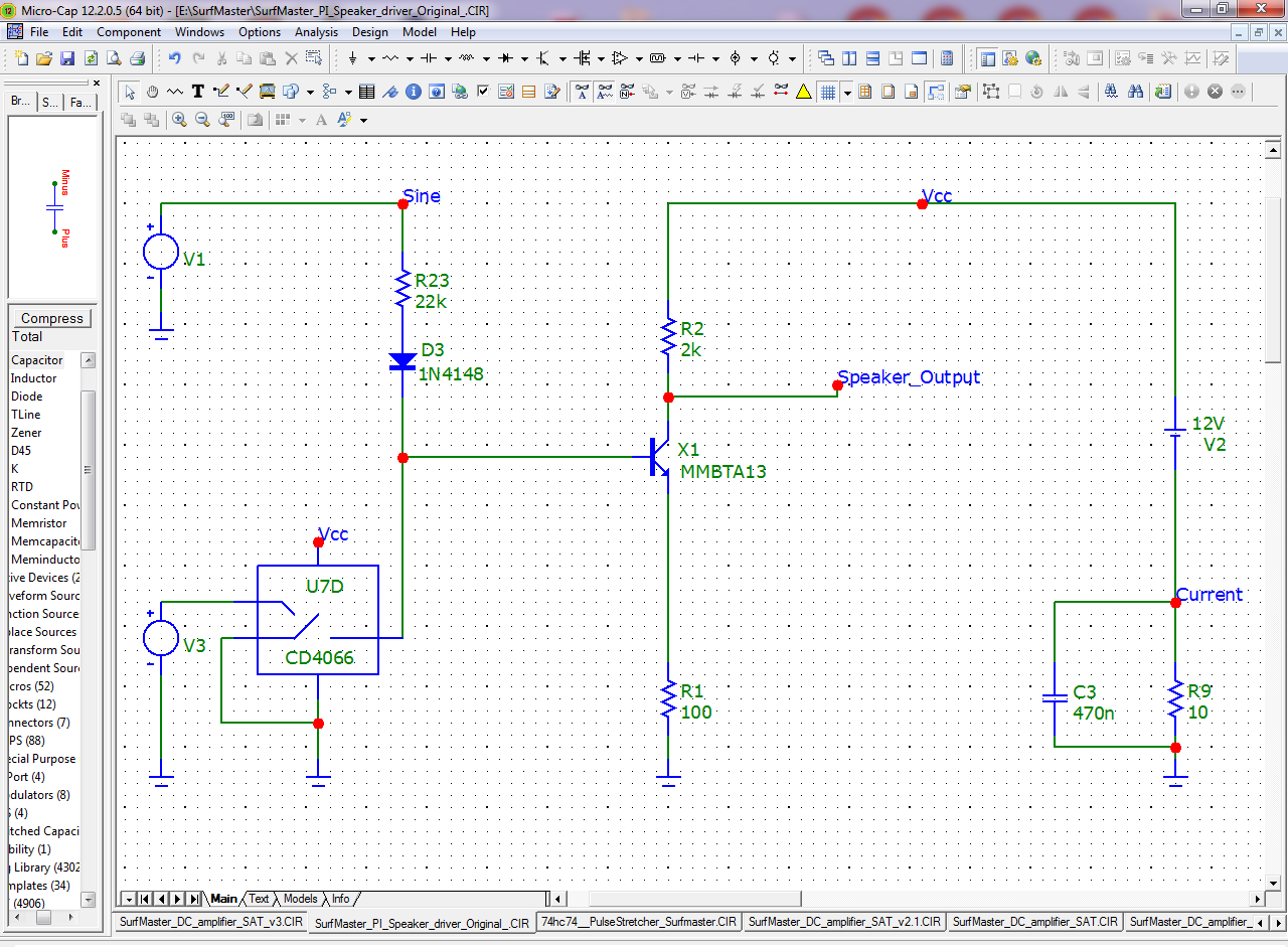

            Well, 2 years after i find what the problem is.... that's all about DC component during transitions, thats why Surfmaster work well only with piezo
            Click image for larger version  Name:	Transient__SurfMaster_Original_Speaker_Driver.png Views:	0 Size:	84.0 KB ID:	413671

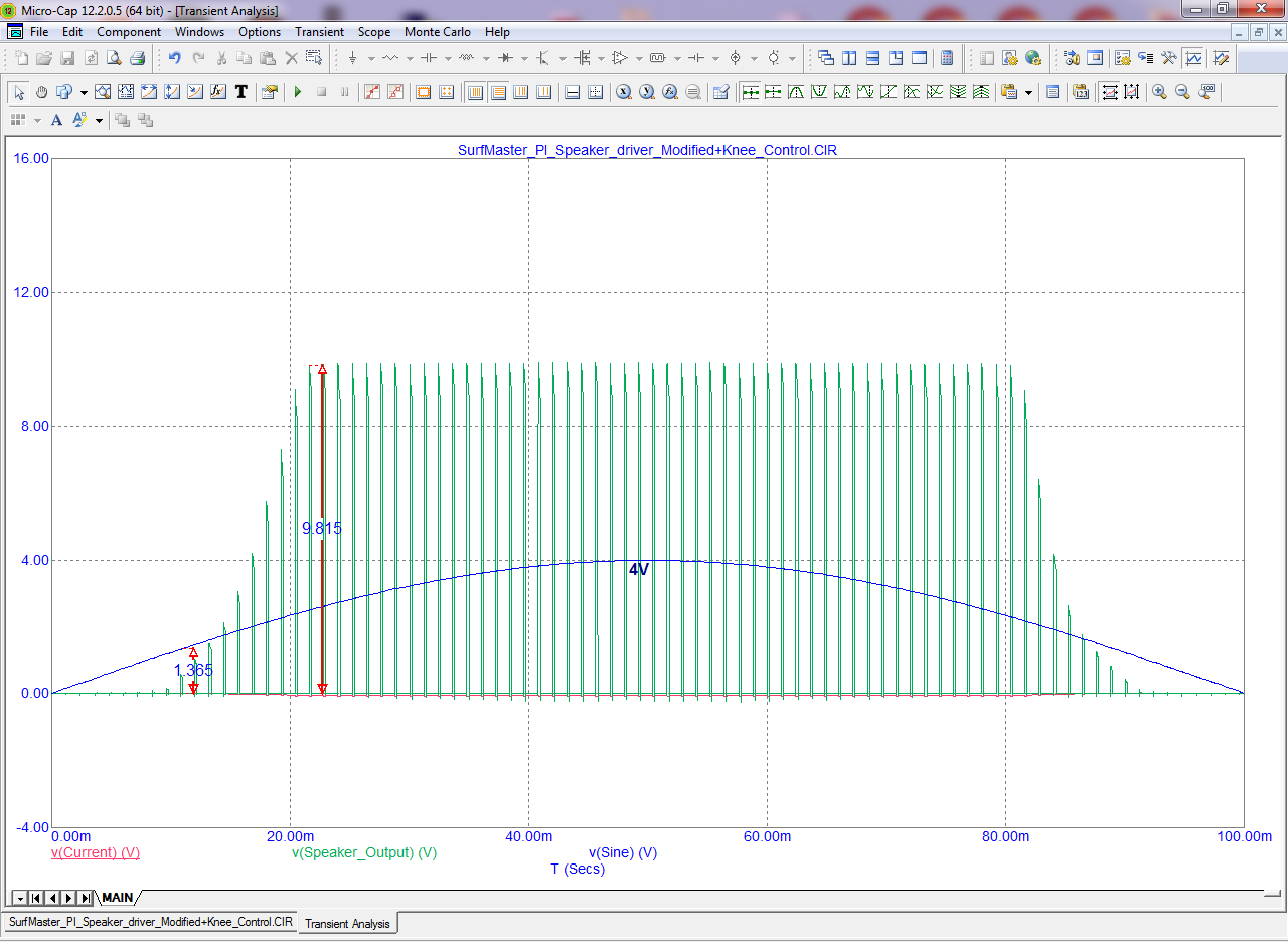

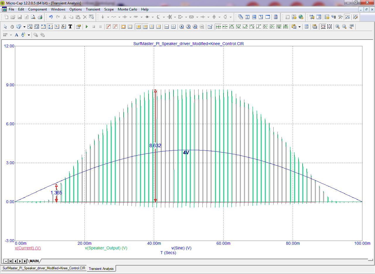

              Here is alternative solution with some small bonus and simulation
              If anyone interested in microcap sourses i attached all in zip file ​
              Click image for larger version  Name:	SurfMaster_PI_Speaker_driver_Modified+Knee_Control.png Views:	0 Size:	130.0 KB ID:	413675
