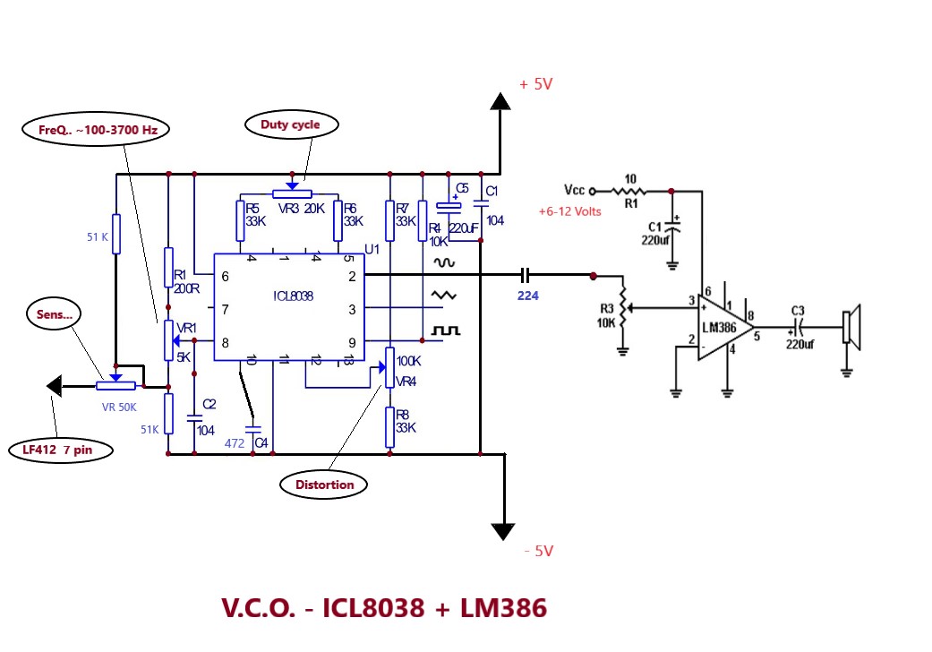

    VCO on the ICL8038 signal generator. A very simple scheme. Exit to LM386. Well, that's how anyone likes it.
    Ready-made boards can be bought on aliexpress. Very sensitive.
    I applied it to a Barracuda. With 8 "coil, one euro per 30 cm. But only with VCO. Normal mode 23-25 ​​cm.
    We take a sine wave at the output and get a very pleasant sound.
    Using the frequency knob, you can set the initial key to suit yourself.

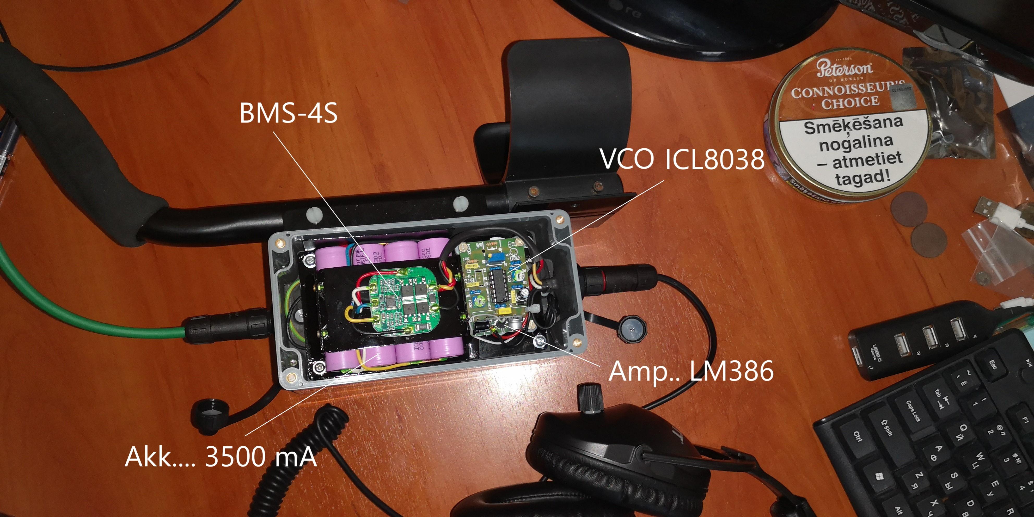

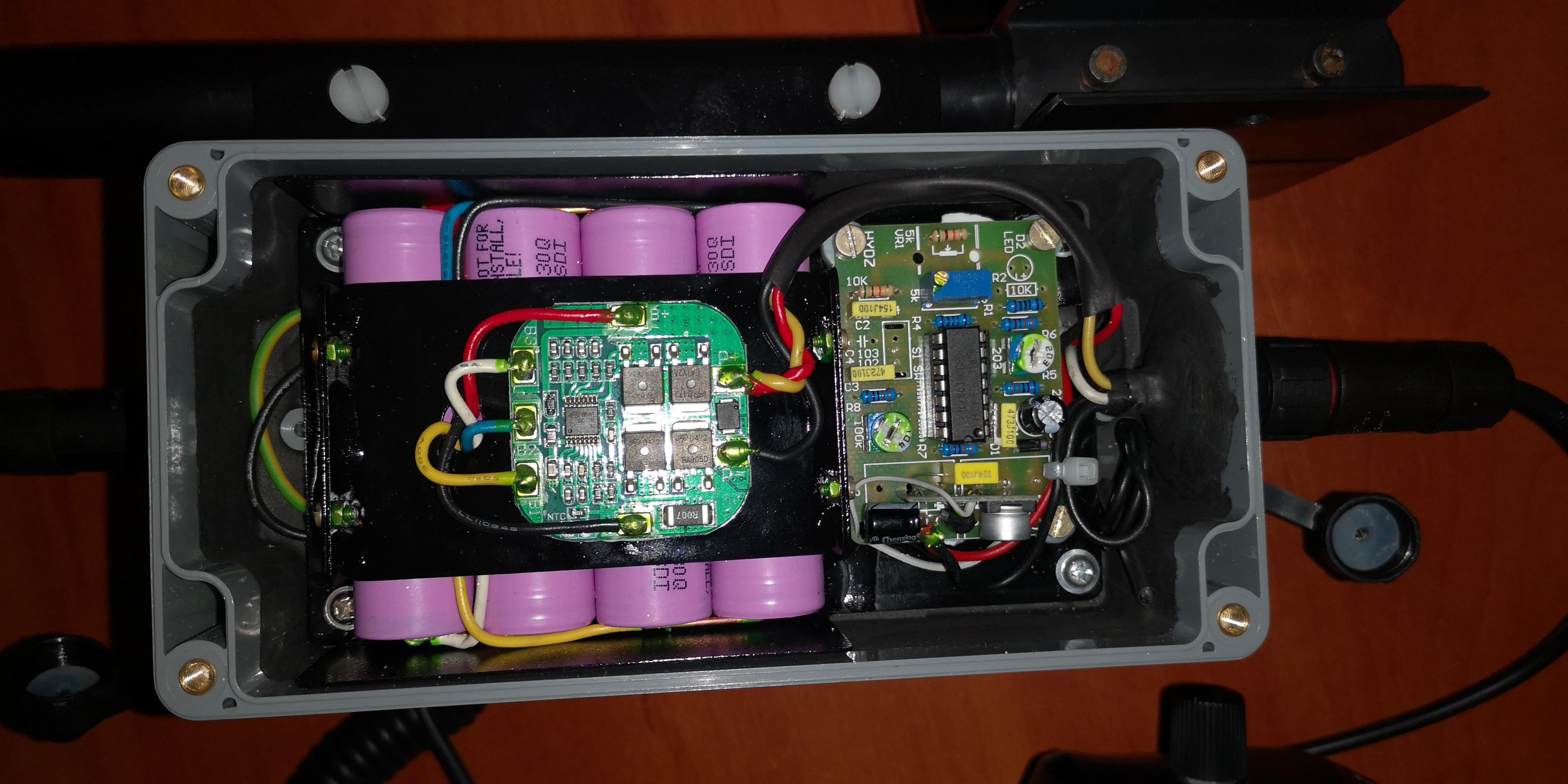

      What a sound, I'll make a video this week. This power compartment, 4 x 18650 3500mAh batteries. Plus VCO + amplifier.
      On the second side, the board itself and control regulators.
      I will lay out the entire review in the Barracuda metal detector section. The box is completely shielded with graphite.

        Cool... very neat solution, looking forward for the sound clip. Um...good idea to make it waterproof,, looks so professional. Thank you Sir

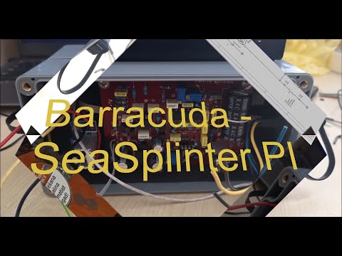

          Video from my Barracuda sound V.C.O.
          I do not speak English so words are few.
          I think something is clear.
          <span class="Y2IQFc" lang="en">
            I watched the video. It looks more like a threshold tone than a VCO.
              I remember i did something like that in the past with other IC vco, and made same connection like you but tests in real
              ground were bad. That because the jfet from 7660 oscillator has it purpose there.
                Very nice VCO sound. Can you post the VCO / Audio circuit here? Thanks
                  okay... no need to post again... I found it already. Anyway thanks for sharing the nice video with the VCO on the Barraccuda.
                    The scheme has already been delivered above according to reports.

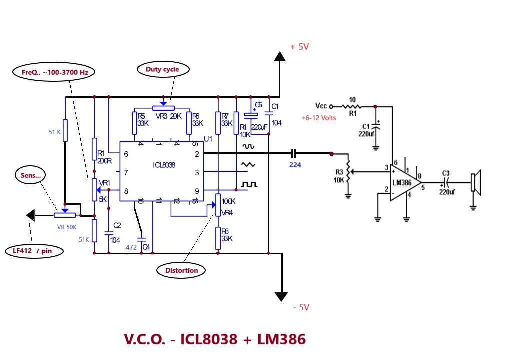

                    But I'll bet some more. Click image for larger version
                    This microcircuit is a generator of different signals, we take a pure sine wave. Therefore, the sound is very pleasant. But this is as you like.
                    The change in tonality is noticeable when the voltage changes by + - 0.1 volts.
                      Nice VCO, sounds just like a Minelab PI.
