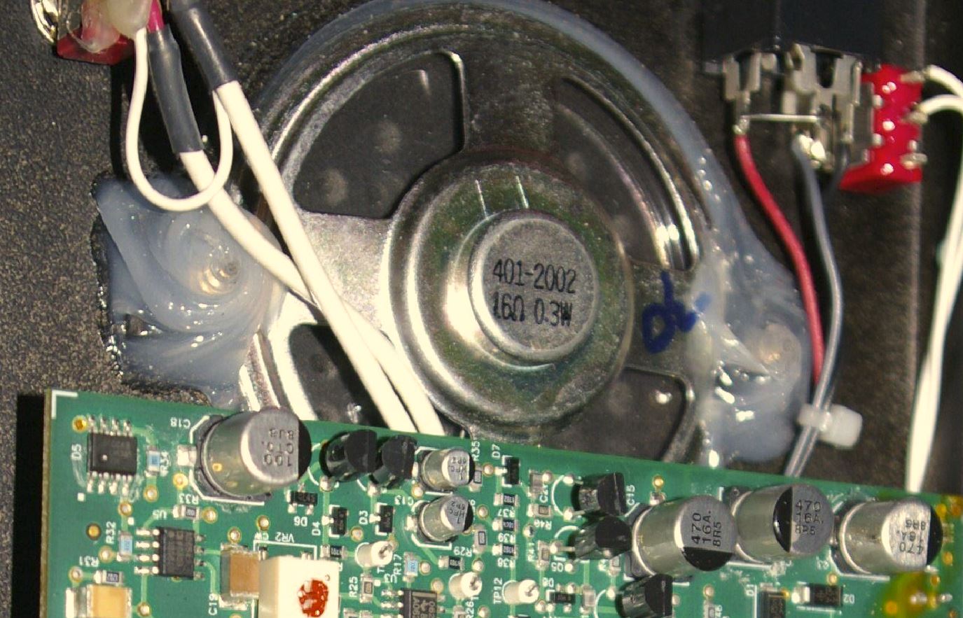

          What is the type of HP (Watts)? How to cable a volume potentiometer as on the TDI Pro on the Pulse Scan?
            Originally posted by Melano87 View Post
            Ok thanks.
            16ohms 0.3w

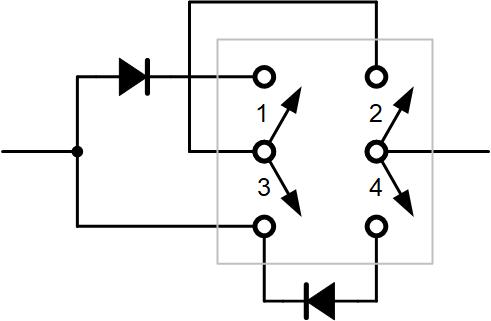

                  It took me a while to recall the weirdness in the Mode switch but here it is:
                  The diodes are normal 1N4148 type, not zeners. The switch is what is weird, it is a DPDT "on-on-on" type. Here is the operation:
                  High: 1 & 2 are closed
                  All: 2 & 3 are closed (or maybe it's 1 & 4, it'll work either way)
                  Low: 3 & 4 are closed
                  There are 2 wires needed but the photo shows that both wires are shielded which is why the connector has 4 pins.
