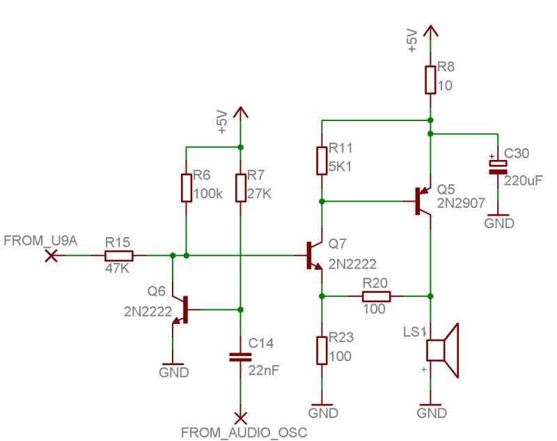

    Regarding this audio amplifier - although the circuit now works, I was a little concerned about removing R6 and R11. Mainly because (if this has been traced from a PCB) then the implication is that they should probably be connected somewhere else. :confused:
    Based on my previous comment that this detector appears to be designed to work with a Tesoro coil, I had a look at the Bandido audio circuit. Then I was even more certain that it is loosely based on a Tesoro design. The only difference is the power supply voltage. Hence, I think the intended circuit should as follows ->
    Basically, R8 and C30 have been drawn connected to the wrong side of R11.
    This make more sense.

            Hi All,
            I was that man!! It was me who designed this machine a long time ago, it should use Tesoro heads.
            I've still got the schematic on Protel somewhere, but have revised this design to include a multi channel variable tone ID and a VERY high power output circuit.
            It was intended to be a commercial design, but I never built it. It was posted so that someone could do this and let me know the results as I dont have the time.
            YES, I know about the error in tha audio amp...SORRY but Protel has a habit of putting connections (dots) in if you place wires too close to components.
            If someone traces out a PCB, can I buy one and built this (my own) machine, or would someone build one and I'll PAY (yes REAL money) them for it?
            Thanks again, I hope it works, though feel free to make any changes you see fit.
              Actually it was intended as a "group project" for this forum (cheap R & D on my part) and for that I apologise.
              Also this design was released BEFORE Tesoro brought out their HOT system on their machines. It was an attempt ot make a Bandido go a little (well, OK a lot deeper) and I'm still interested in the stability etc of the result I produced. I wonder if they got the idea from me? Wishful thinking I guess!
              Bear in mind that there are only a few ways to make a VLF, they are all basically the same, there are bound to be similarities between designs, it's only certain key components which I opted to change, maybe it'll be a useless piece of junk, I don't know, but it worked in the simulations I did (well thge audio amp didn't but that was not the point) =)
                SORRY, NOT a SPAMMER!!
                Yes the +ve regulator SHOULD be a 78XX low dropout series, I'm a moron and was probably drunk when I made that typo!!
