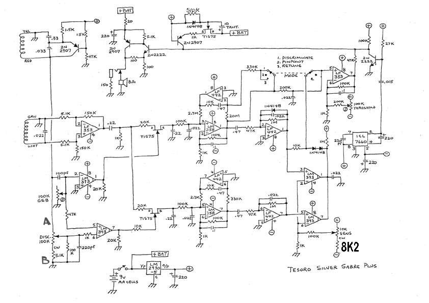

    hi, i'm trying to work out how to fit a switch to my silver sabre plus that will drop it into zero disc motion mode for searching similar to the original sabre but i have very basic knowledge of electronics and hope someone can help
    i have attached schematic posted by Sean in earlier thread and added 2 points A and B where am guessing switch needs to be across?
    i am also thinking of fitting a pot in this circuit to give a second discrimination mode at a lower level for iron, would this be possible?
              In order to switch between discriminate and all-metal mode (i.e. no discrimination) you will need to put the switch somewhere else. The points you have indicated in the circuit will not produce the result you are expecting.
              As you can see from the schematic, there are two separate channels - GEB (ground exclusion balance) and DISC (discrimination). GEB is the top channel and DISC is the bottom one. I would suggest putting a switch in series with the two 1N4148 diodes that are connected to pin1 of the LM393 comparator.

                  I've now found 10 minutes to look at this and I think, though I bet Ivconic points me out to be wrong , that if you look at the schematic, at the bottom left side there is a 5.1K resistor, try putting a 1K resistor on a simple on/off switch across it.
                  I haven't tried this but if you look at it, it's part of the phase shift circuit for the discriminate and when the control is set to minimum, there is a residual shift due to this resistor, thus, reducing the value of this will cause less of a residual shift and so lower the "minimum discriminate" level...IN THEORY.
                  You CAN try values as low as 470R but NO LOWER as this will cause problems with the phase shift circuit, due to the design you can NEVER have true zero disc only very low levels.
                  Let me know how this works please.

                    Anyway, what I MEANT to say was.. Connect a 1K resistor in SERIES with an on/off swithc, THEN solder the whole lot in PARALLEL with the 5.1K resistor. Give that a shot, should work OK.
                      thanks thats great i'll be trying this soon &post up how it goes
