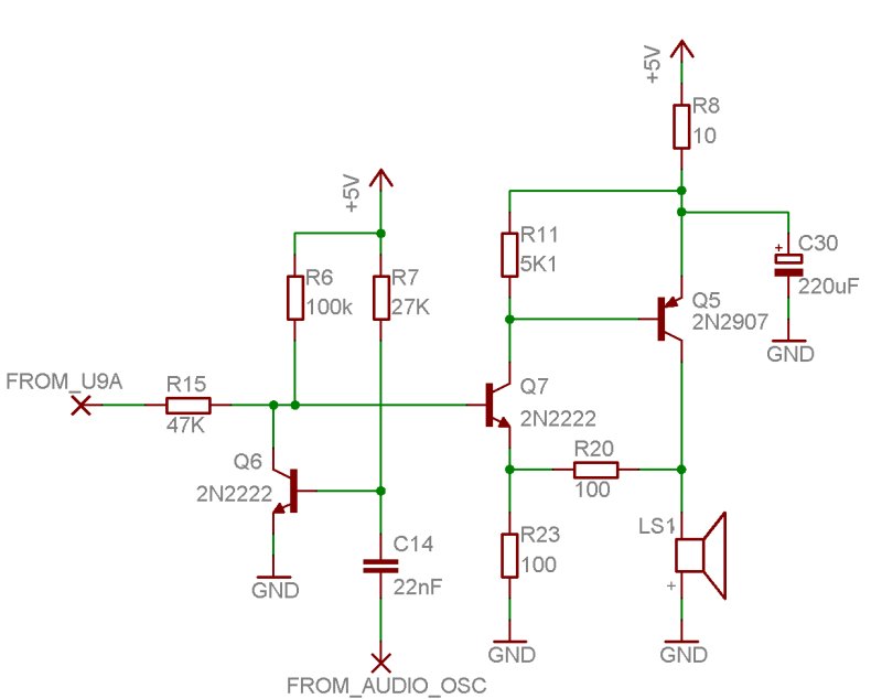

        hi ivconic
        i replace audio part whit this schematic(audio.jpg)
        and short U2(7812).

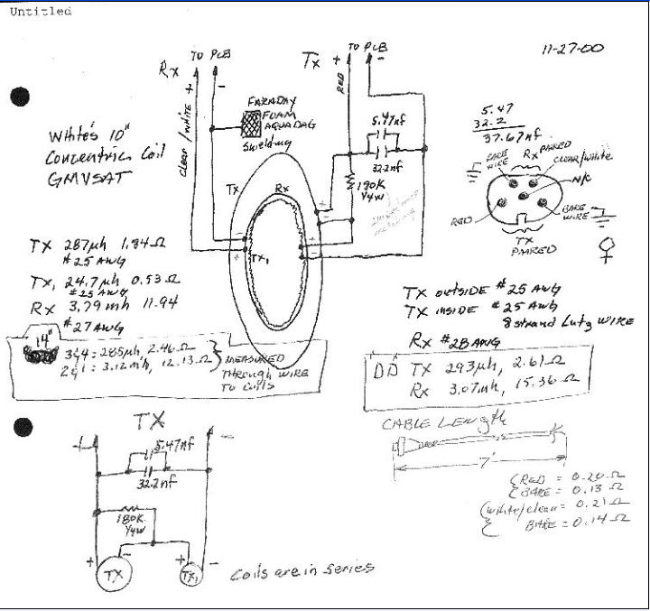

          about bandido coil
          can help me for this detail?
          TX1 diameter?
          TX2 diameter?
          RX diameter?
          and how must choice coil inductance for RX and TX ?
          (about frequency and link to inductance )
            No that is for a Whites which use a "tuned" coil. It will not work for a Tesoro type design.
            Look up Dave Emery's posts on how to build a coil.
            Ftx should be around 12KHz if you get it to work

              i used bandido coil for this
              RX1 (inside): 12 cm dia with 170 T 13.5 ohm (0.35 mm wire)
              TX :20 cm dia with 100 T 6.2 ohm (0.5 mm wire)
              RX2 (outside):20 cm dia with 20 T 3 ohm (0.35 mm wire)
              TX frequency : 16.95 Khz and 9 volts (with 12.8 v Supply)
              I cannot found 74HC4016 so use 4016
              sensibility : not good . detect 20cmm*20cm metal plate from 30 cm distance.
              maybe bad sensibility for 4016 or coil (because bandido coil designed
              for 10-12 Khz and this metaldetector work around 17 Khz)
              can somebody help me for this ?
                Sisco,
                Please post me the circuit diagram you used. I will have a look at it and see it I can see where I made a mistake (yes I know there were a few). Protel did not put dots on the diagram and I screwed up the audio stage. Should work with your version though.
                Try changing caps in oscillator to lower frequency. See if this helps.

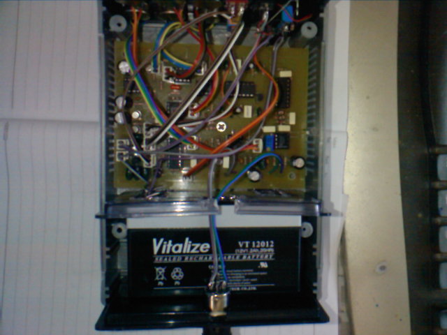

                  Hi Sean_Goddard
                  I use Qiaozhi ZIP file in this address:
                  http://thunting.com/geotech/forums/s...ad.php?t=12142
                  with change audio part.
                  and use own pcd design for this circuit (one layer).
                  can open with :Advanced PCB2.5,DXP ,SE,Altum Designer6.
                    this is my PCB:
                    this PCB hard for make because use one layer and more than 30 jampers.
                    another question :how must calculate TX frequency?
                    TX frequency not FIXED (between 16.5 - 17.8 KHz)
                    and thank for this help.must change oscillator caps and test.

                      I see many obvious mistakes instantly and will try to correct then over the next few days and post a corrected diagram for you in Protel 99 format. I am very busy at work so may not get it done, but I will try my best.
