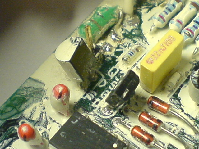

    Another improvement to the SD2000 to make it more sensitive is to change the 2 P and N channel fets on the input of the detector.
    Change VH2410L to TN2404KL This fet has a better voltage rating, improved threshold is half the RDS on and is faster. It also has very low Capacitance.
    Change ZVP4105 to SI1021R, this device is half the RDS on and has better over all specs.
    The attached pic is where the 2 fets live on the board.
    I just realized that you do NOT know what you are talking about. You are actually making the detector more sensitive by removing all of that gunk from the board!
      "Gunk" meaning paint? I thought this paint was electronically inert, and has no influence on the electrical properties or frequency components in the circuitry. Am I wrong?

        The white paint is not conductive, except when you soak it in White spirits as I found out.
