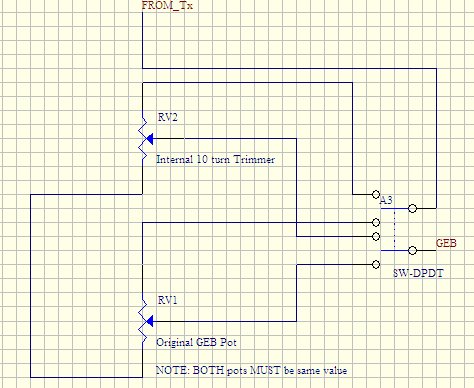

Hi, I own one of the earlier Bandido models ( 2x 9 volts and manual GB, simalar looking to Lobo. Laser B models ) and what I would like to know is how to add an automatic GB switch.
Any information regarding wiring in etc would be most appreciated.
Would it be possible to::: find an average site....ground balance....measure pot resistance......fit 2 way switch with coresponding resistor? Anyone had a go at this? Would it work? Thanks Chop
If by "automatic GB" you really meant "preset GB" (they are quite different) then, yes, find your "average" soil conditions, set the GB where you want it, and measure the pot resistance. This assumes the pot is connected as a two-node variable resistor, as it is in the Bandido II uMax.

Very true, I have received an e-mail, but alas am unable to post regarding my endeavours, as I am lacking the GB schematic etc, perhaps you have sent one Sean? if you have could send it again please, as I did not get one.
Or a photo of your own Bandido coversion with the relevant info would do.
