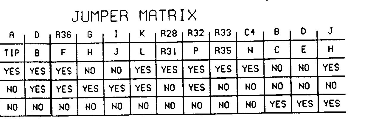

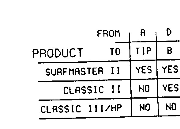

                  Change jumper combination only, change type of Classic. Code is in table.
                  Mrand
                    Jumper matrix
                    Thank you Mrand. Now I just need to decipher the jumper matrix? Maybe the far left has been cut off in the scan?
                      Sorry!
                      I think i see now scan in two pieces. LOL. I will experiment tonight.

                        After looking closely, there are surely differences besides jumpers. There are added components on the Surfmaster II PCB. Most notably, a resistor at r59, LED, and capacitor on the left side. The only thing I am trying to do is add the Blue Max style coils to this circuit. A schematic on the two would surely help as well to show what the jumpers actually change/disable/etc.
                          Jumpers
                          Thanks so much Mrand for the jumper listing. I have pieced it together so that it can be easily printed.

                            my english is not so best to give you detailed answer and I see the people do not wishes to give you suggestions. I try to tell you my vision on the jumpers. these are NOT what you think about them. these are only for some 'constructive, for future updates'. Whites uses such PCB trying do some updates due on serial PCB using it as testing PCB. they connect a some electronic to the PCB. I might be name this way 'conveyer' one or maybe 'very quick' way for to test new schematic decisions. if they have see the decision got OK, then they will change PCB layout (and the jumpers will be deleted).

                              Thank you KT315. You are correct, the jumpers are for things like moving the potentiometers around on the board,etc. Not much use really. The coil is wired the same on both the 6b coil and the G or H coils for whites although different values exist within the coil itself(caps) that prevent the correct ground balance and ultimately the depth is affected by this quite a bit. I believe changing the value of R59 should take care of the interior differences of the coil. In the classic II circuit it is a jumper and in the Surfmaster circuit it is a 1/4 resistor with a rating of 270 ohms.
