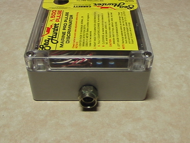

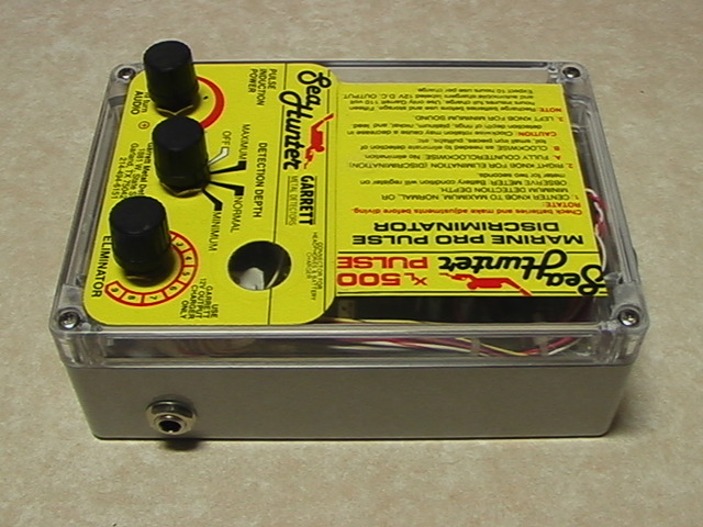

                  But i still need to boost the xl 500 a little bit more(some help will be appreciated greatly).I have changed the housing so it is much smaller and lighter now ,yet still ok to use at the beach it,s one of those housings with the clear top.

                  • Heres what I have done ...I have removed the vu meter because it was too big,I am waiting to get a lcd one that will fit nicely inside the clear cover.
                    • Dang! Cool case you have there.
                      What is it?
                      No I have not tried the 200 coil.
