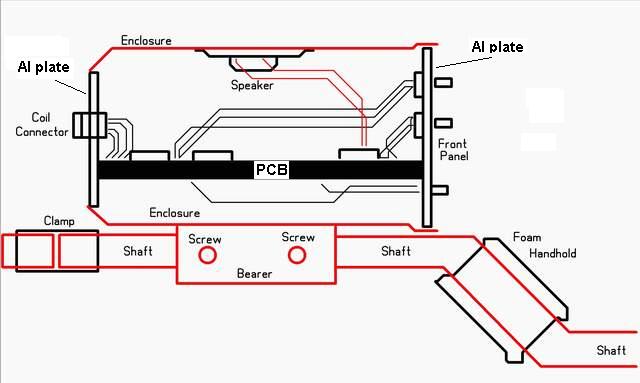

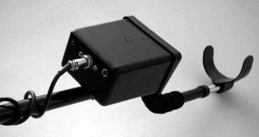

                              • #60
                                This is a kind of setup i am using for longer period, same for many of my handmades; TGS,TGSL,1265,2tone by Sasho and now for Eldorado.
                                I suggest this way of packing cose pcb was designed especially for this one.
                                That's why i always insist on "1265" cose mostly i am using plastic enclosures directly copied from original Fisher 1265 enclosure. Turned to be most suitable for handmade so far....
