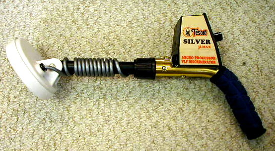

    Does anyone know how to BOOST the output of the whites bullseye II 120mm Original pin pointer

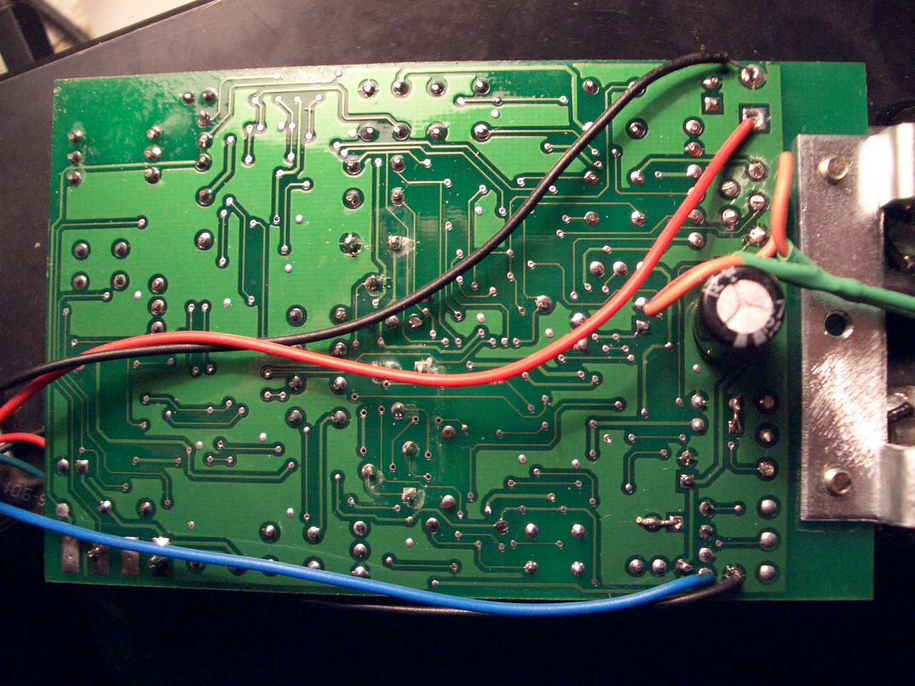

            Hi Steve in MS & KT315 there was a guy on Treasure Net Forum that did a video about the Whites Pin Pointer not getting the depth like other pin pointers do and i was just wondering if by chance there was a way to enhance the depth by a inch or so if possible and yes I can get the back off of the pin pointer if I take a picture of the board can you'll point out which pod you would turn to increase the depth.
            Also since it detects from the side of the probe is there anyway to shield the side where it would detect at only the point of the probe like the vibra probe detects.
            Dave

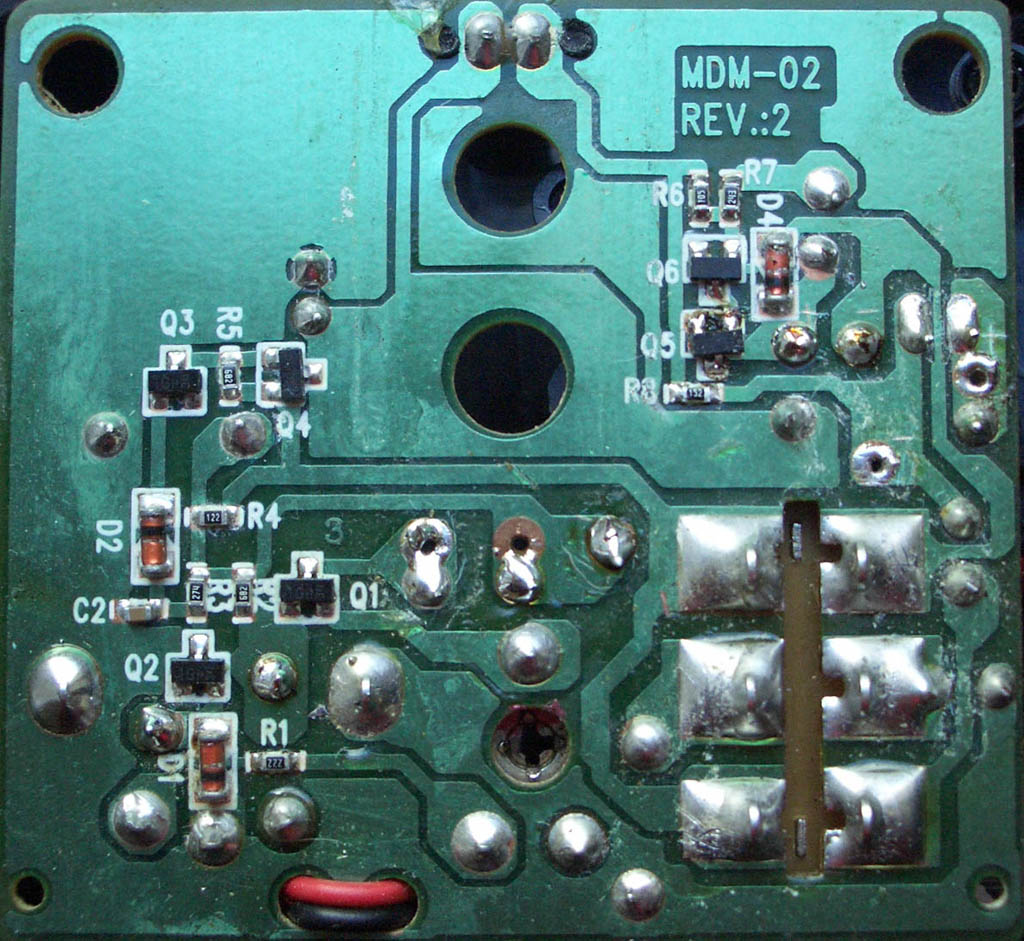

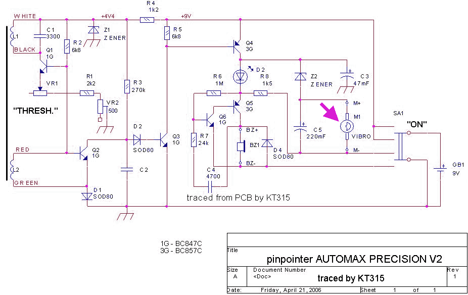

              Dave, can you put PCB in scanner? shoot all wires soldered (you will have all photos on a case) then desolder the wires from the PCB, scan it from both sides. despite it seems some kinda hi-tech espionage, but we will not demonstrate our photos china people
                viper trident, I did shoot PCB at a case I will solder these back. an example.
