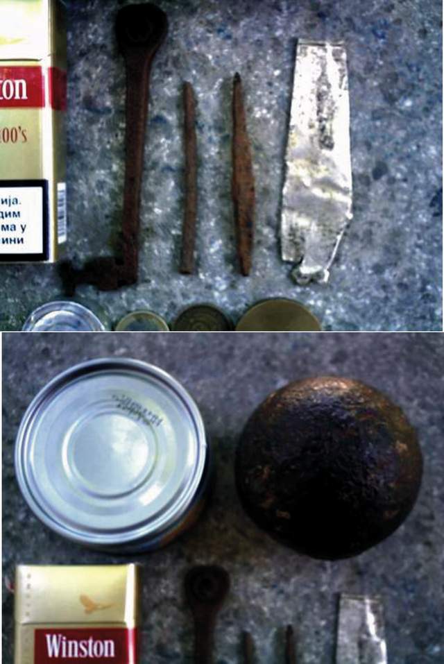

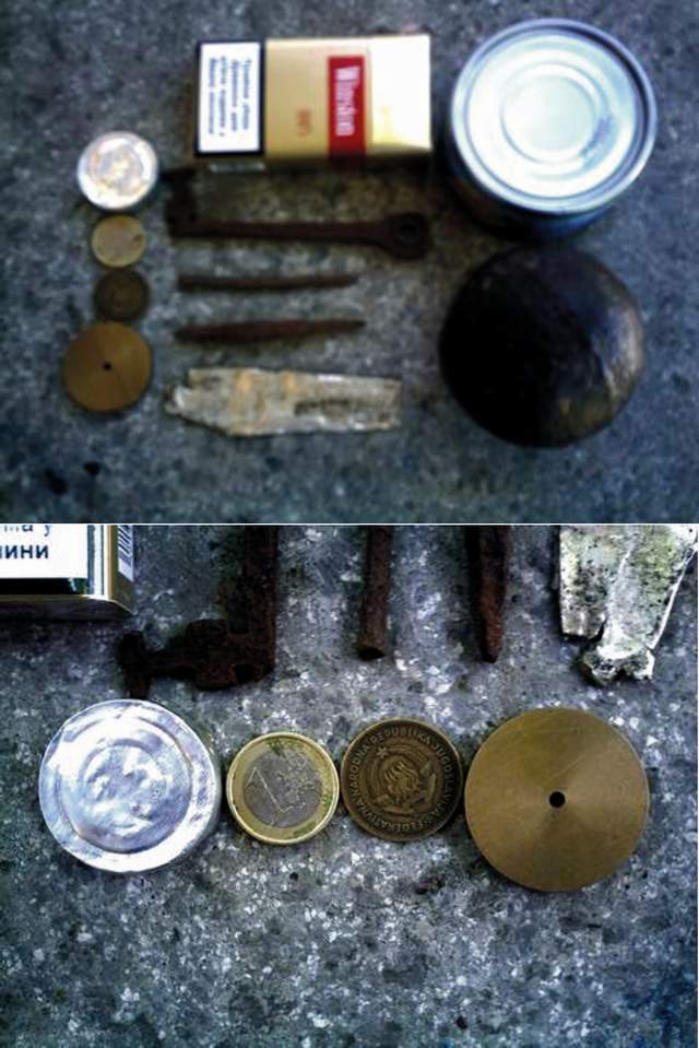

        Hey Max, it's been a while. Sorry i could'nt done it earlier.
        Well...
        Recording was done in my living room, right next to pc. Somehow i managed to put all togather and avoid much of interference.
        Keep in mind that those recs were made under those conditions and so as i noticed md behavior is a bit different (not to much) than if it was done outdoor on soil.
        I collected few items and made mp3 file upon each one. No need to explain more. I give here photos and mp3 files.
        Oh...yes...need to explain a bit more. Coil was faced up and steady. I took item and by swinging on 30cm over , cm by cm closed to coil surface. So you will easilly notice differences. First few swings are slow and than goes faster as item reach coil surface.
        When you listening cannon ball.mp3 dont be confused about sudden appearance of some background noise, it was damn car passed by my window!!!
        Ok... that was all...ask if you have something else to ask...
        Regards!
          Oh yes;
          i forgot only...most important thing!
          Item---------- Disc at 1st half of mp3----- Disc at 2nd half of mp3
          -1e coin --------------- 4 -------------------------------- 4
          -2cm coin ------------- 4 -------------------------------- 4
          -fat brass washer --- 4 -------------------------------- 8
          -Al disc --------------- 4 -------------------------------- 8
          -Fe arrow (rusty) --- 4 -------------------------------- 8
          -Al can ---------------- 4 ------------------------------- 8
          -Cannon ball ---------- 4 ------------------------------- 8
          -Fe key (rusty) ------- 4 ------------------------------- 8
          -Silver plate ---------- 4 ------------------------------- 8
          You will notice one item from photo is missing in this list. It is nail look like item. It was totally rejected in all cases.
          About silver plate mp3; you will hear strange behavior (much different) somewhere from the middle of mp3 file. That is because i turned it lateraly during swinging... Interesting change of behavior, that's why i recorded it in that manner.
            Yes...;
            most of the spitting you can hear at Fe key mp3. And most pleasant signal to me (subjective) is reaction on Silver plate..of course!
            Possibly at other models too, but at Musketeer there is very significant difference between sound from speaker and sound from earphones.
            Nothing can compare to sound from earphones. Sound from speaker is poor comparing to it. That's why is desirable to use earphones as often as
            possible. Sound what you can hear in those mp3 files was recorded from speaker. But since mic was very close to Musketeer speaker i am noticing
            very good simillarity to sound i used to hear using earphones....So..it is probably due enclosure acoustic and speaker features itself...
            Use earphones whenever you can.

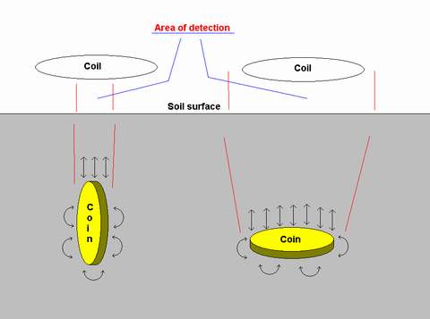

              "...About silver plate mp3; you will hear strange behavior (much different) somewhere from the middle of mp3 file. That is because i turned it lateraly during swinging... Interesting change of behavior, that's why i recorded it in that manner.."
              This is excellent example to understand better how eddy currents from item surface directly affects signal.
                I forgot to attach this draw. Maybe is not art, but it can illustrate what i ment in previous post...
                  Great.
                  So there is some kind of sampler there?
                  You get pretty good info about the target:size,depth,material!
