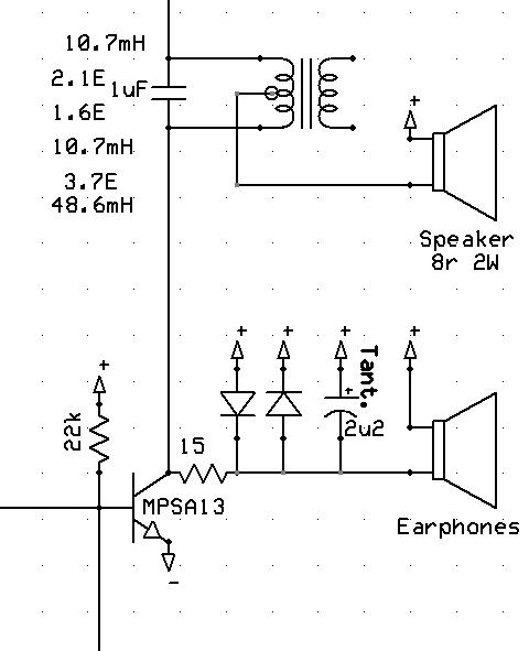

          Unfortunately, this forum is not friendly to new users, and I cannot contact you in private messages. In the Musketeer, the speaker is connected to the secondary winding of the transformer, or to the primary tap?
          • #80
