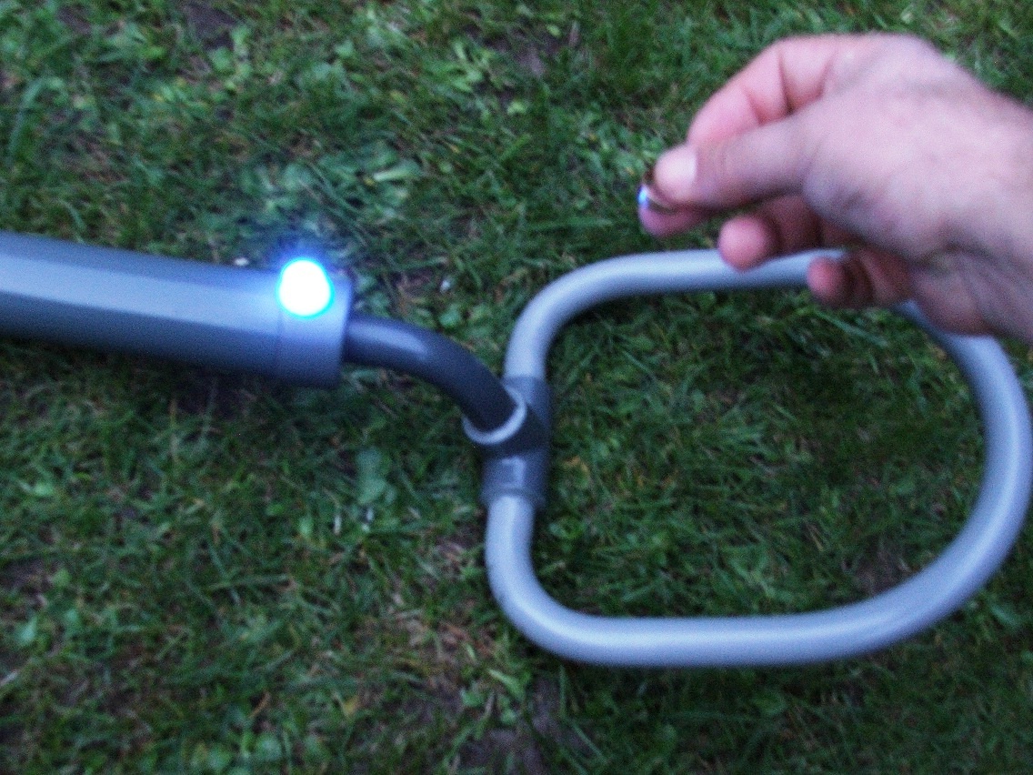

    Hello Friends,
    Made another version from the Surf PI, it is the long print version in a ‘dive’housing. The new option is the led indication as signal for find indication.
    Not so hard to make, not a speaker as output but a hi bright led or even a luxeon type for even more light will work. The threshold works just like with a speaker, with the volume pot you can adjust the 20 mA for a normal led or even some more power for a luxeon type look at the max for the mpsa 13 and take care for the heat from that led. If you made the long print version you can cut the track that is coming from the 4066 to make the audio sound to the mpsa13. ( not that it is must )
    You can dive this way without cables for audio….
    Best regards.
    Ap

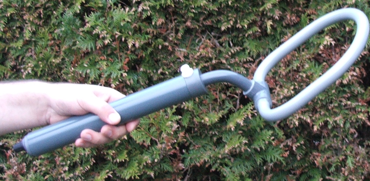

                              Hi ApBerg and everyone
                              I'm new here but love what I've seen so far.
                              I'm waiting for a couple of kits from Silverdog, and in the meantime looking around for ideas on the housing. I love the design you have come up with here, but am wondering how you got the coil in there?
                              Did you cut the pvc? Wound the coil by feeding it thru? Sorry if this is a basic question, I'm quite new to it all. Also, How did you bend the PVC, with heat?
                              Thanks,
                              Ant.
