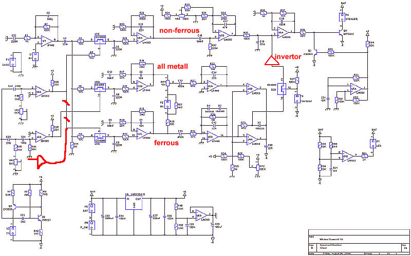

        I have been wanting to add the Ground Balance and threshold control to
        My Classic III. does anyone know which part they are labled on the schematic, and what the values are. Even better would be the correct part number from whites, or an alternate source to order from.
          white's classic 3 threshold andg ground balence knob
          Threshhold is 200k, ground balance is somewhere between 10k and 25 k.
          25 works and is a little too touchy (sensitive to set with he fingers) and the 10k doesn't cover it all but will work. use a piece of ferrite to test it. proper ground is supposed to close to where moving the ferrite away from or towards the coil beeps the least.

                    ivconic, how is this idea for you? it is known that classic has good sens in All metall mode, but low sens in Disc. bad thing... so we change these roles here - pinpointing channel now will work on full power, but discriminates (I think...).

                              some refresh info on Classic
                              hi people of the earth.
                              what you see what you get. done by Dmitry (Deamon). position numbers are not such as you see in original schematic - attention to it.
