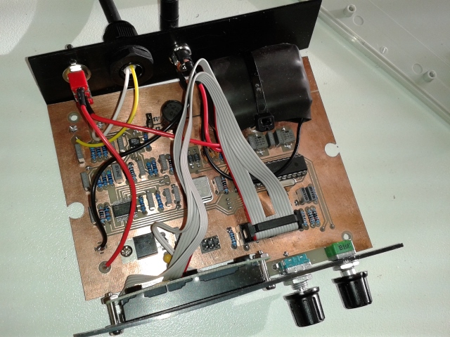

                Hi all,
                I'm in the process of drawing the circuit board of this project, but I presume that the sinusoidal out terminal and ground terminal is connected in lieu of the crystal on the sd2000 board.
                Just want to verify this is correct.
                When its complete and working, I intend to publish pcb artwork for a doublesided holethru version for this forum.
                thanks and regards
                Martin

                    Thanks for that Ian, this must be the ultimate mod for the 2000/2100's. I hope to get it working by next weekend. Got the board etched today and soldered the vias. Still waiting for parts to arrive, was unable to order the 100mhz crystal so i got a 50mhz instead. I noticed in an earlier post that it should run ok with a 30mhz crystal.

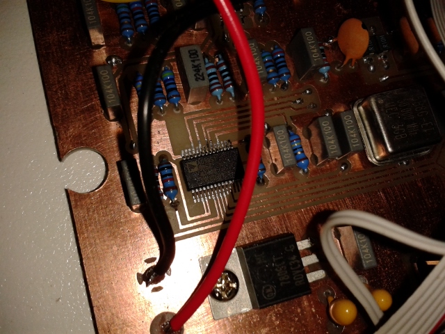

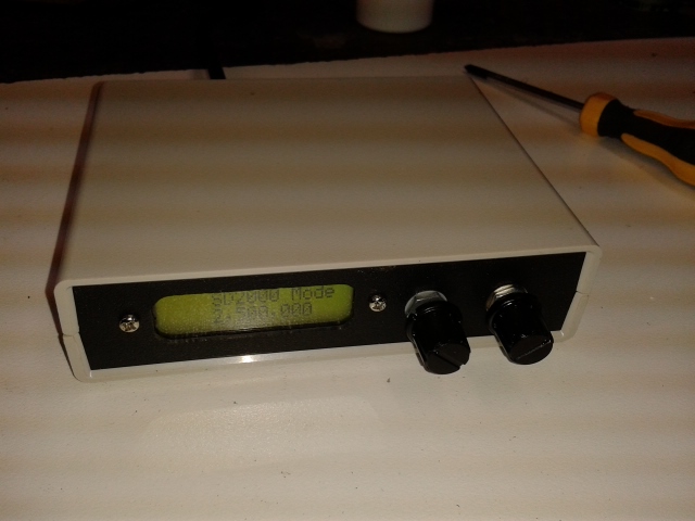

                        • Hi Mario
                          Those 100mhz are hard to find, but last night I hopped onto Element 14 which had 26 left in stock and ordered two. Should receive them later next week. Got my unit working, but it should work properly when I get that crystal replaced. I built this signal generator so it would operate at lower frequencies and now I have a substantial increase in detection depth.
                          This detector does not operated well in the suburbs, so to test it properly I will have to go out of the city.
                          I hate working with smd parts but I am happy that the ad9851 mounted well. I have posted a few photos of my unit.
Name:	2014-07-30 16.10.36.jpg
ID:	341379Click image for larger version
Name:	2014-07-30 16.11.36.jpg
ID:	341380Click image for larger version
Name:	2014-07-30 16.20.54.jpg

                            • Originally posted by Finderskeepers View Post
                              Hi Mario
                              [ATTACH]30771[/ATTACH][ATTACH]30772[/ATTACH][ATTACH]30773[/ATTACH]
                              Glad to hear it working.
                              I intentionally used smd parts to keep the board small. Also, you'll be surprised at the number of parts manufacturers keep from DIP packaging. Even SMD is becoming increasingly rare these days, with some companies preferring others like QFN (yikes!).
                              Once, you get that 100Mhz Osc, you should access the full range of frequencies intended for your SD2000.

                              • Got the 100mhz crystals today and popped it in my dds unit. It now works fantastic, the machine operates right down to 1.1mhz with no problem. I just love how you can fine tune it and find a stable frequency. Nice work Mario. Will put a short video on youtube soon.
