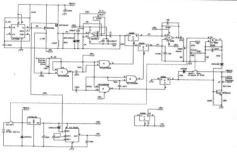

      Hi Jim,
      You might find this schematic interesting, higher gains in later amplification stages, time constants as per original and gain pot(sensitivity adjustment). Not sure if this is genuine Pi Pro circuit, posted on here as barracuda_Pi.jpg by someone, somewhere that I cant remember! ..........Cant work out how to attach it in this reply ( this is my first post)
      Looks sensible to me ( but I'am no expert!) Will post later when I have worked out how to attach a picture.

          surf pi pro circuit ?
          Thanks 6666,
          here is schematic. Circuit also has changes around 2n3906, and extra 100uF in parallel with 0.1uF across 5v supply.
          Maybe one of the experts on this forum can explain these mods to an amateur like me.
          I am guessing 5v ripple/ noise will be reduced by extra capacitance but is placement on the board also important? hence two caps shown in parallel??
          I assume extra 100pf across 1st op amp input is just to reduce noise? I can understand changes to later op amp feedback circuits for added gain, but keeping time constants as original, with the added sensitivity control. What is the logic of altering the gain this way rather than adjusting the feedback resistor on the op amp?
          Regards John

                    Hi John,
                    At a quick glance the schematic seems to only differ from a normal surf pi by just the pot between the 2 stages of the LM358. will look more closely later. Is there a larger print version that would be easier to see?
                    Cheers, Jim.
                      Hi Jim,
                      That's all I have got I am afraid, I downloaded it from this forum a while ago, so maybe the original poster can supply a clearer copy?
                      If you look closely you will see that the last two amplifiers have higher feedback resistors to increase the gain, and the capacitors have been increased in value to keep the RC time constants as the original design.
                      If you just want to add a gain control to the standard surf , use a 220K pot instead of the 100k and your time constants will be about right.
                      You can get a bit more gain by increasing the feedback resistor in the last amplifier from 100k to 220k.
                      I think someone else was claiming that whites had designed the circuit wrong and it works better back to front, I think they meant lower gain on the preamp, and higher gain on the DC amp at end. There may be a grain of truth in this as I got less noise by reducing R9 a bit
                      and increasing R22 a bit, as you have also found.
                      You could swap R22 and R9 and see what happens!!
                      On the other hand I could have got this totally wrong, as the poster was talking in riddles for some unknown reason, and I am sure whites will have used the gains they chose for each amp for good reason.
                      There are a few other small changes that I mentioned before that I don't fully understand.
                      I was hoping someone with a bit more Knowledge could explain them............
                      Regards, John.
                        Hi John,
                        Yes i see the changes to the gain in the LM358 stages and how the caps have been adjusted to keep the RC time constant the same, although in the first section it looks like the resistor has been increased and the cap decreased (working from memory here, I think the cap was 470n in the original). I wonder if this has any effect on the sweep speed tho? This is something I considered trying myself as the RF noise I get at the beach has more affect the faster the detector is moved.
                        As for the decoupling caps on the 5534 it would surely not make much of a difference to put 100pf in parallel with 100nf. I would just use the 100n to keep the supply to the 5534 clean.
                        It looks like someone has taken the SP schematic thats here on the forum and worked in the hand drawn notes, put the power supply sync to the 7660 back in and tweaked the gain on the 358, then tried passing it off as the Baracuda!
                        Interesting none the less, I am tempted to try the mods to the 358 section, I have a SP permantly set up on bread board just for this kind of occasion!!!
                          is there MOS-FET or you see TIP32C transistor Q2 inTX stage ? what value of R6?
                            Hi KT315,
                            The above schematic looks like it uses IRF9640 for Q2, as do I. Can't remember exactly which part R6 is, but if it's the damping resistor then the above looks like 390 ohms, the same as i use.
                            Regards Jim.
