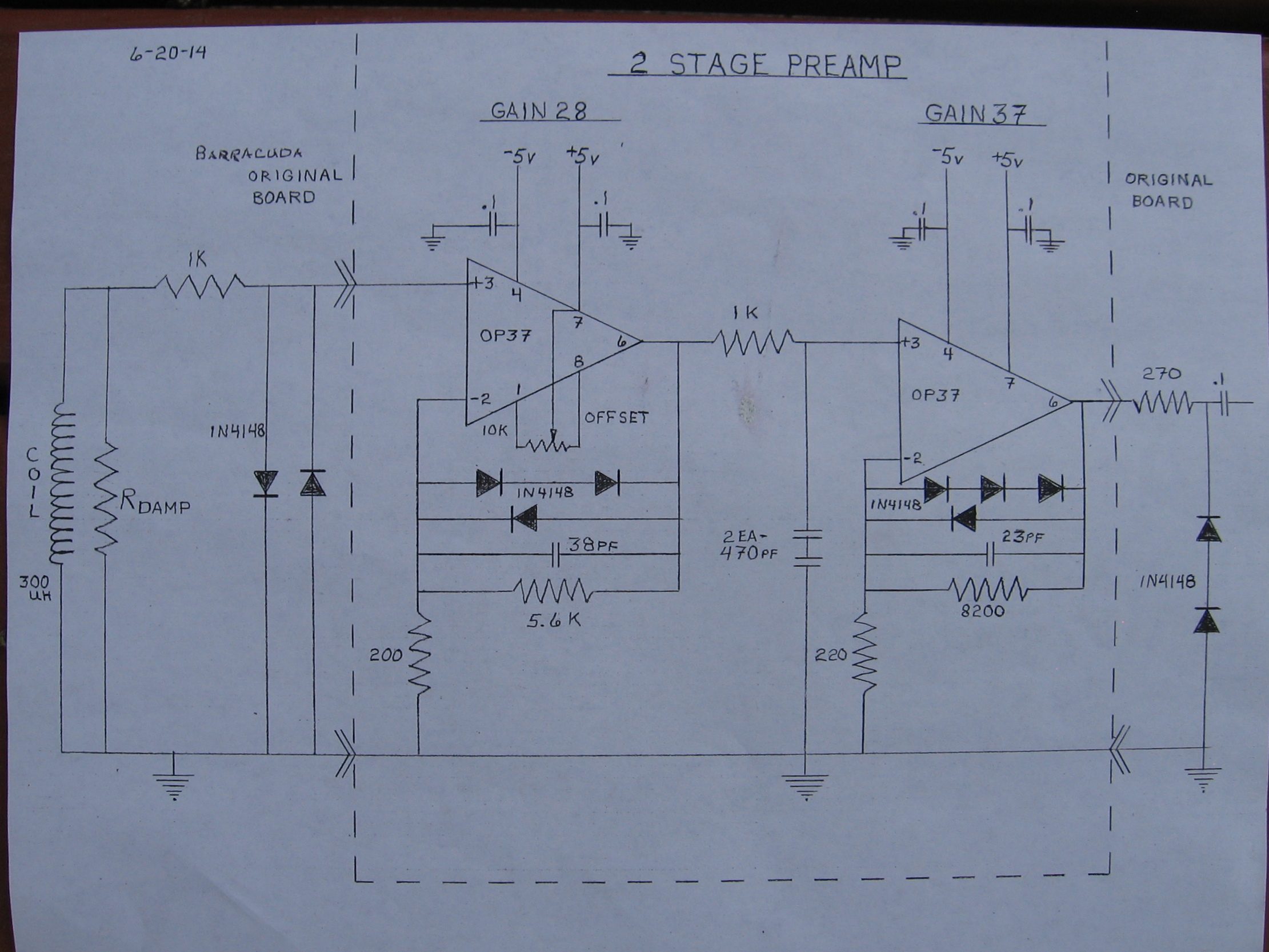

    Sorry for the bad picture. Having trouble since the mobile app for this site has been jacked and all my pics are taken on my IPOD, so transfer got more difficult. Will try to get a better picture with a real camera tomorrow and post it.

      Attached here is a much better picture of the schematic. Sorry for the delay!

            • UPDATE ON CHANCE PI 2 STAGE PRE AMP
              I did a bit more testing on the 2 stage preamp today.. After first visiting the Russian forum to check schematic details on the interface between the amp out and the A/D in I noticed another mod that is not in place on my detector. A 220uf 16 volt electrolytic is shown at the VREF out that I was unaware of this as a mod. Presumably this is to further stabilize the VREF voltage. I will be making this mod soon and post the results here.
              As I mentioned in the original design description for the 2 stage amp the 14 diodes in the feedback loop of the second stage allow output voltage to go to about 10 volts without going into saturation. I mentioned that I would lower this voltage if it proved unnecessary to have the 10 volt output and my testing today indeed shows that it is unnecessary. I characterized the effect of different inputs to the A/D and it's saturation tone, a raspy buzz, occurs at 4.5 volts above ground. Knowing this I decided to eliminate 6 of the series diodes in the feedback loop. As it is now, the detector operates normally with 8 diodes, giving about 5.5 volts max signal at the amp out. A bottle cap will still trigger the saturation tone at about 1.75" and I think that is enough. A larger target will trigger the saturation even deeper than the bottle cap. This change has no effect on the small/large target sensitivity. In this configuration full scale signal strength of 11 units is achieved without the saturation buzz with the bottle cap at 2".
              Setting the amp output offset I found that the best operation is between .6 and .7 volts above ground. Will try to refine this further. LP filters have been modified in the prototype to pass 1.25us and longer pulses but the jury is still out on the benefit of that with a minimum 8us sample delay. Probably not worth doing.
              Dan

                            • 2 more gold chains tested, a 4 gram 1.1mm box chain and a 9 gram braided wire chain, both 14 kt gold. I changed the LP filter response to pass 1.88us and longer signals and both chains gave correlated beeps with the passage of the chain through the center of the coil 3" out. The clasps of both chains were kept out of the field. While there are always beeps with target passage there was not tone lockup. Another test with a 4.5 grain (<1/3 gram)14kt gold head meant for mounting a 4mm stone with no post or any other attachment gave repeated first indication of detection at 6". I think the 677khz LP filter I originally designed in the 2 stage amp is too high as there was noticeably more chatter…so I lowered it to about 530khz and it behaves much better. By the way the 220uf cap mod at the VREF out I have found to be unnecessary as it only degraded performance. More silver and copper coin tests later.
