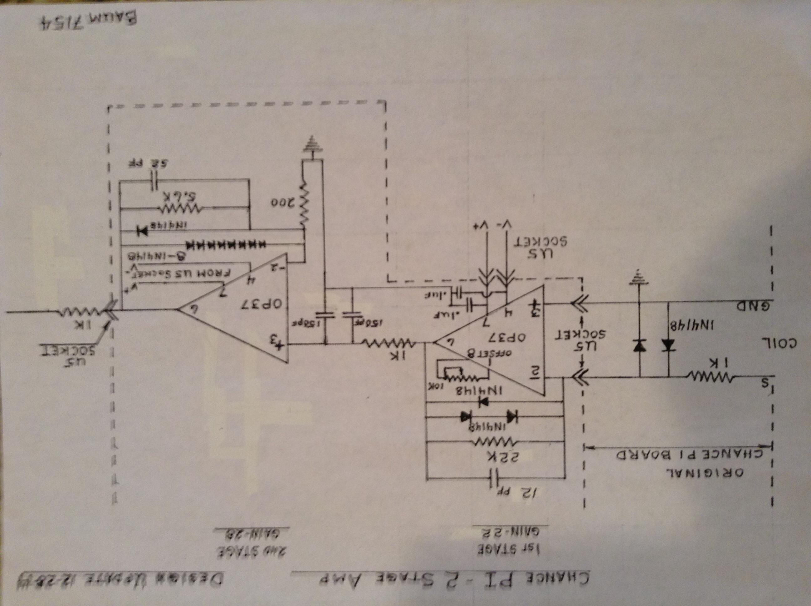

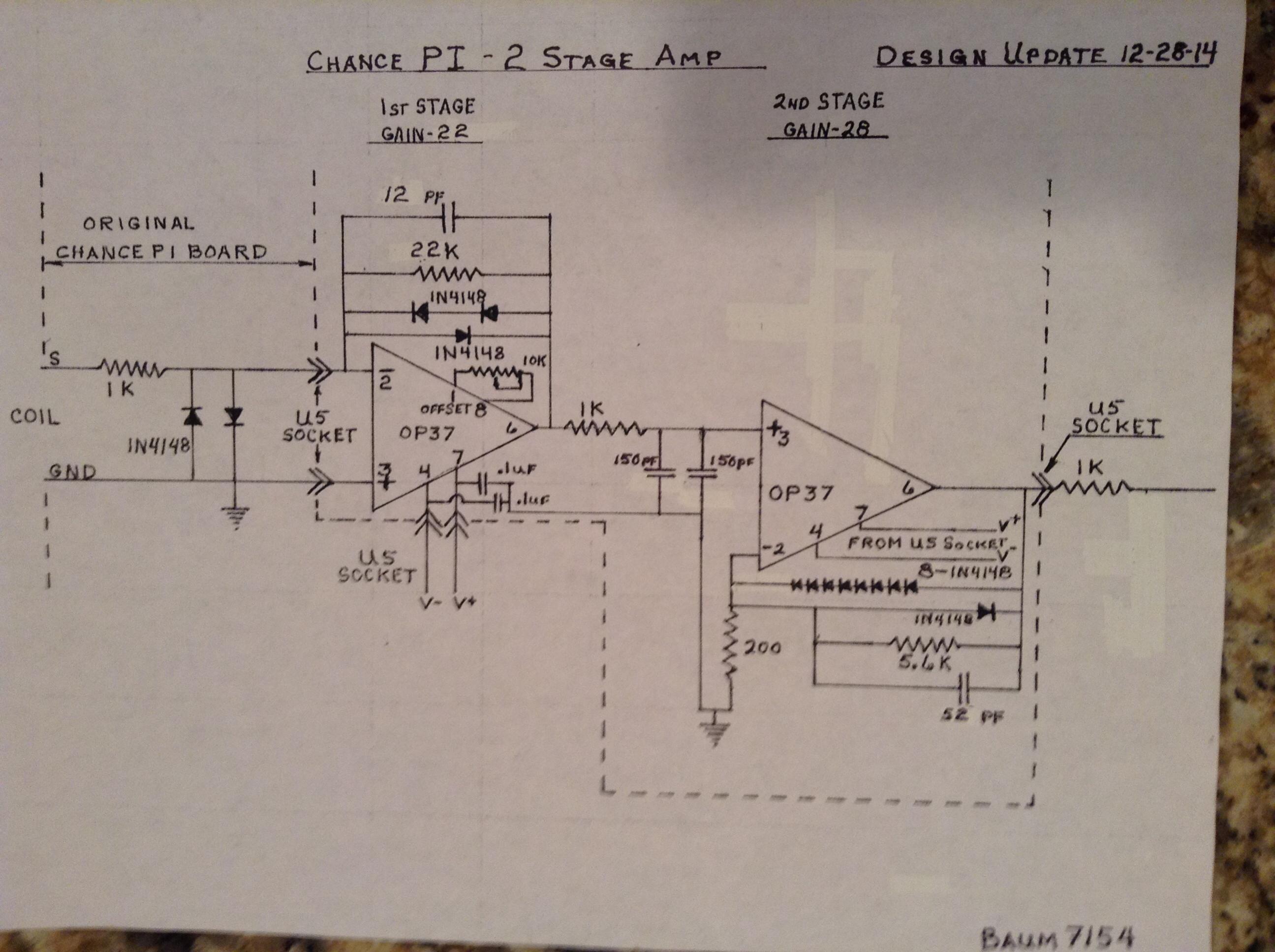

    • As promised here is the latest version of the 2 Stage Amp schematic. It is much simplified from the prototype posted earlier. There are 3 each 1st order 530 kHz filters in play but I am still unsure that this will be the final optimum cutoff frequency. Will post any more changes.
      • Trying to get this image rightClick image for larger version

                  • Originally posted by smity View Post
                    baum7154, аs the trials progress "dual amplifier"? Draw the last option please improvements "chance." I want to upgrade your MD.
                    The latest drawing of the current 2 stage amp you requested has been submitted in Post 243. Sorry I didn't make it clear in the text of that post. Had some ​glitches in the first attempt that left the image upside down.
                    Dan

                              • Originally posted by baum7154 View Post
                                After testing with the 530 kHz filters on very small gold targets I decided to revert to the original 670 kHz filters. This is accomplished by changing three capacitor values as follows:
                                1. 12pf is changed to 10pf across the 22k feedback resistor in the 1st stage
                                2. 300pf (2 each 150pf in parallel) between 1st and 2nd stage is changed to 235pf (2 each 470pf in series)
                                3. 52pf is changed to 41pf across the 5.6k 2nd stage feedback resistor.
                                Dan
