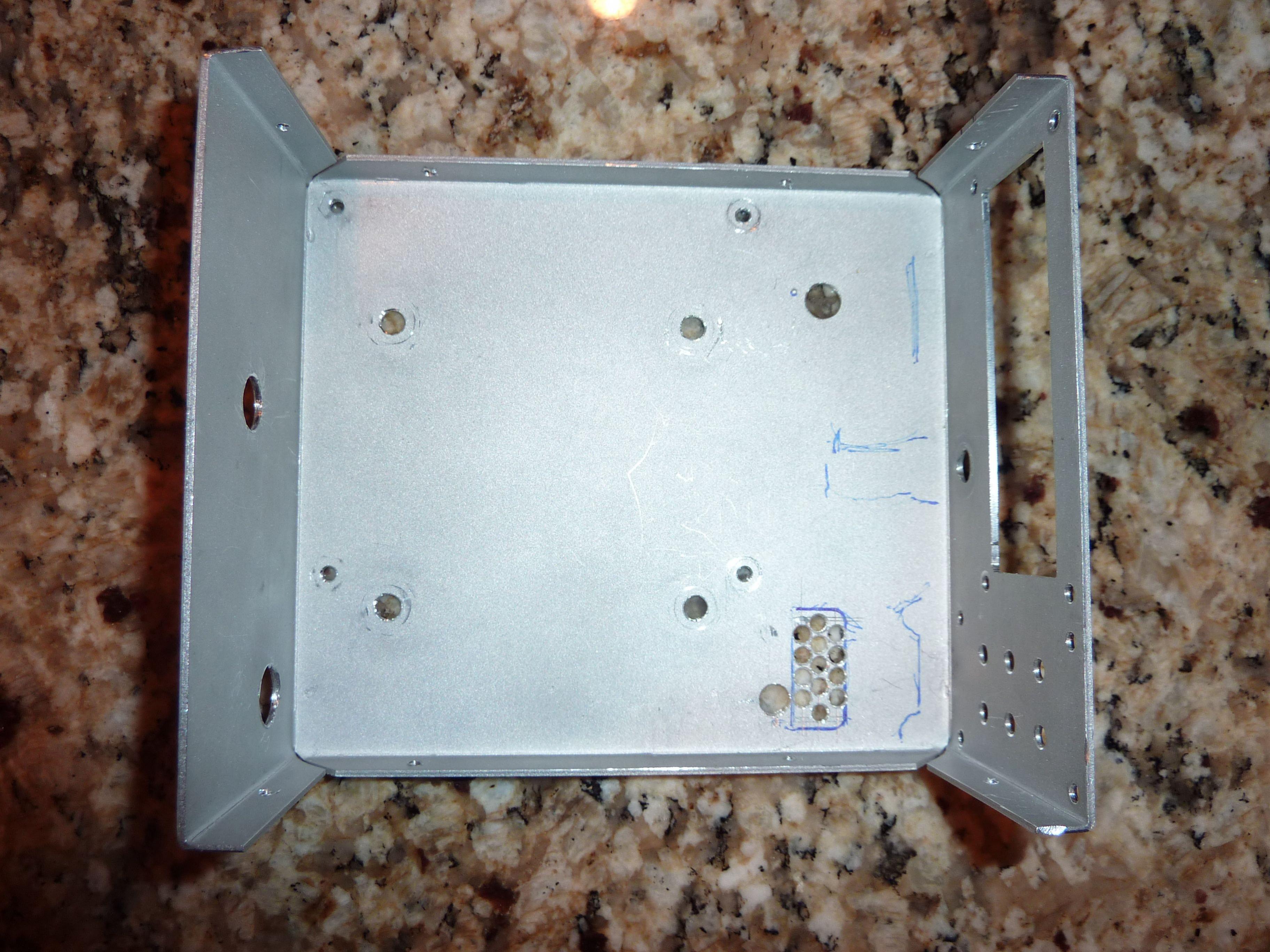

    Attached here are JPEG pictures of my CHANCE build with descriptions of construction:

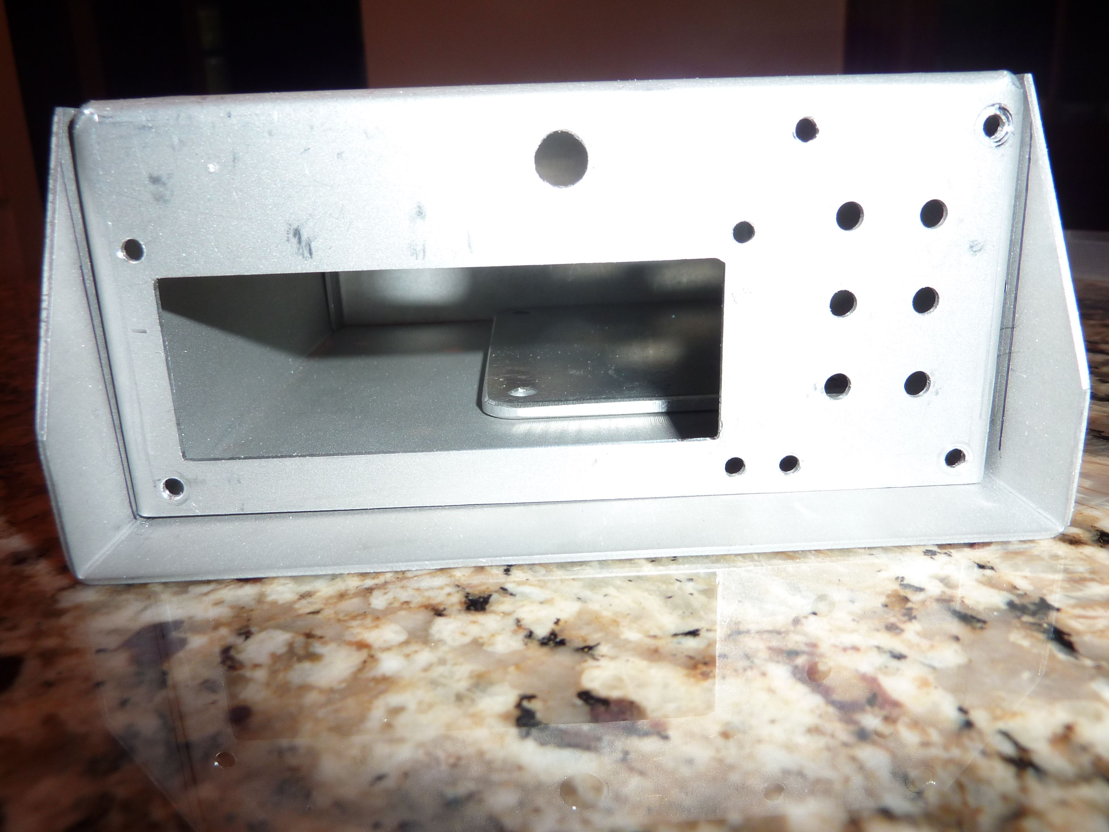

    These two pictures are of the enclosure made of .050 aluminum after machining of the front panel, ready for prep & painting.
ID:	338976Click image for larger version

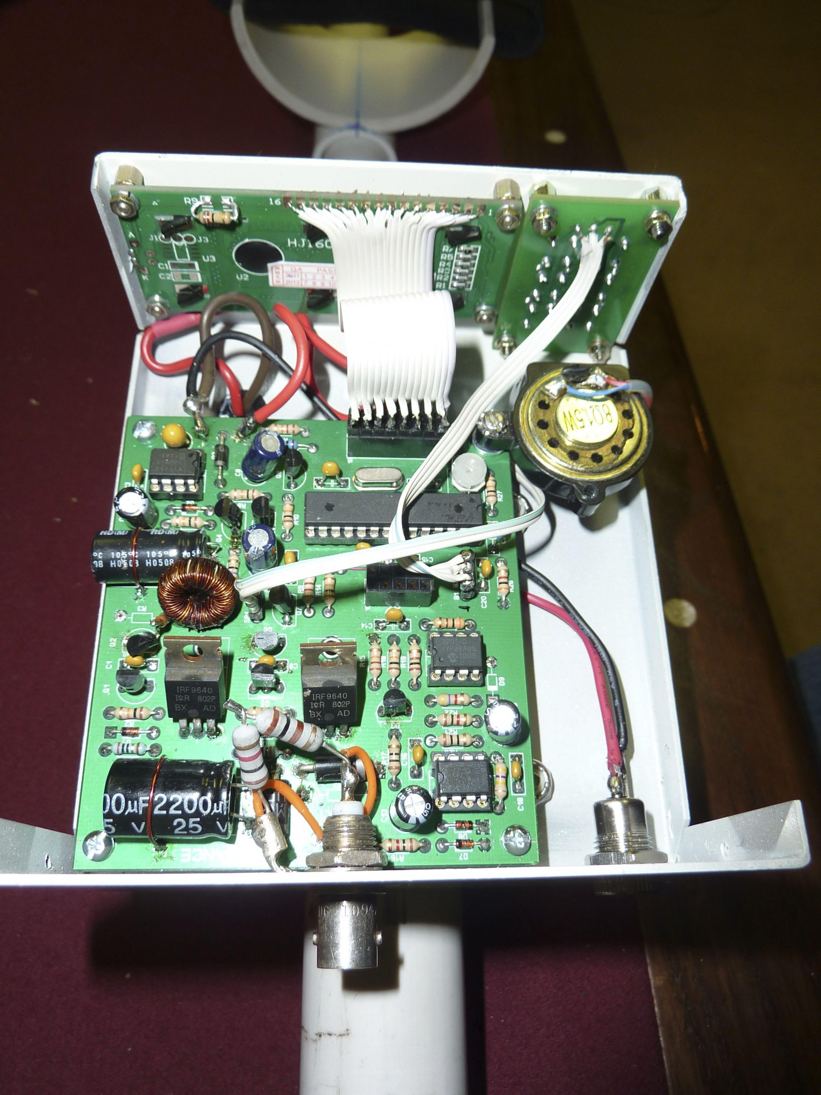

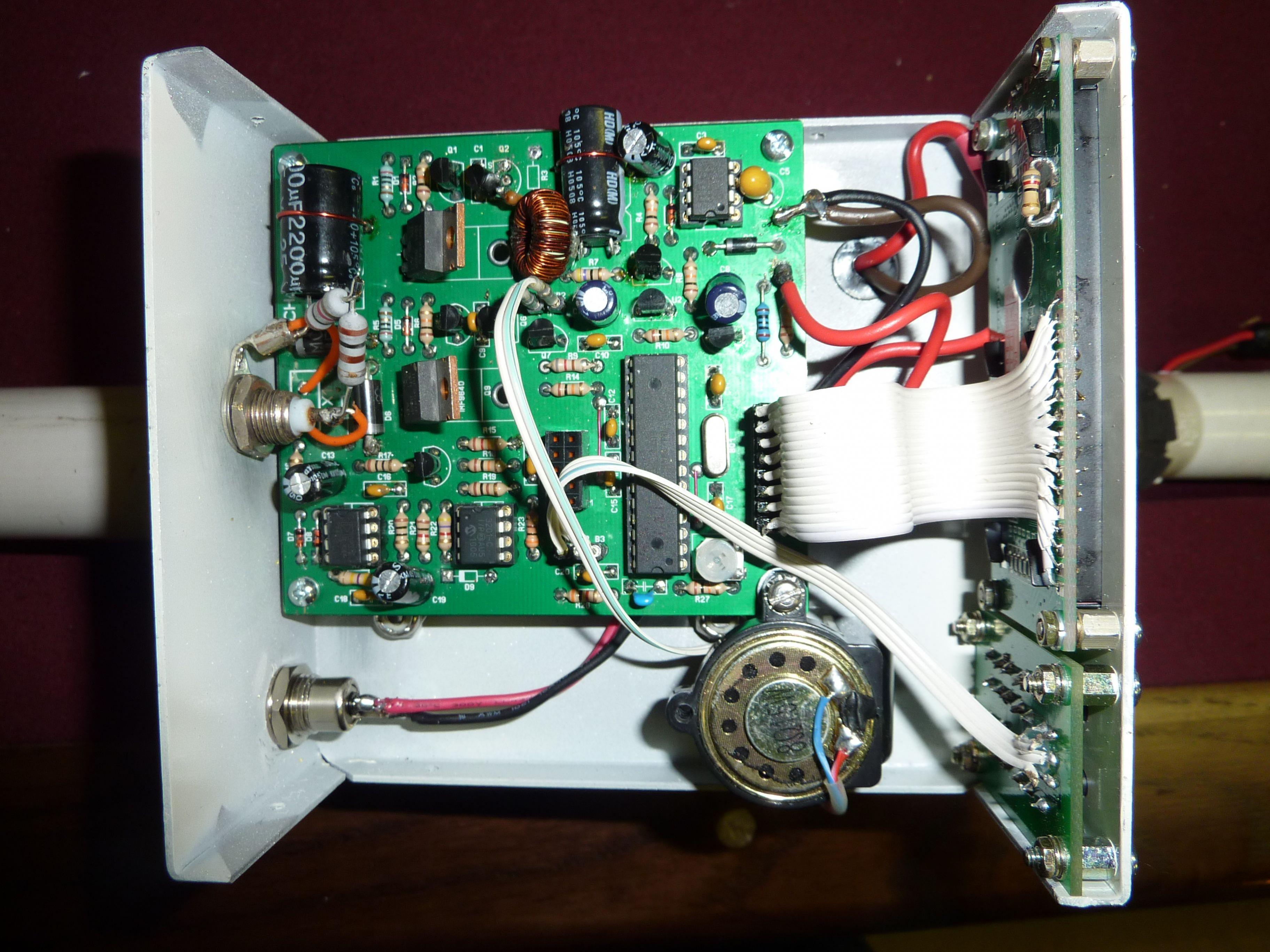

    These two pictures are of the electronics installed in the enclosure
ID:	338978Click image for larger version

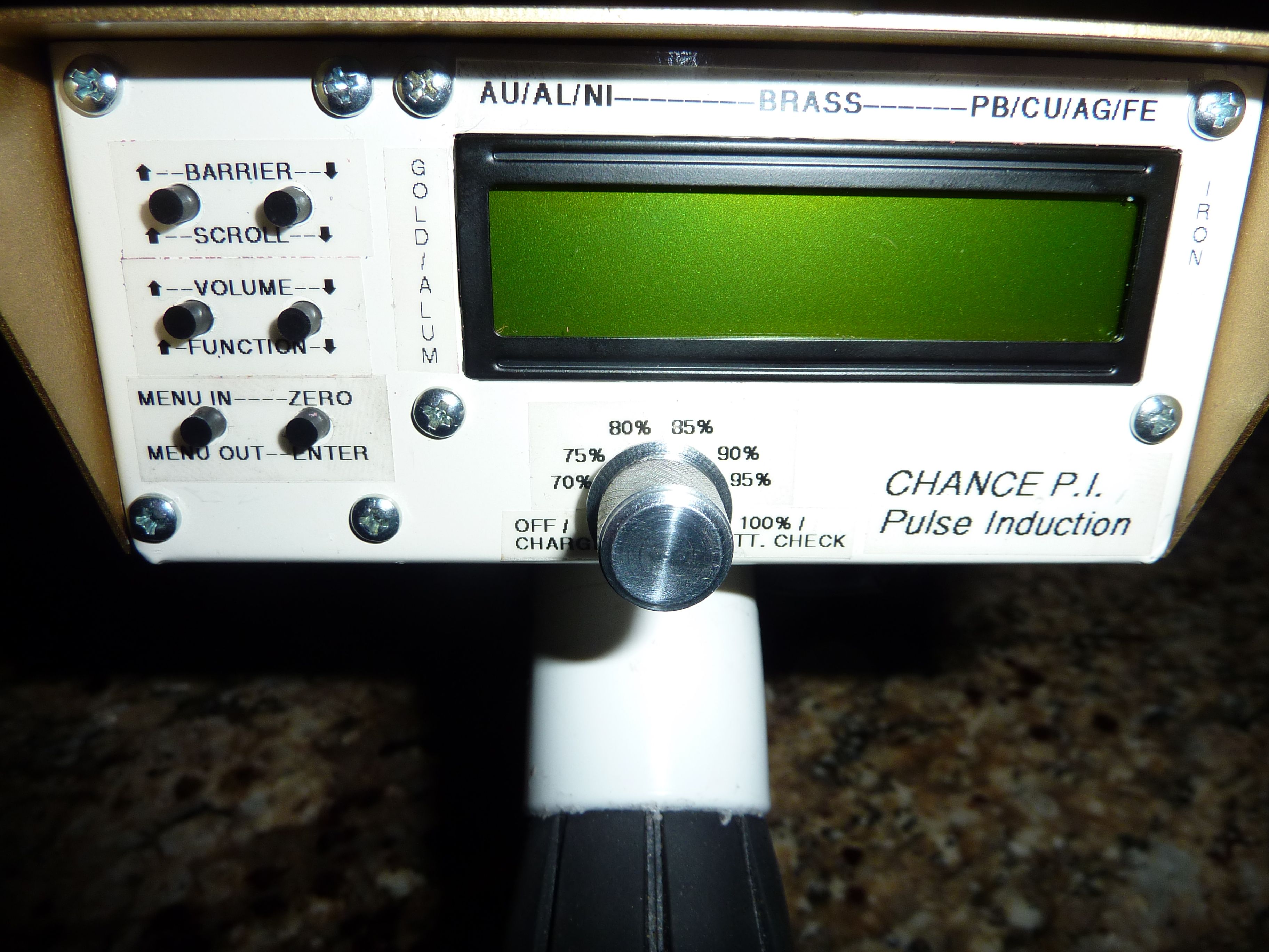

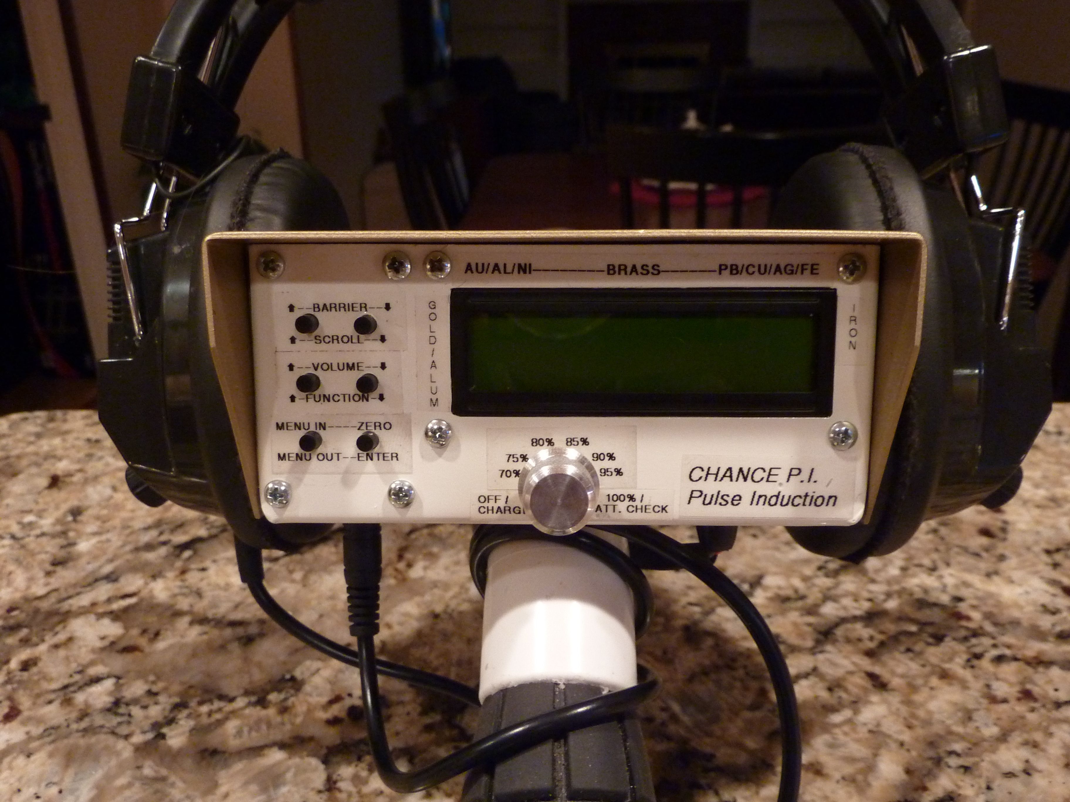

    These two pictures are of the front panel of the enclosure

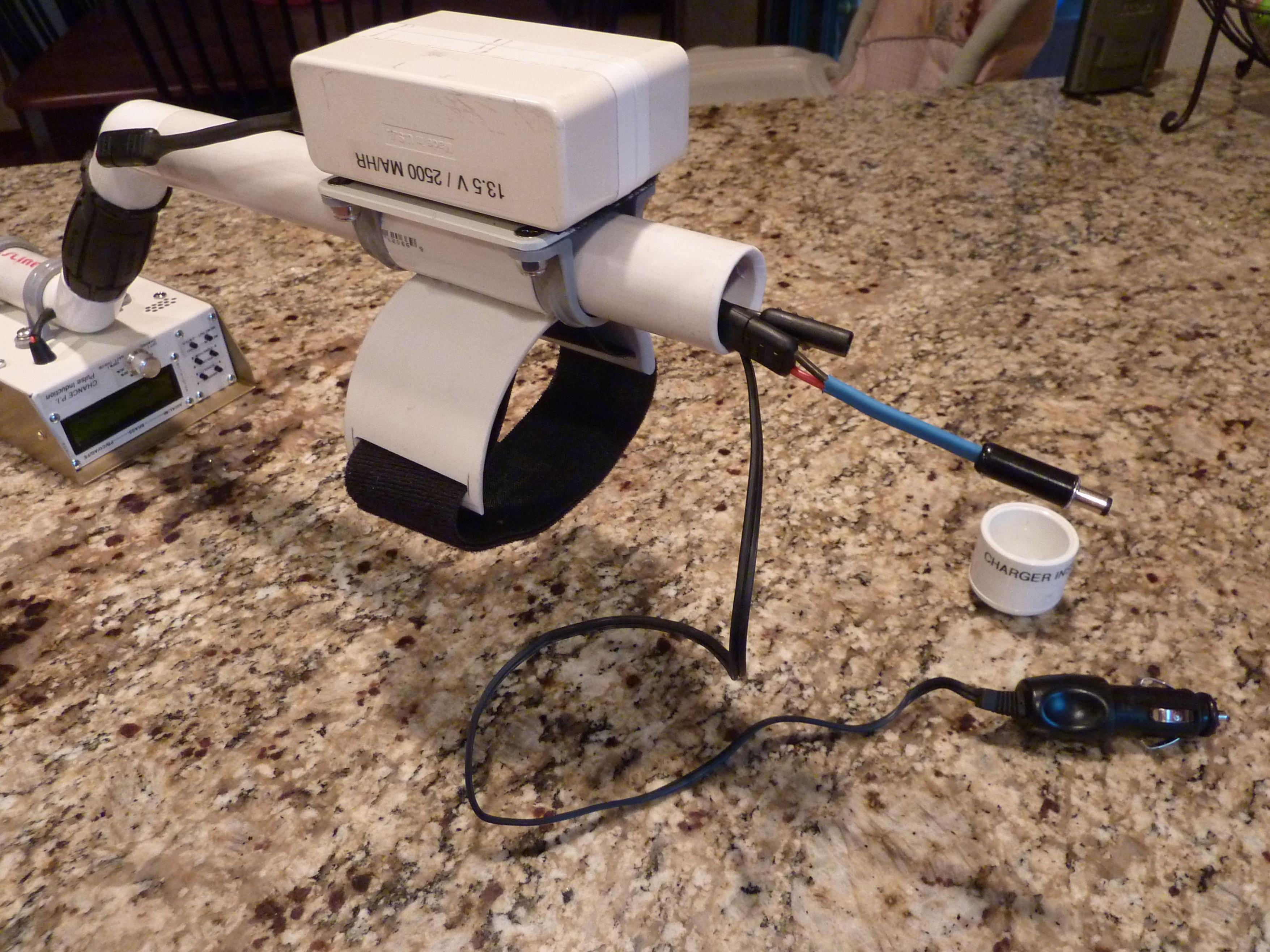

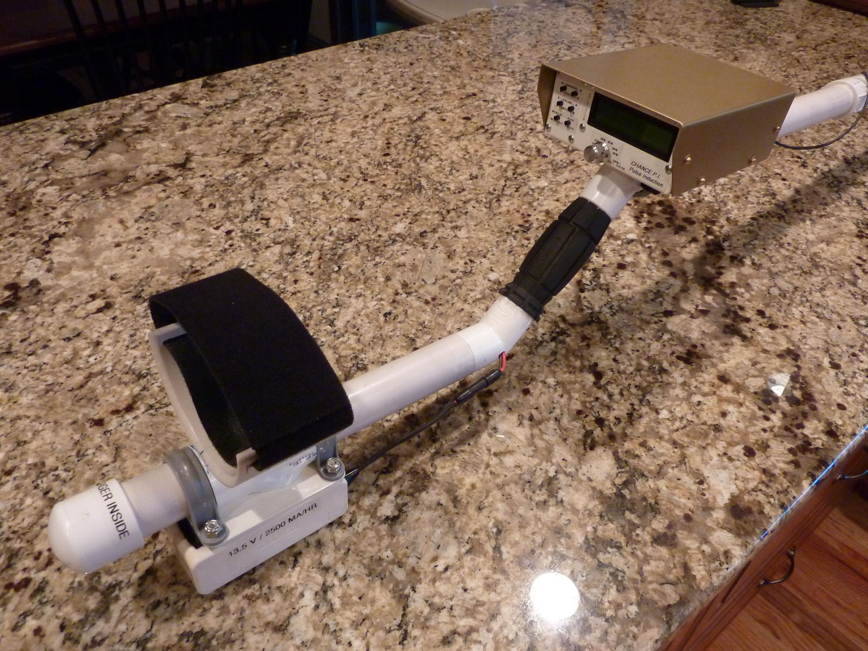

    This photo is of the rear handle assembly showing electronics enclosure, rechargeable battery, and PVC handle with arm saddle

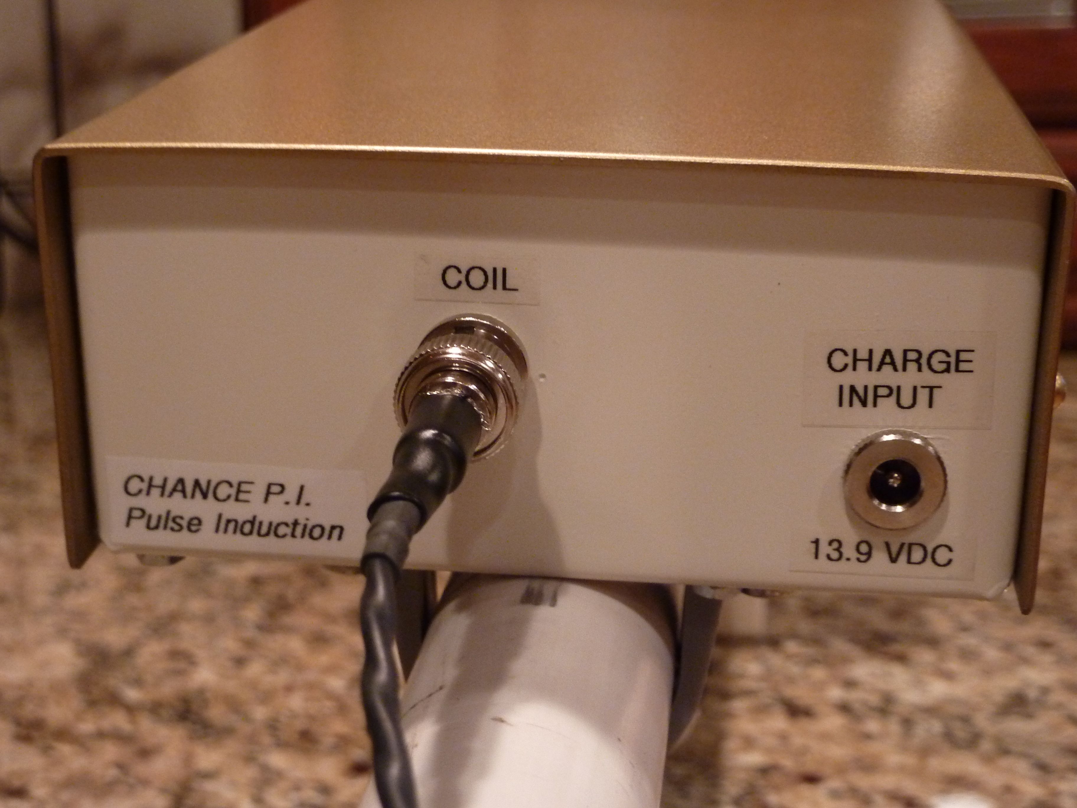

    This photo is of the rear of the electronics enclosure showing the coil connection and charge jack

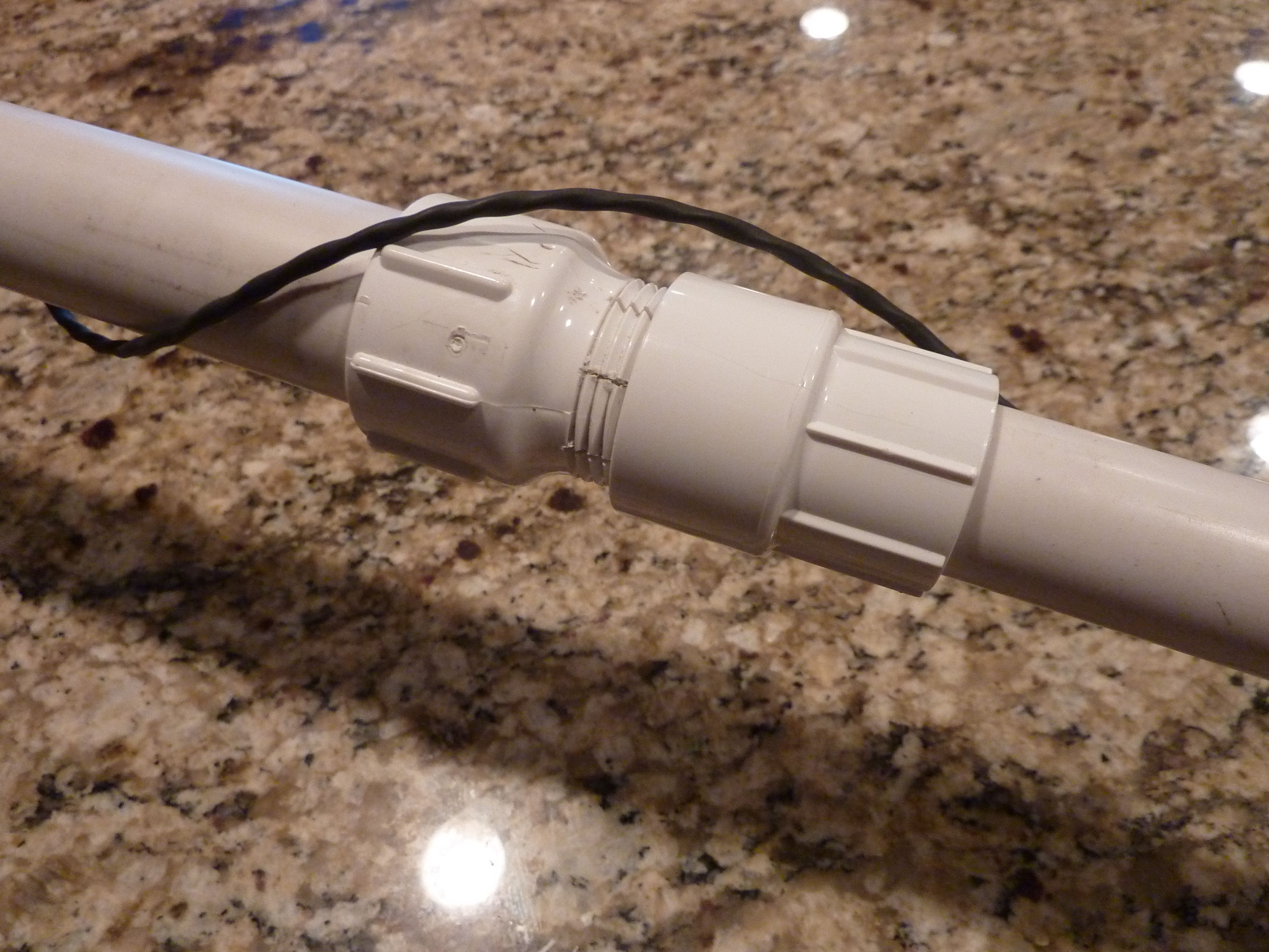

    This photo is of the telescoping boom clamp made of a pipe tapered/threaded PVC union. You can see the saw slits in the threaded section that allows this to act as a collet when tightened

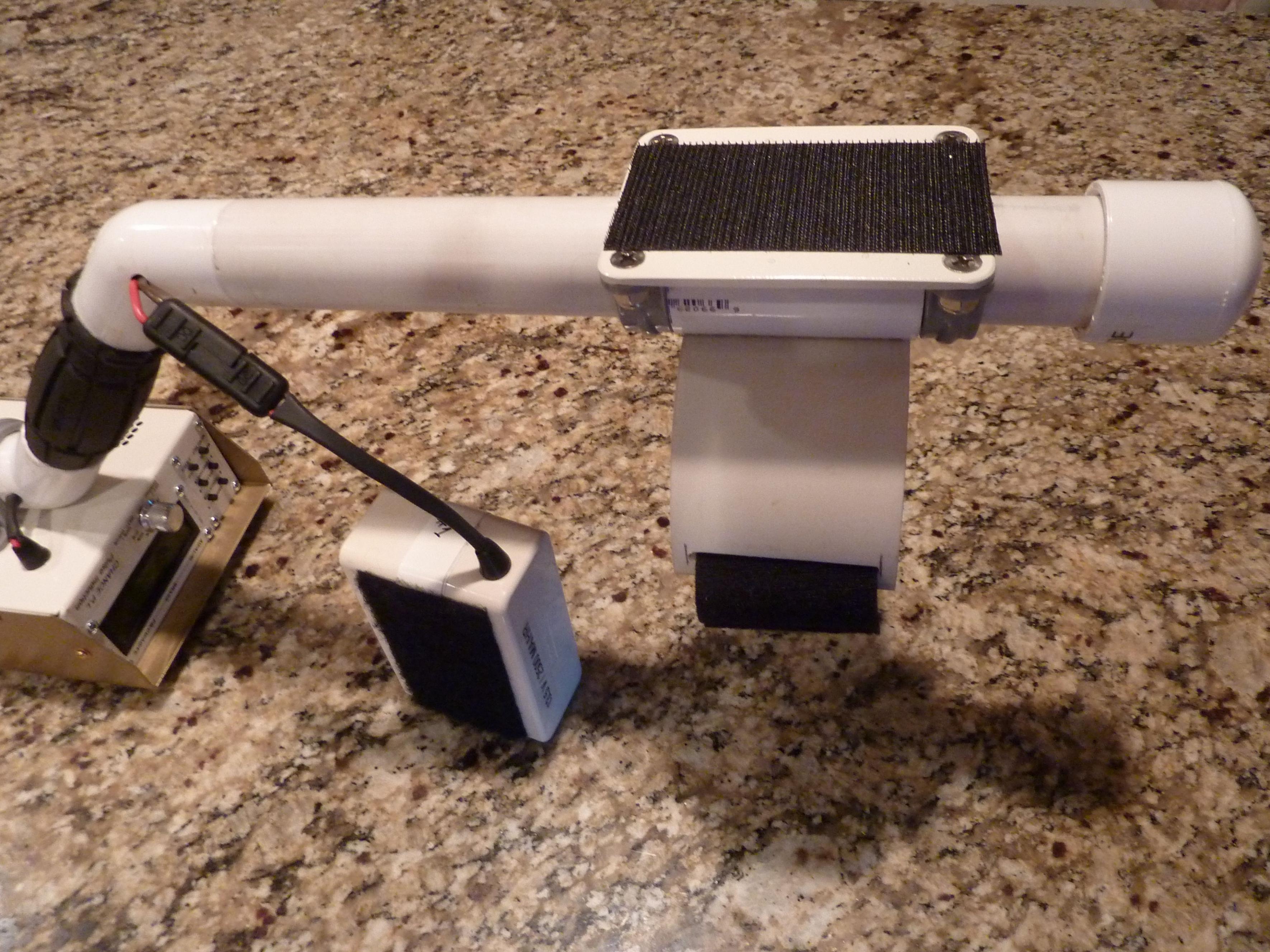

    This photo shows the rechargeable 12 volt NIMH battery detached from it's Velcro on the mounting plate beneath the arm saddle
    More photos in the next post
      This photo shows the battery pack installed and the car charging cord that is stored behind the end cap of the hollow PVC handle. The charging cord plugs into the rear jack of the enclosure.

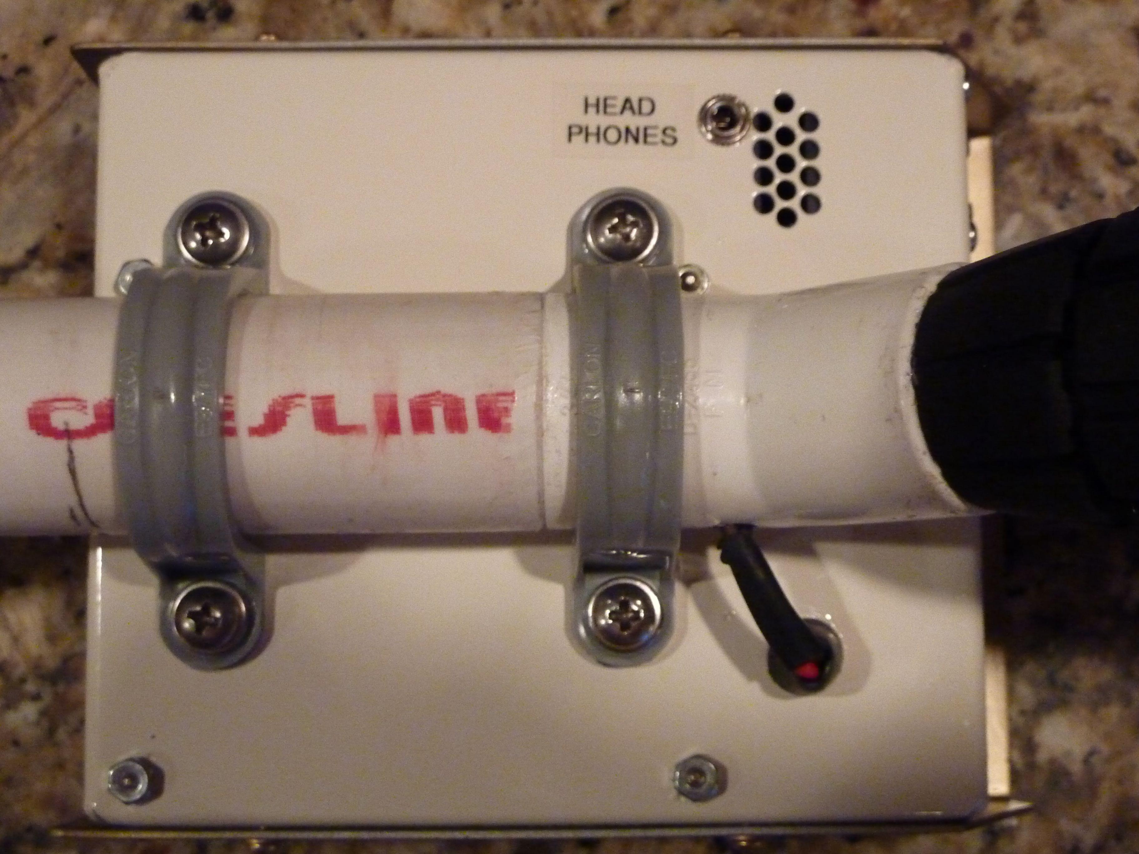

      This photo shows the underside of the enclosure and the boom attachment using PVC electrical saddle clamps. Also visible here are the internal speaker port and the headphone jack that cuts out the speaker when a plug is inserted into it. Note there his plenty of headphone audio drive at an audio setting of '1'.
      This photo shows the headphones plugged into the jack on the underside of the enclosure. This arrangement keeps the plug out of the way and protects it.

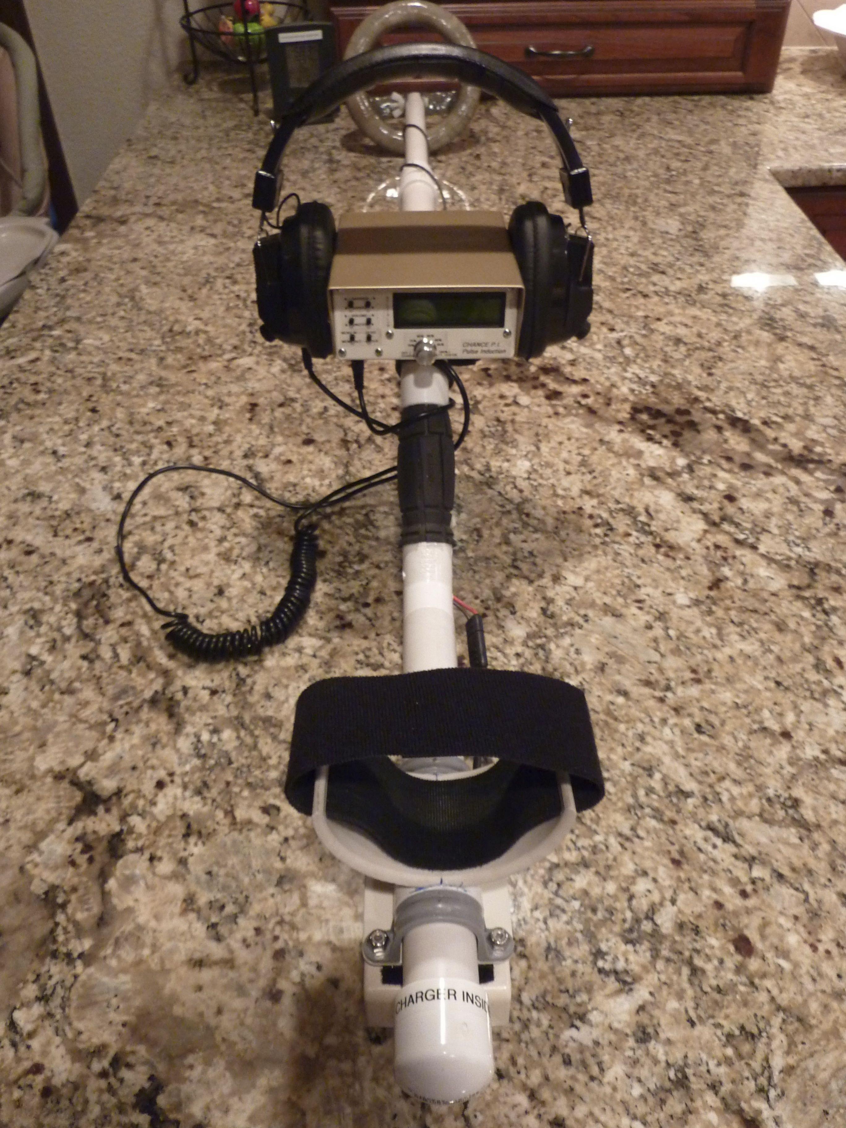

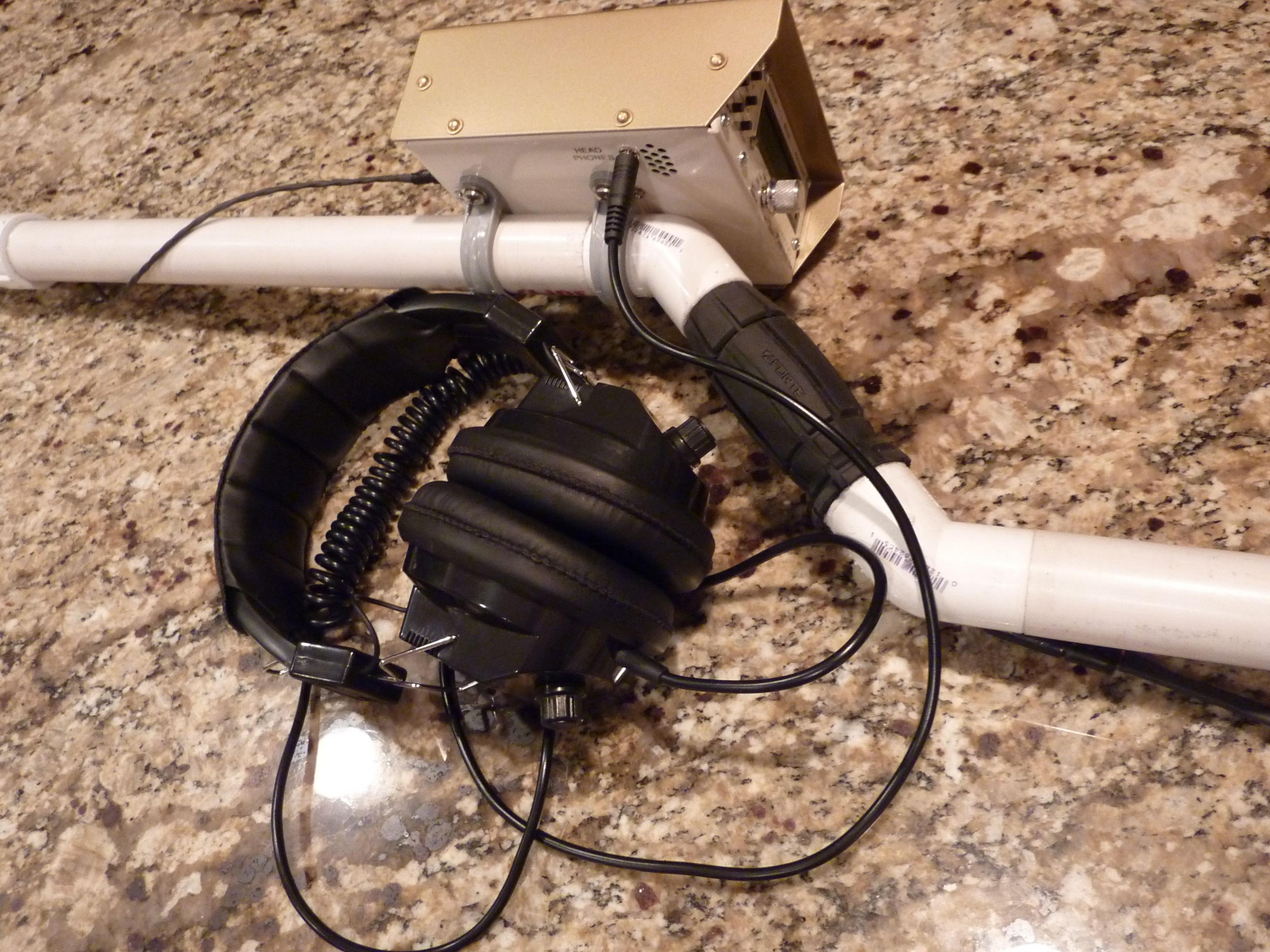

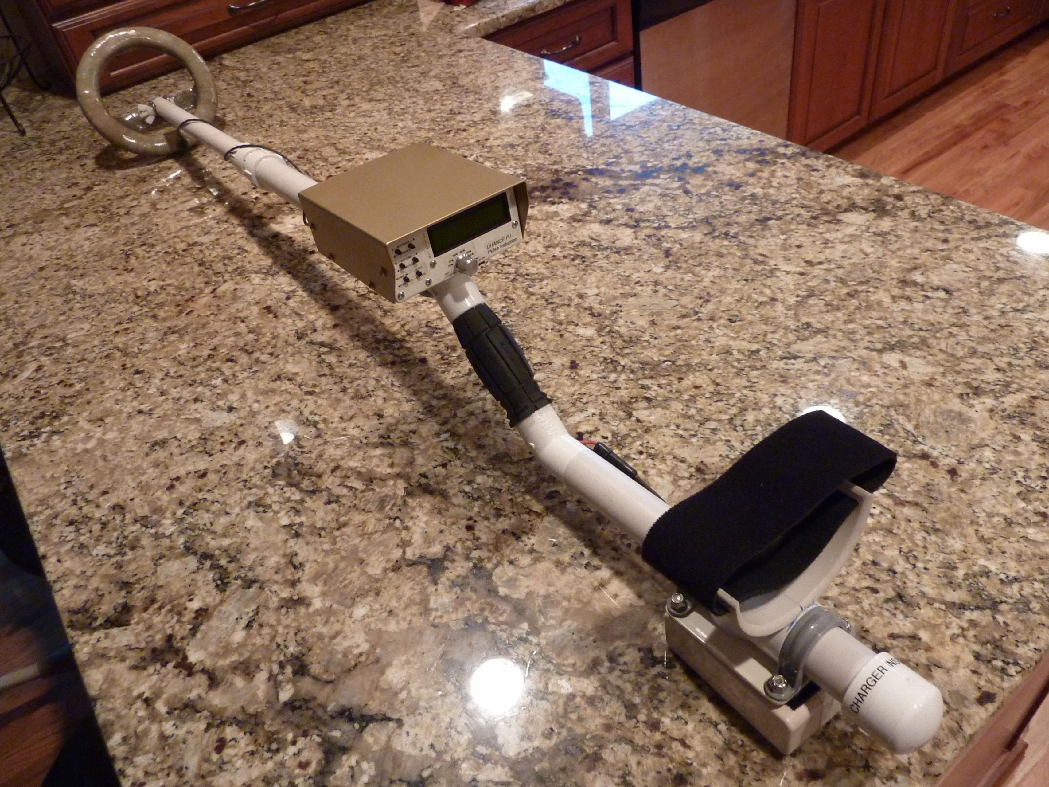

      These two photos show the overall view of the detector
ID:	338989Click image for larger version

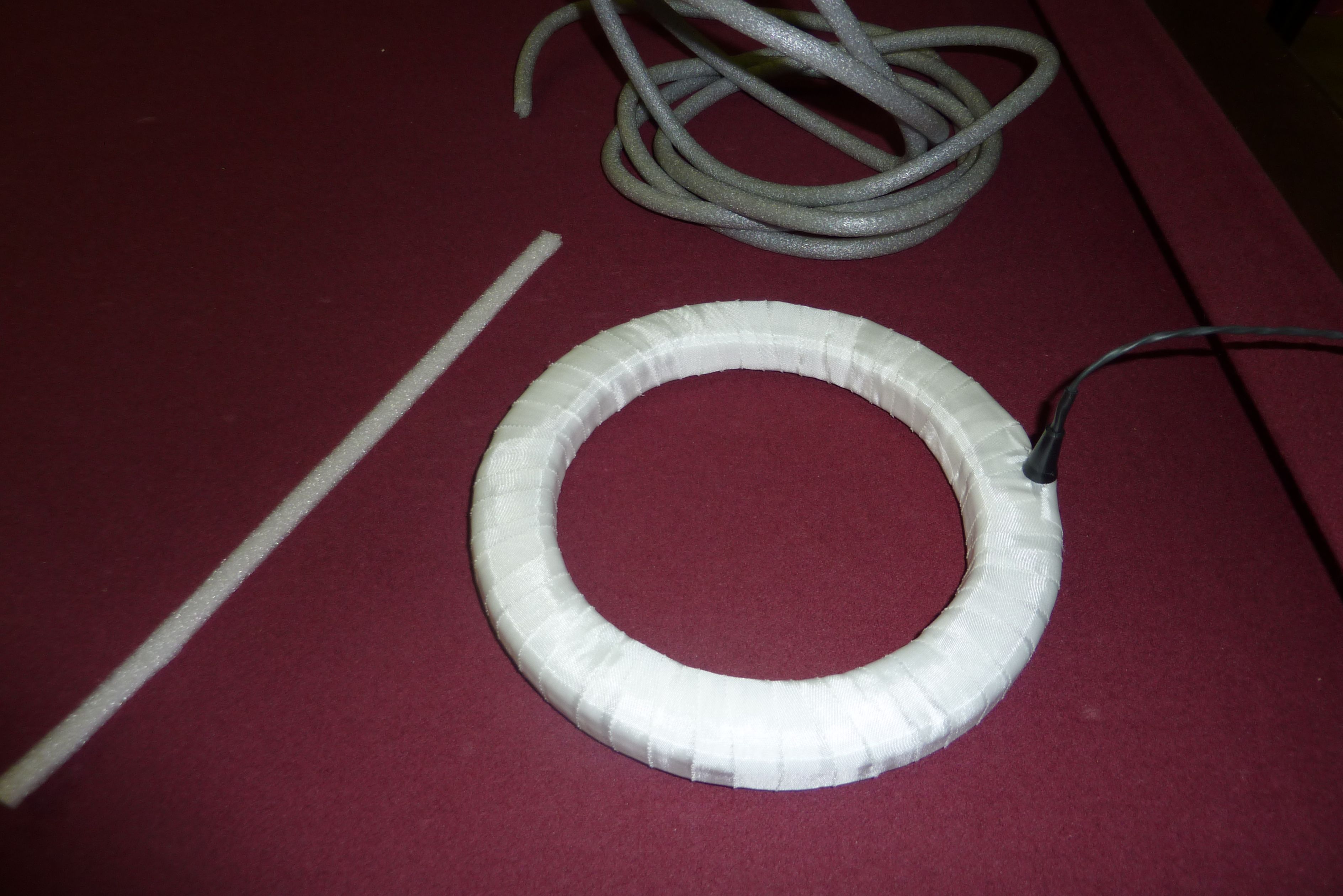

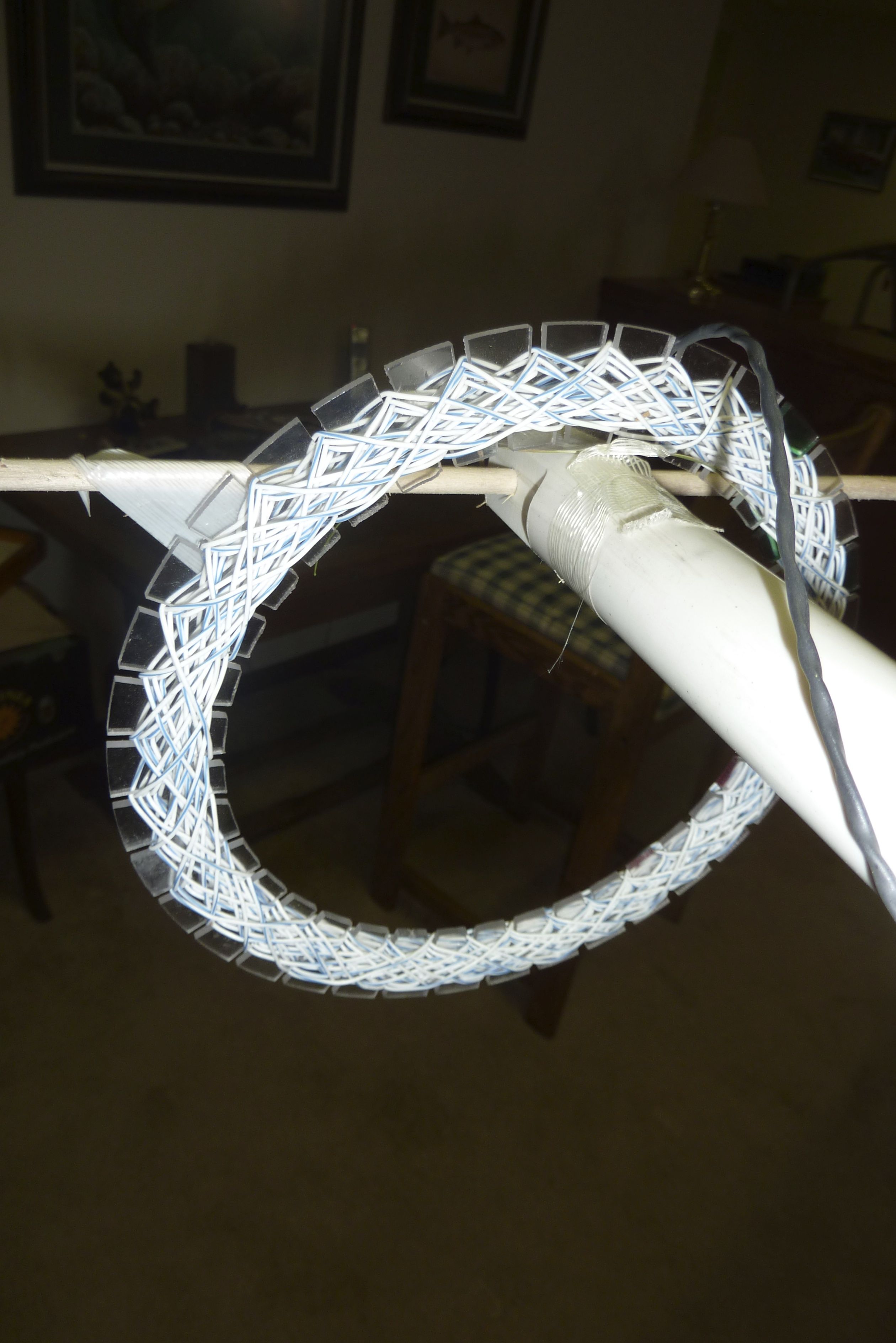

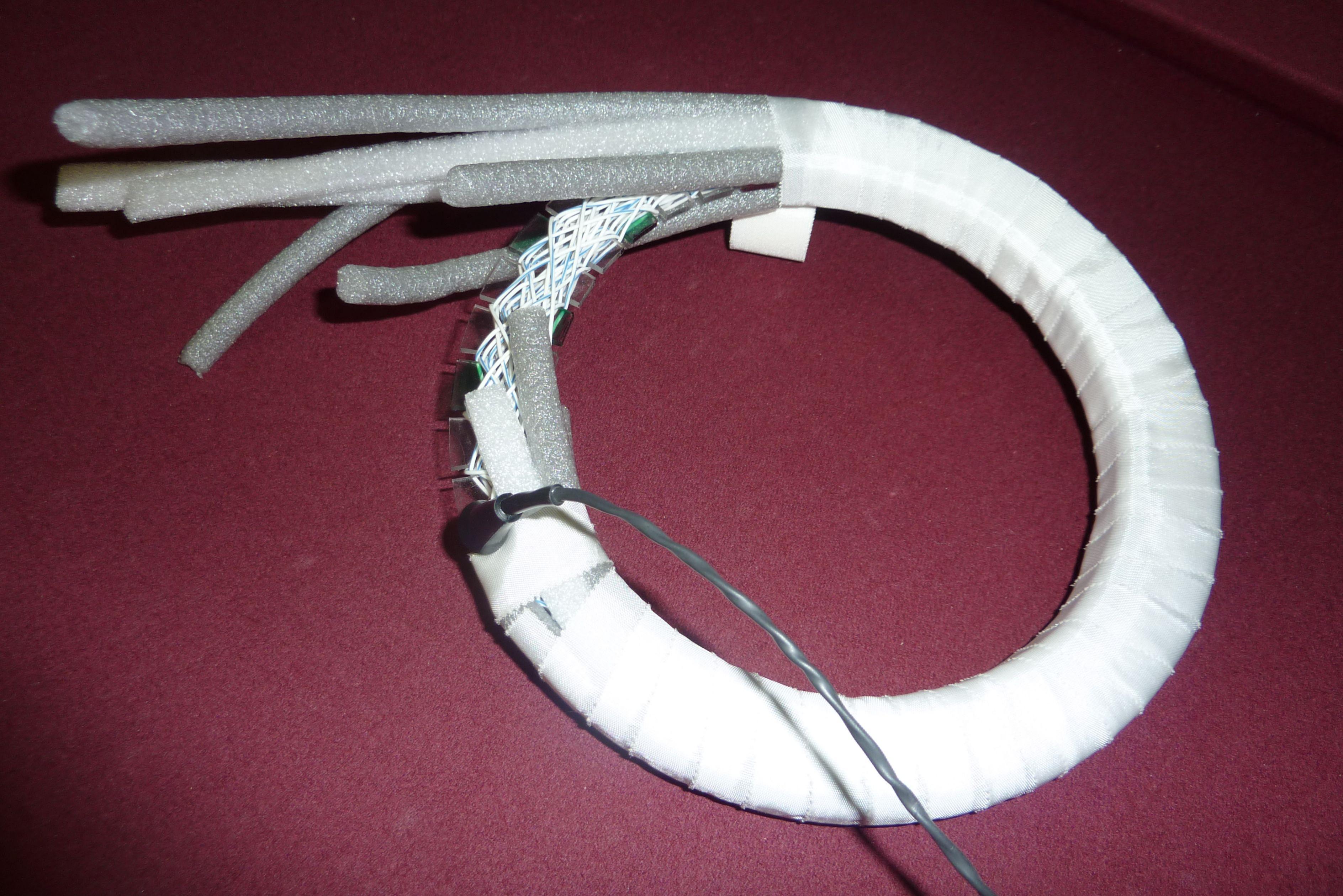

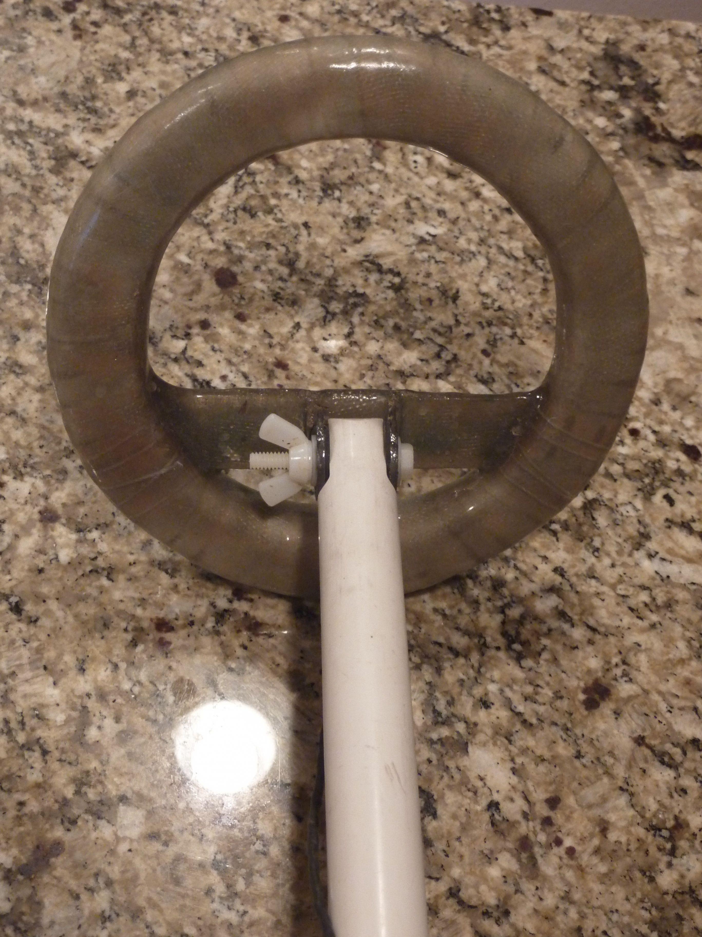

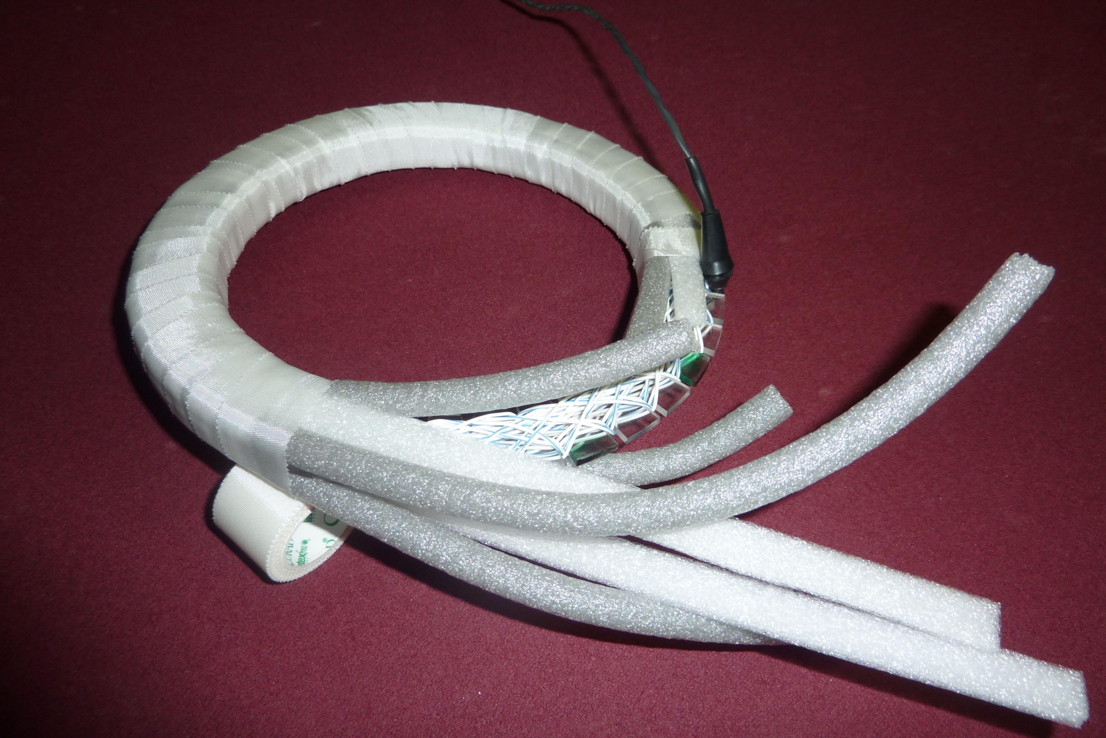

      These photos are of the 8" fast spider coil in various stages of construction. Details of this coil have been posted in the COILS forum under the title of CHANCE PI COIL.
ID:	338991Click image for larger version
ID:	338992Click image for larger version
ID:	338993Click image for larger version
ID:	338994Click image for larger version
        Took this coil on my CHANCE out today and buried a 10.8 grain piece of dental gold in a hillside at my prospecting site. Was able to detect the piece at a depth of 4.5 inches with a signal strength of 5 units and a solid ID of 'Gold' on the left end of the scale.
        Dan

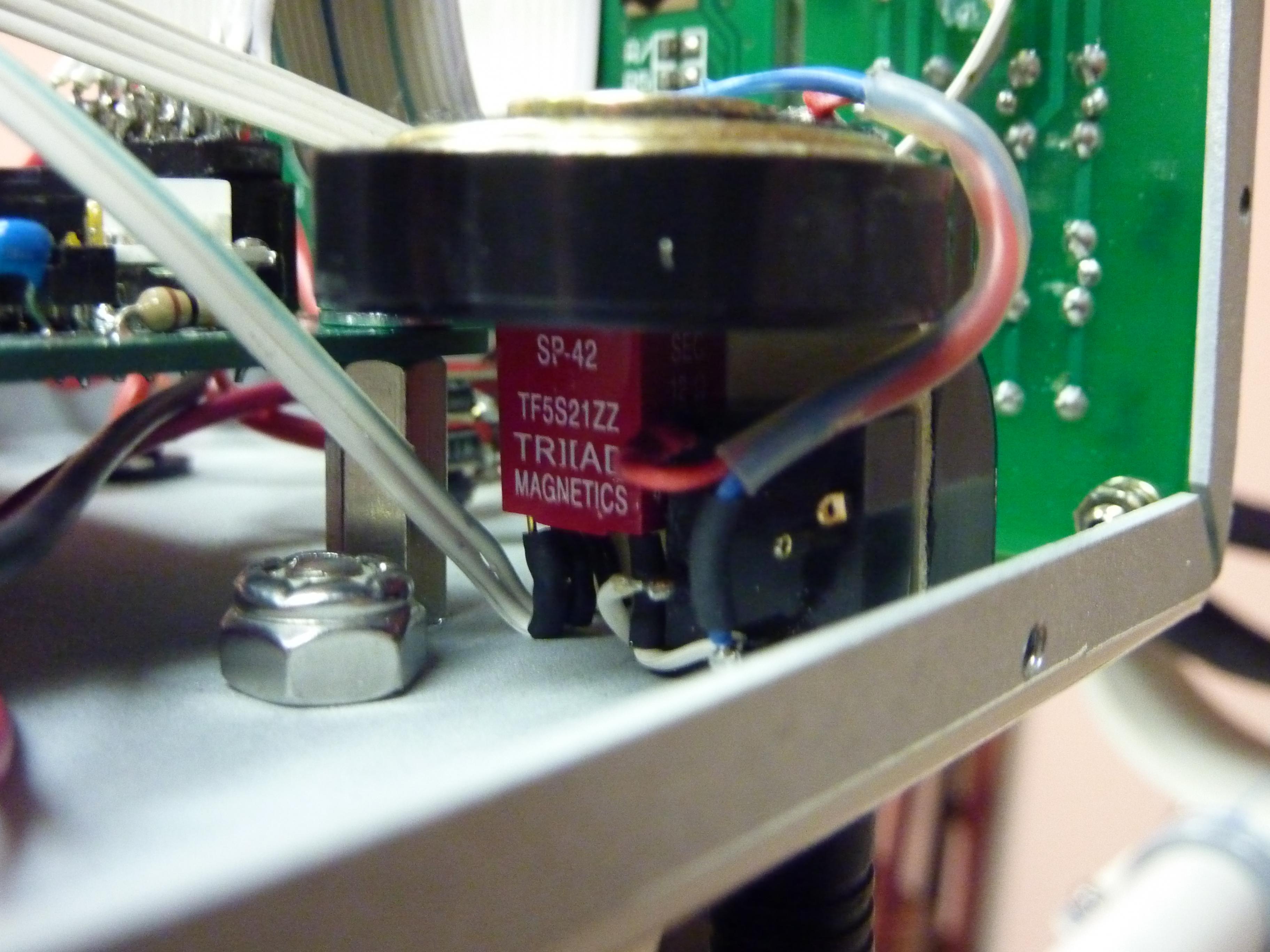

          AUDIO OUTPUT MODIFICATION
          The audio output of the CHANCE is designed to feed a device floating off of system ground. I wanted the option to use headphones or the internal speaker. It is no secret that phones are much superior and I hear more nuance in the audio when using them. The problem is that the audio output should not be tied to system ground but nearly all headphone jacks have the sleeve at ground.
          I found a TRIAD SP-42 miniature audio transformer nicely isolates the audio allowing it's 12 ohm secondary to be tied to ground on one side. It has a 50 mw power capability with a 150 ohm center tapped (75 ohm) primary and a 12 ohm secondary. The electronics wants to see 50 to 100 ohms on the primary so I used the 75 ohm center tap.
          I installed a 1/8"/3mm switched stereo jack from Radio Shack so that when the phone plug is inserted the speaker is cut off. The headphones I use are 16 ohm mono/32 ohm stereo, switch selectable with independent left and right volume controls. There is plenty of volume with the CHANCE volume set at '1' and the independent headset volume controls really help with keeping it at the best level for me.
          Dan

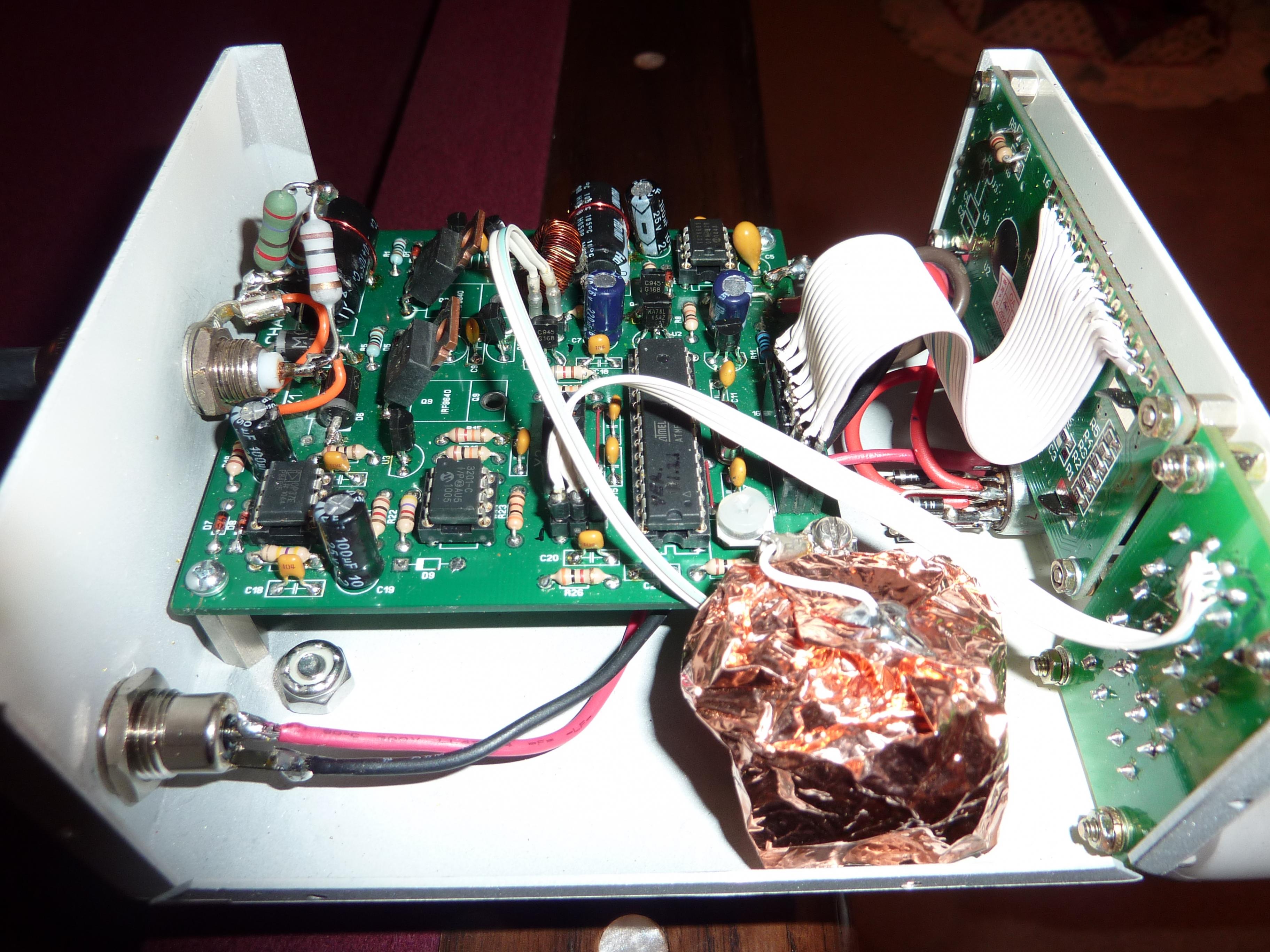

          I am posting some pictures of this transformer modification of the audio output to allow output grounding. Also there are some pictures of copper shielding I placed over the transformer and internal speaker assembly. It seems that at higher audio levels required when using the internal speaker that there was an increase in detector noise due to higher speaker drive levels.
          This image shows the speaker salvaged from an old LCD display with the transformer and switched stereo phone jack attached below it.
          This image shows the copper shielding foil over the speaker, transformer,and jack.
          Dan
            It goes to be a messy business. I have started to solder parts on Chance PCB and have noticed on that PCB just missed whole ground layer on the top.
            So I will have to make several wire jumpers to ground all components properly. Probably it was one of that epic failure PCB's from the first Cance with mistakes.
              Does the board you have incorporate the changes required for the VERSION 1.2.1 software? If not it is the older board for
              Version 0.8.4. and you will need to modify for the changes.
                Thank you. Anyway I will check all connections on board because they are 30% incomplete without top PCB layer then I will follow instructions for PCB and software updates from Andy website.
                  I recommend that you do not use the 220 uh axial lead choke L1 that was provided in the original kit. I wound one on a toroidal form using 26 AWG enamel wire. It has much better current delivery than the original.
                  Glad to see you have the OP37 amp as it is a much better device!
                  Dan
                    Dan
                    When ordering parts from Digikey I saw such toroidal choke 220uH for $11. So I have wound my own to save money using AWG24. Looks bulky but will drive current for sure.
                      Good decision that you will not regret!
