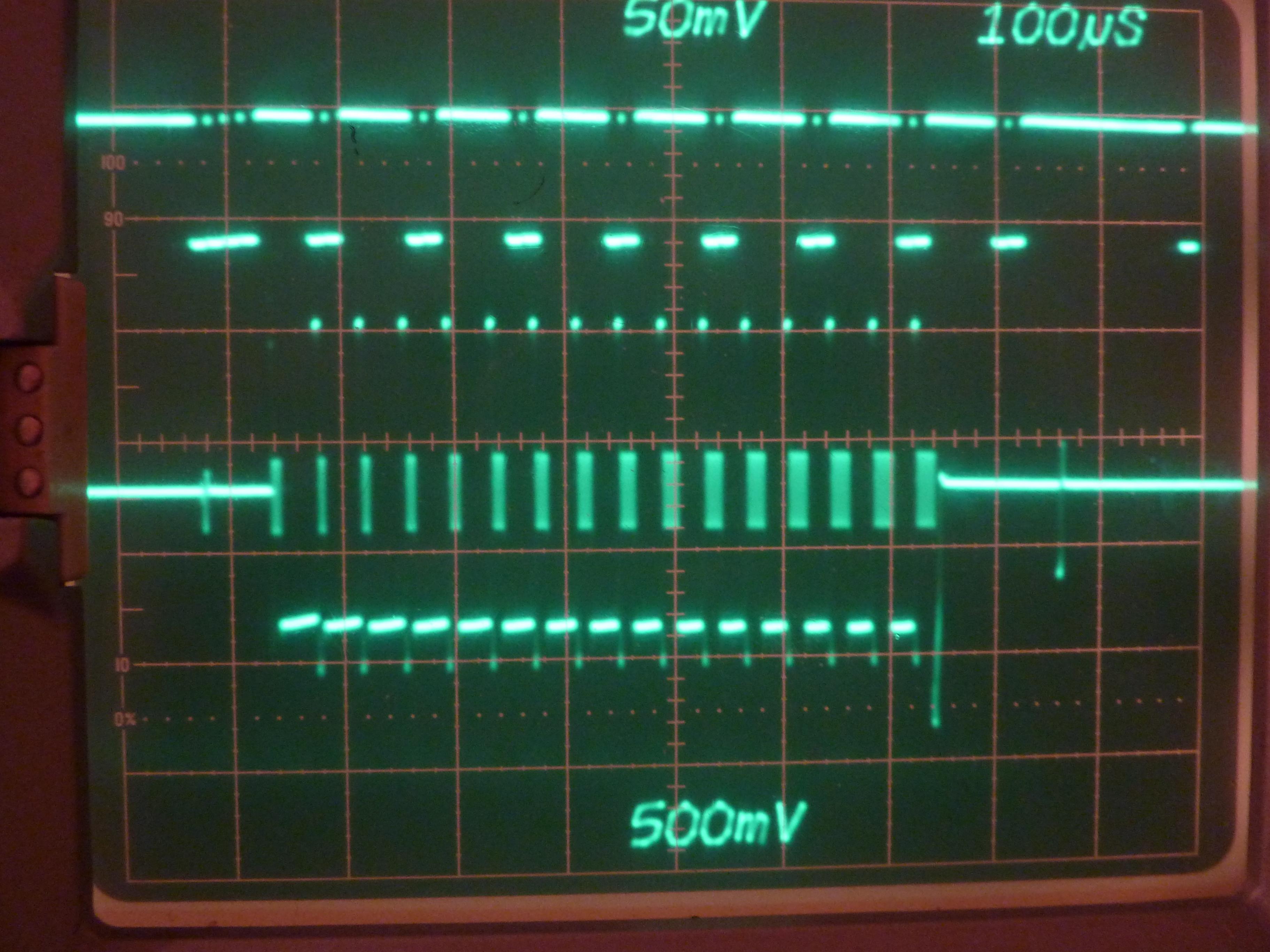

      A little more detail on the other A-D samples I saw. In the short pulse portion of the TX I think there were 7 groups of two samples evenly spread within the 15 short pulses. They came in pairs, each sample 12.5 wide, a 1us break and another 12.5 us sample for a total of 14 samples. I'll see if I can get a good picture and post it this evening.

        CORRECTION!!
        Was looking with the scope last night and counted the short pulses again. There are sixteen (16) short pulses in the string, not 15 as I said previously. Sorry for the misinfo.
        Setting critical damping on the scope while listening to the audio from the CHANCE PI shows that at the precise point where critical damping is met, the audio dramatically changes from a raspy buzz to melodical response. Pushing ZERO (RESET) at this point quiets it down and the detector damping is optimized. If you want to slightly overdamp you can add a small tweak to the pot. I will be adding a Variable Damping option to this detector assembly so that it can be optimized for different soils using the audio response in the field. No scope needed from what I have seen but will test in the field and post results here. This feature is also useful when changing from one coil to another.

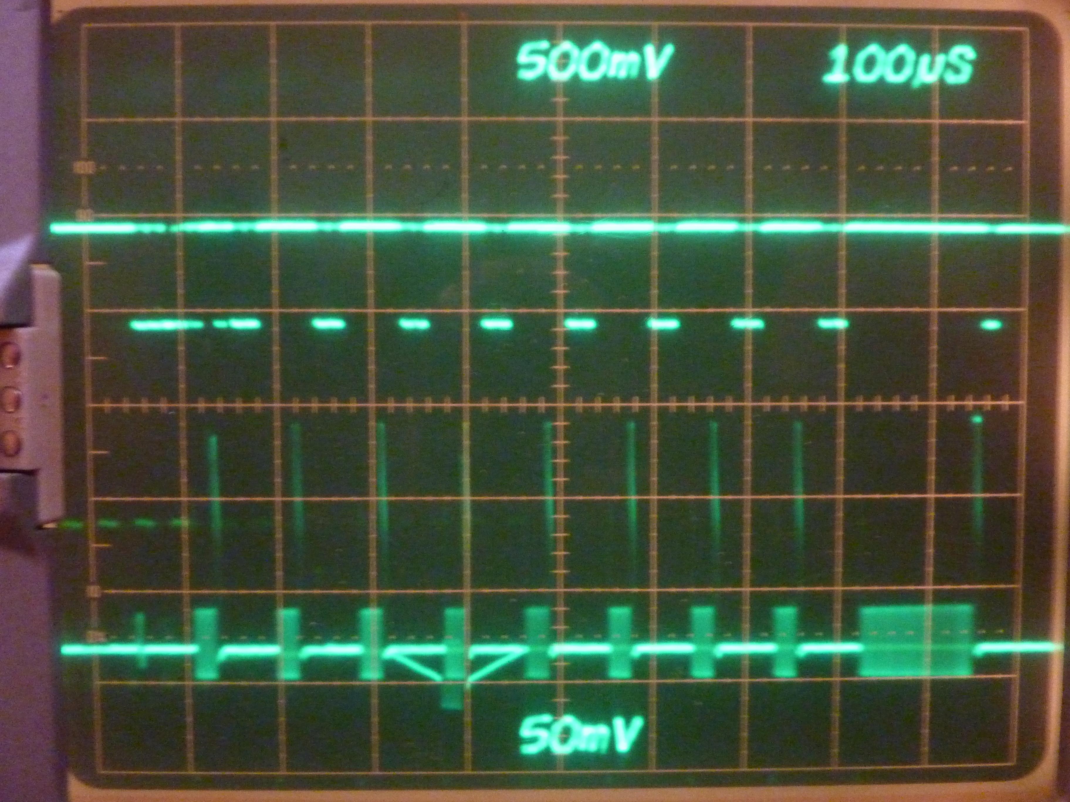

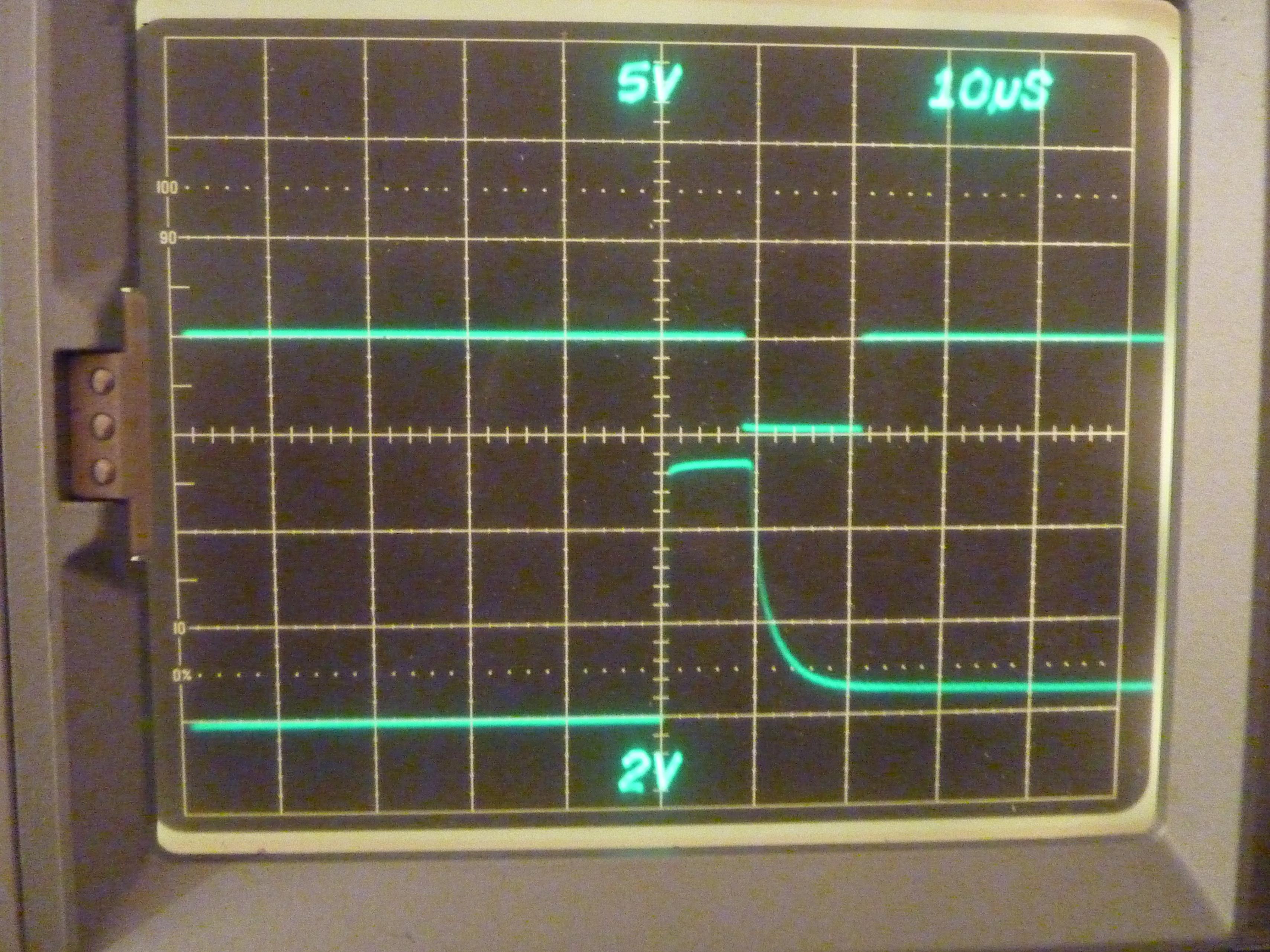

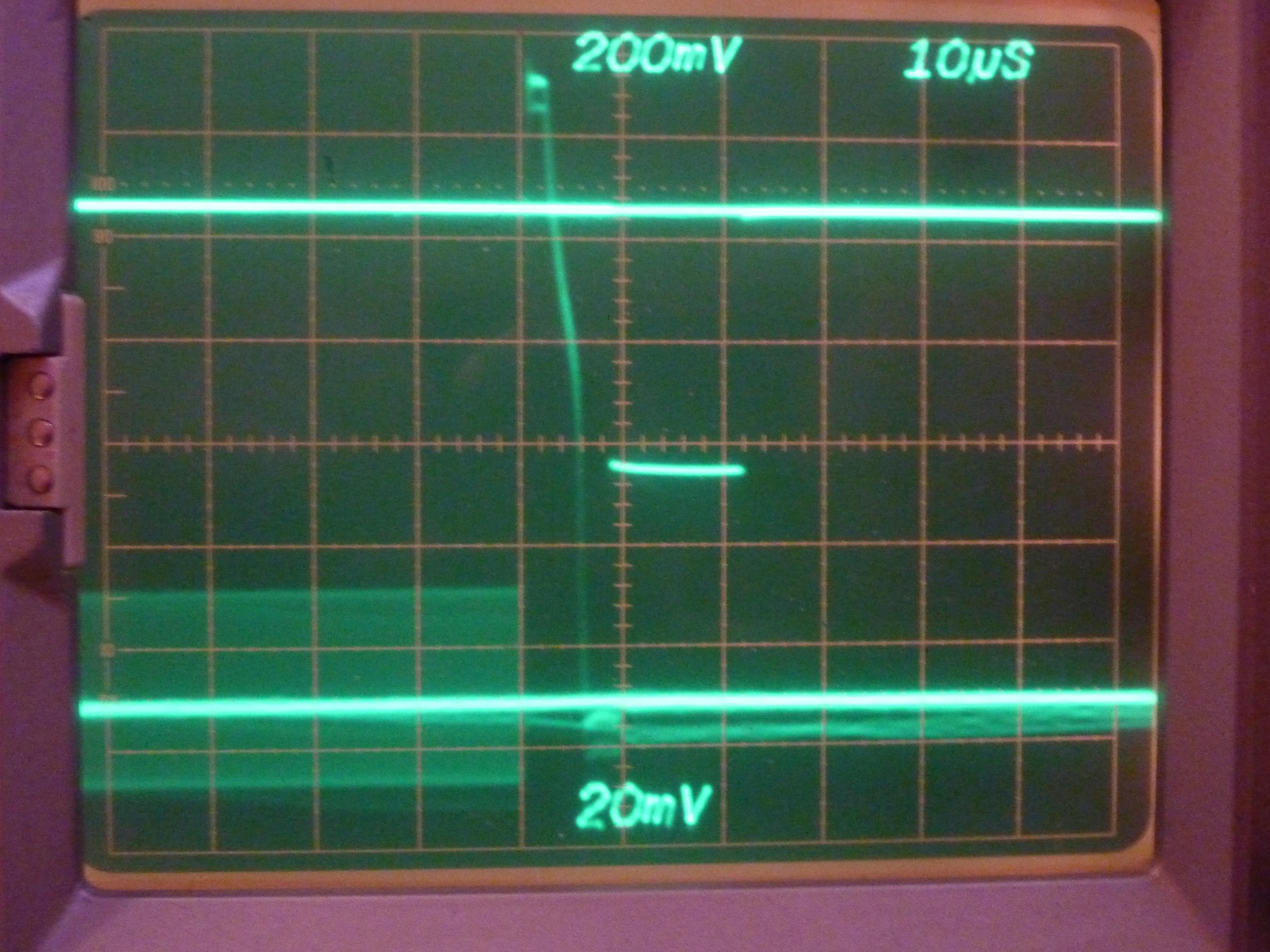

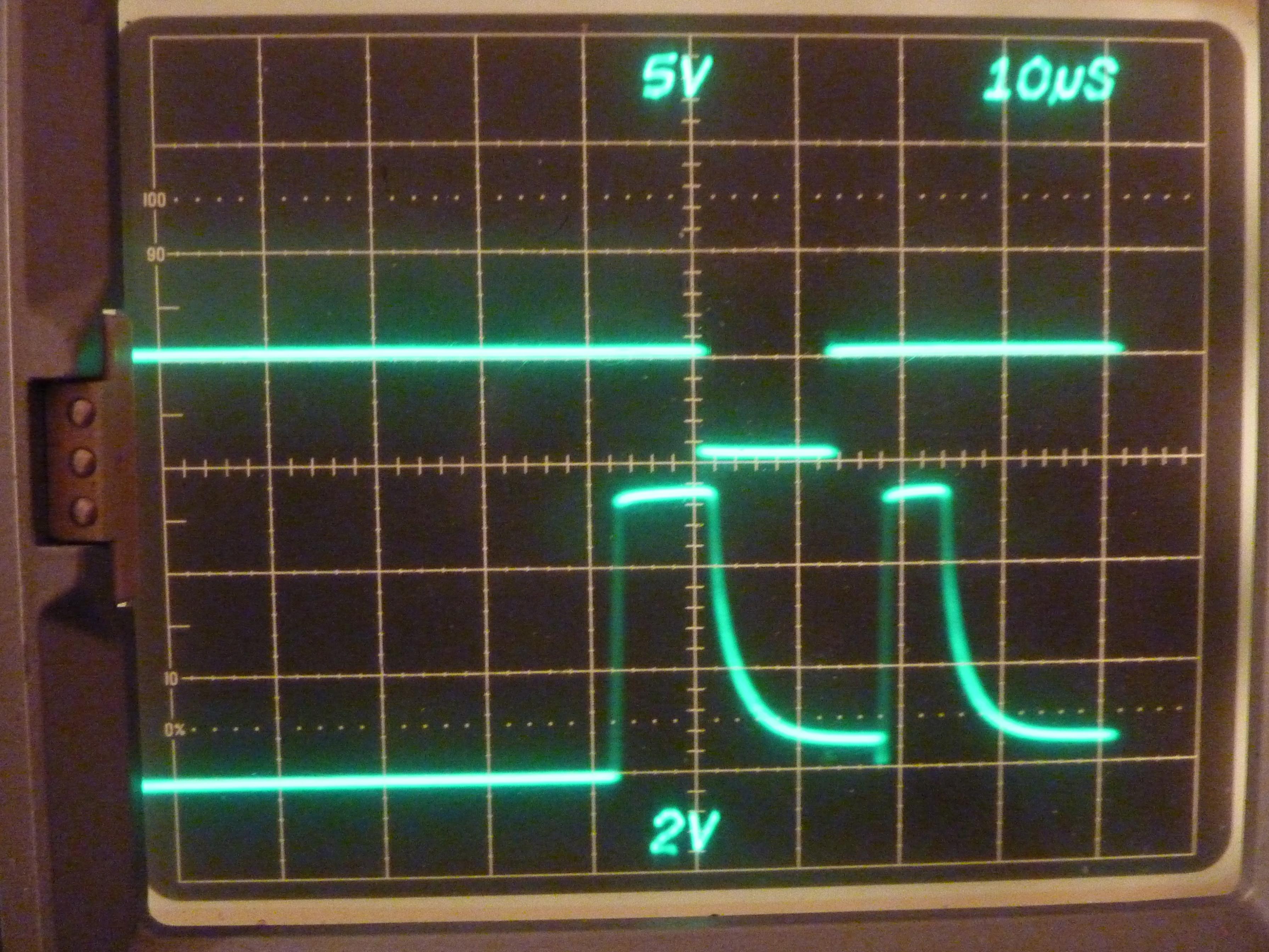

                  Attached here are some pictures with a description of each screen shot:
                  1. This picture is of the coil flyback measured at the diodes on the amp input. The horizontal line at midpoint is the A-D sample window

                  2. This picture is of the last of 8 short pulses and the 120us long pulse and coil flyback,again taken at the diodes. The Guard Interval moves the single A-D sample shown at the far right 0.9us for each increment of GI input. All others are unaffected by GI settings.

                  3. This picture is of the 16 short pulses with their corresponding A-D dual samples in the 2nd horizontal row from the top.

                  • #54
                    Thanks for the photos. Looking at jpg no. 5 the sample goes low while amplifier out is saturated. I must be wrong about how the A-D works.

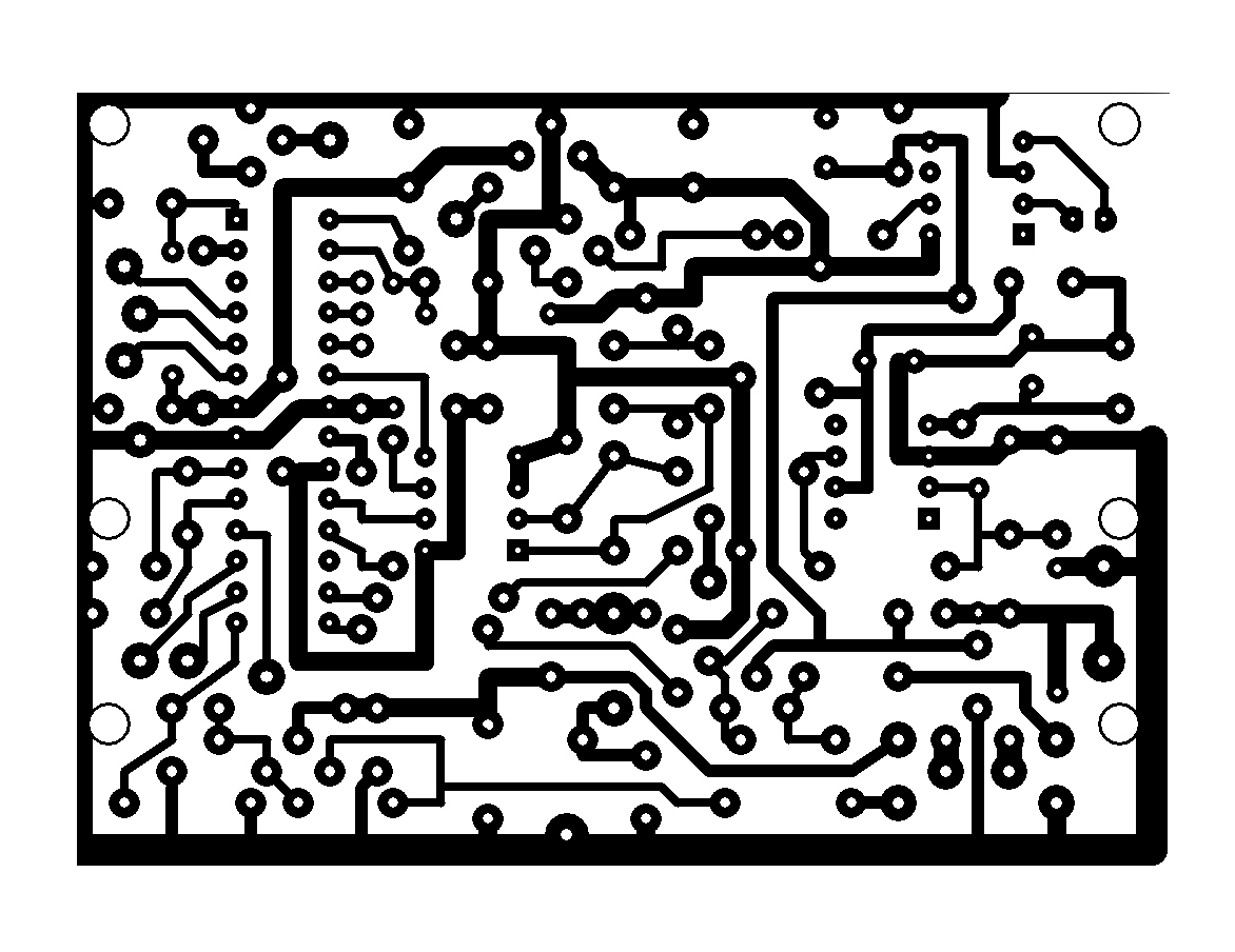

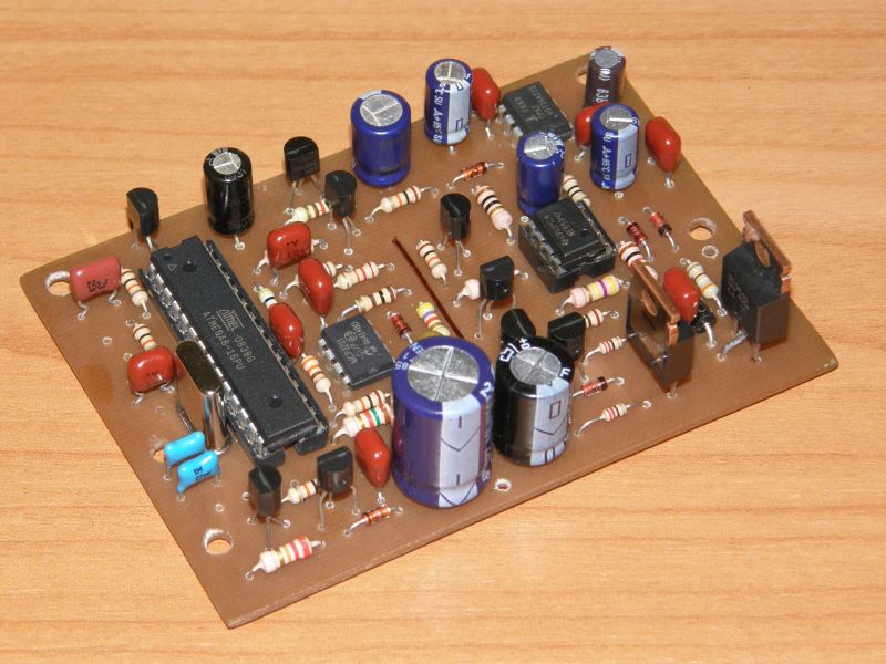

                          Another chance for Chance. I managed to find few years old readily made PCB (heavily oxidized but fixed after some careful cleaning), single sided version, and almost all parts in my junkbox , and here it is: I hope during weekend everything will be completed and programmed, ready for testing. At this point not everything is “original”, I don't have OP37 at hand, have to order , transistors are IRF 9630, not 9640, fast diodes are UF1007, and this version is without new hardware modification, I will add this later easily to see what difference it makes. This detector never cached up, but probably we underestimated it's ability, with some tweaking, mostly coil oriented, this can be really nice DIY project. Something capable for sub-10uS sampling, multiperiod timing and effective ground balance, at least some form of discrimination etc. hand made is always interesting. At least I will properly document circuit operation. Also I want to try some tricks for fine tuning VDI response, idea appeared some time ago on some foreign (probably not even Russian) site, but too late to try it, at a time I already disassembled my hardware.

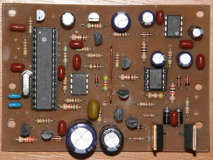

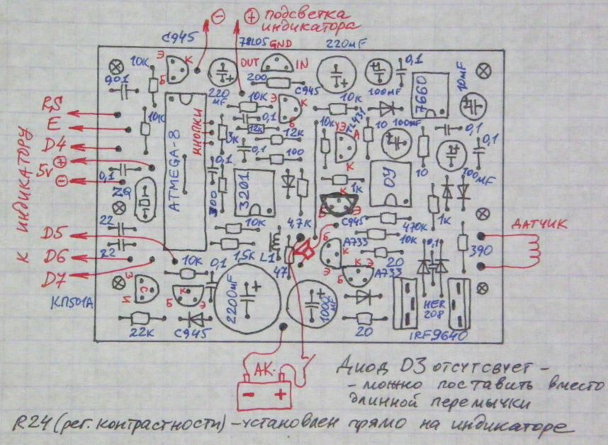

                              As I can see from picture it is Chance layout from DesAlex. It is smaller, one side, easy to make PCB. I have etched one.
                              Only my problem was that lay file was printed a couple % smaller so 28 pin controller hard to fit in it.
                              Probably Sprint or my laser printer were wrong. Better check dimensions before etching.
                              You can download all files including "Chance layout from DesAlex.lay"
                              http://forum.cxem.net/index.php?app=...ttach_id=75463

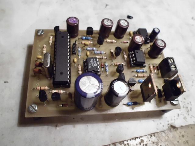

                                This is not exactly DesAlex board but same design, I made this in Protel from scanned hand drawn board layout (Сборочный черт&#11.jpg ) time ago, in 2009 or 2010 I think. Few boards are made then, and few detectors built, earlier version software, but performance was not satisfactory. Later new software updates came, but by then I disassembled complete detector and tried new versions using just PCB, later cannibalized for parts. This one leftover PCB remained, design is known to work, will be nice platform for some tests.
                                Issue with resized PCB happened to me more than once, print from .pdf, or wrong paper format, letter instead of A4 or... Always noticed when PCB is etched, tin plated and drilled.
