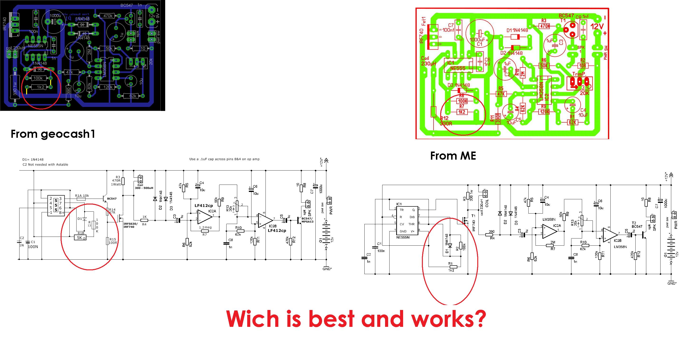

    • one simple quaestion before i waste some more boards for this mysterious thing
      just open the picture
      and how to calibrate the trimpot from ic2 20K?
      for what is it

        • ah, well spotted burnte one,
          problem there ,
          trim pot for frequency adjust, which will also adjust on time,
          unfortunately.
          that's the draw back with that configuration.
          anyways,
          that's not the problem,
          theres no resistor across the diode between
          pins 6 and 7,
          that's poss not going to even run........

            • Hi Burnte, from simulation, both designs will run:
              The first has F= 125 Hz, 400 uS PW
              Your has F = 140 Hz, 100 uS PW
              The Russian 555 based circuit has F= 4 kHz (250 uS cycle time), 150 uS PW
              I'd stick with yours..
              • hello beenthereuk
                thanks for trying it in the sim
                i caculated longer time before with a ne555 caculator
                problem is that longer pulse on time will overheat the irf in reality and maybe some other parts
                i have one 1/4w resistor melt down by a fusion i have never seen before on a resistor
                that is some thing that is forgotten
                so i thing the hode thing also with new parts is very misunderstood, and nobody (maybe one or two here) can reallly tell how this unit work

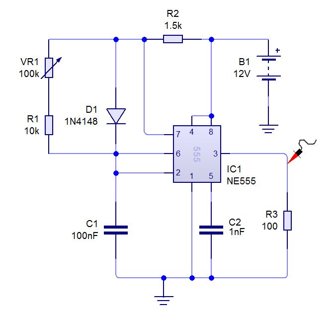

                        • Hi Bernte, dropping 12V across a 330 Ohm resistor will dissipate 12^2/330 = 436 mW which is almost twice what a 1/4 W resistor can handle.
                          To be safe, use 3 x 1k resistors in parallel on the PCB so that the final resistance is 333 Ohms and the dissipation per resistor is less than 1/4 W. Or use a 1 W 330 Ohm resistor.
                          I think that the IRF will most likely have to run hot as it is in these circuits. The best you can do is add a heatsink to it (bolt it to a large piece of aluminium or copper).
                          If you use the circuit shown below, it is possible to set the frequency as per this table:
                          Variable set to lowest resistance, F = 125 Hz, 100 uS PW
                          Variable set to max resistance, F = 1000 Hz, 150 uS PW

                          • i think i will try it a last time with this mystery machine
                            1000hz with 150µs PW ohhh thats much
