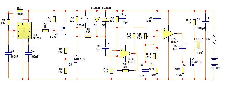

    Should R10 be connected to IC2a positive, and not negative, input? Otherwise the amplifier's positive input will hang in positive supply.
    It's highly unlikely to work as a PI input stage that way, output clipping into +V output limit.
    • #62
      Yes, thank you. I checked it all, but it is hard to noticed own mistakes.
      • #63
        I'm not sure that the speaker should not be a piezo beeper. Also, if you want to use a NMOS switch set R5=0 and R6=220.

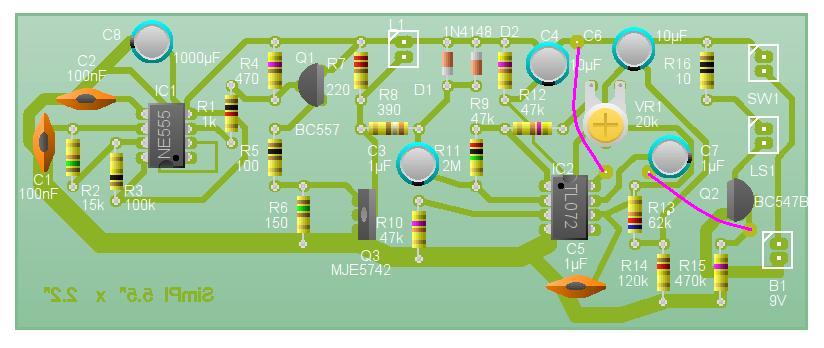

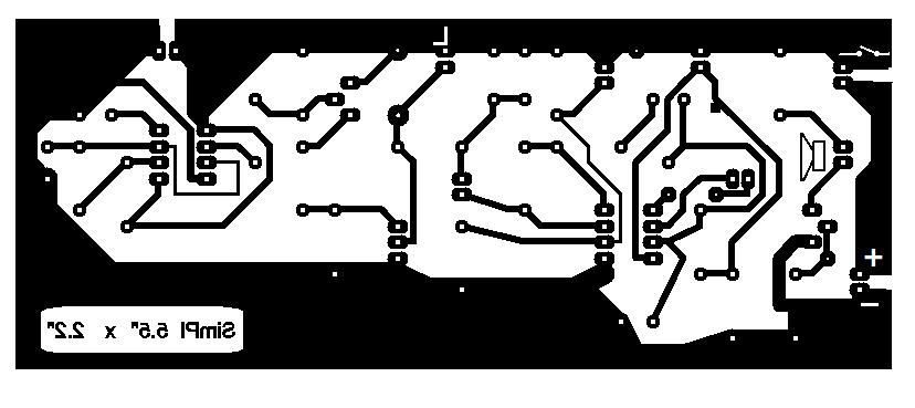

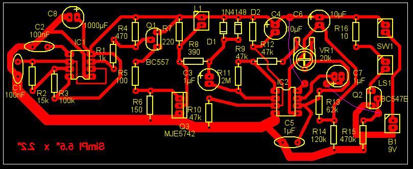

                most parts as possible in smd could make a nice little pi pinpointer
                i will try this weekend with sprintlayout
                the layout shown before has also much potential for reducing
                all flat inserted parts (resistors and diodes) can be done as standing parts
                means reducing the gap between the solder pads

                      I used the one from post number 15 exactly. The only change i made was i used a 50k resistor and 50k pot after the output of op1 for balancing and it worked well. Also, i never used a mosfet, just a standard 547 transistor.
                      Also changed the frequency to around 400Hz and coil of 400uH.
                      Will make a vid tomorrow.

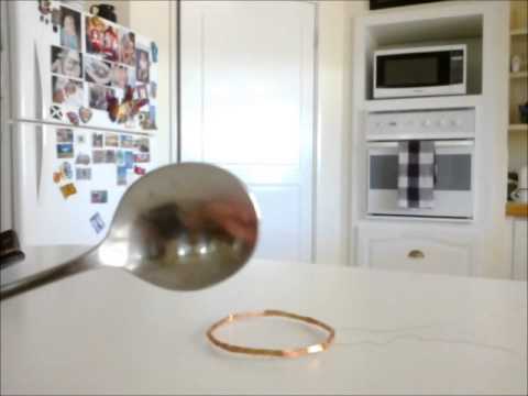

                          Made a quick video of the detector in action:
                          Excuse my camera work :P My video skills are level with my electronics :P
                          coil is ~400uH - 42 turns of 0.5ml wire with 10cm diameter
                          Ran a few experiments on it.
                          Frequency doesnt seem to matter.
                          I changed capacitor C1 with 22nf and 180nf, all it does is change the tone of the speaker. Messed with R2, just flattens the battery quicker.
                          I tried changing R9 and R10 for 49k each like on the previous schematic. Made the tone short. Instead of i nice long buzz is gives a little chirp. Changed them back to the original.
                          Trying to get a mosfet to work but no luck yet. Seems i have to use pots with larger or smaller values as there is no quiet spot when i use an n-mos.
                          Will solder this up once i find the right balance and mount it on a mini frame for a kids metal detector.
