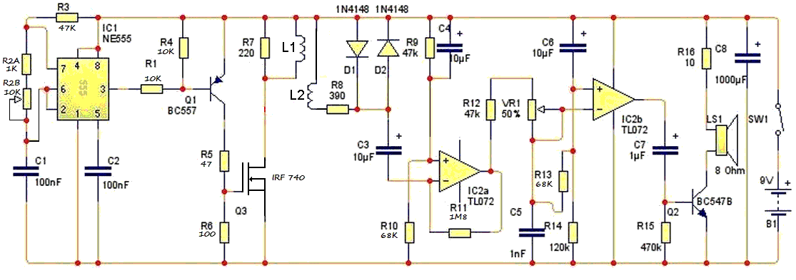

Simplest PI detector possible?

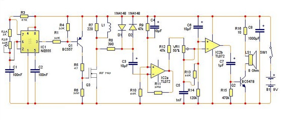

  • R2 can be played with using a 555 timer calculator. Google one.
    R7 is tricky without a scope to set. Just trial and error a bunch of values from 100 to 400 ohms. But the default one in the schematic worked for me.
    My coil is 10cm diameter, 400uH, 42 turns of 0.5mm copper enamel wire.

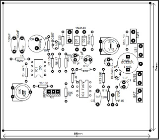

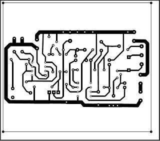

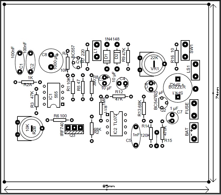

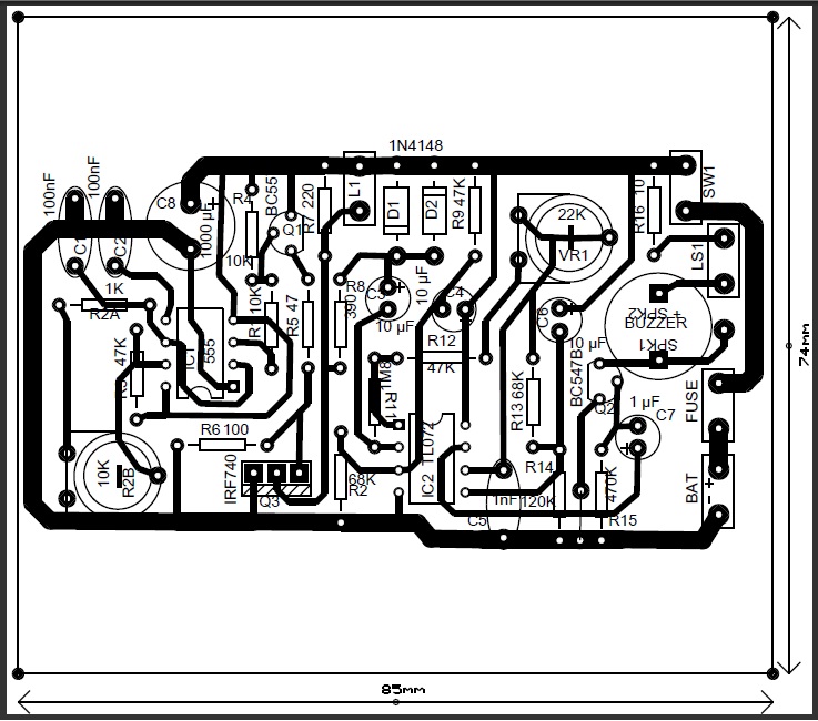

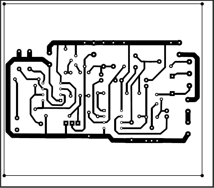

    • Russian Pirate PI Metal Detector (2nd Attempt).
      Some modifications and a slight improvement.
      Nice work's, but still not good enough.
      Suggestions for enlarge deep range ?
      Thank you.

      • More deep with IB search head
        [QUOTE=Watanabe;167004]Some modifications and a slight improvement.
        /QUOTE]
        For more deep range, use induction balanced search head (separate RX coil). Three IB configurations are suitable: DD, concentric and orthogonal.
        • Originally posted by mikebg
          Thanks Mikebg, but it will not change much the essence of this idea is to create an PI circuit as simple as possible?
          Well, I have not the slightest idea how to do what you said ... Could you make an electronic scheme?
          Thank you.
          • VERY SIMPLE
            Thank you.
            Simply disconnect R8 from TX coil and connect it to RX coil. No need to change PCB.
              You will (more than likely) also need a damping resistor across the RX coil.
                  No need of additional damping resistor because there is negative feedback. Resistors R8 and R11 form a nonlinear damping network. Linear analysis shows that input impedance at inverting input of opamp is in theory zero.
                    At steady-state, yes, but not during transients. Ringing will depend on the amount of coupling with the TX coil.

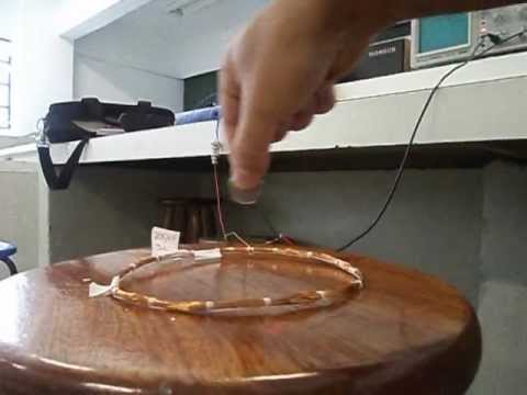

                      • I made several attempts, with coils of various types, and not get better than this result:
                        http://www.youtube.com/watch?v=SqNeJegCjHU
                        I can not say, but I believe that better results are possible only with great changes in this circuit.
                        Thank you all.
                        • I did the layout # 14 6666. Works perfectly, 5 euro cent coin to 20cm, 90mm round iron 50 cm, I used 13007
