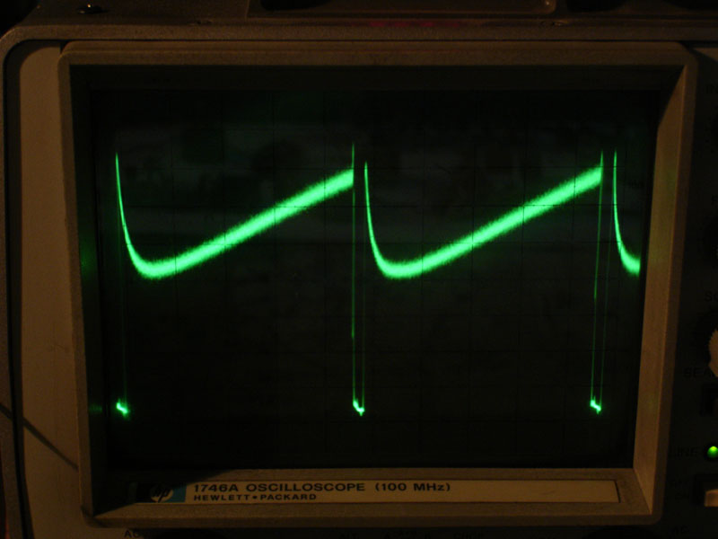

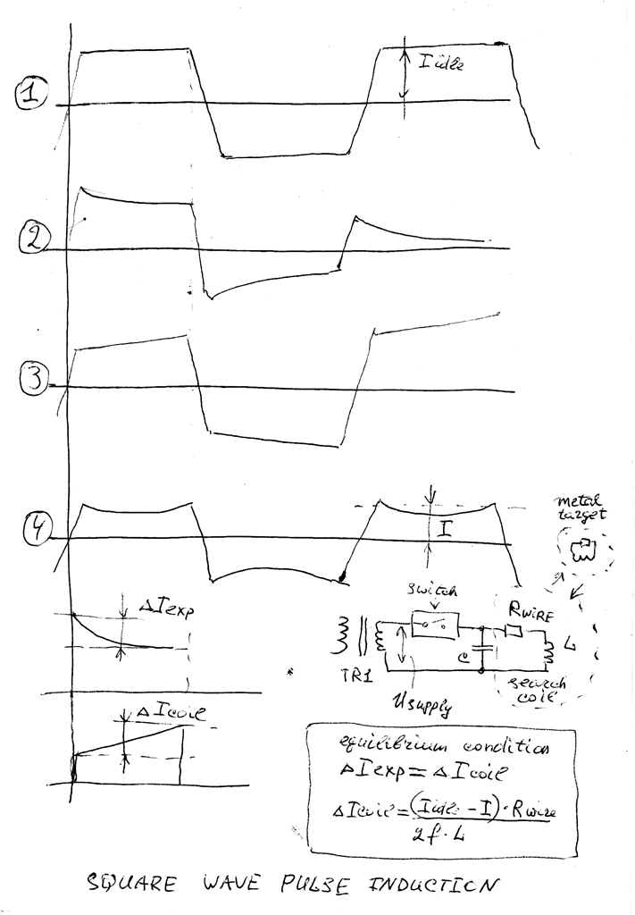

          Now , before I'll show the signal processing circuits , we must clearly understand what kind of signals we can expect on the power chain output . As I told before , the output current wave ( TR2 secondary coil , on the power chain circuit ) does have a "square" shape with 4 intervals in each period - 2 intervals of constant current ( working intervals ) with opposite polarity , and 2 flyback intervals between them , with half-sine pulse shape . In my working prototype flyback pulse has 8 uS duration , and working interval duration can be set between 500 uS , for 1 KHz frequency , to 42 uS , for 10 KHz frequency . So we can easily receive and process a target response signal from a different kind of targets , and we also can use the optimal frequency in the different cases - for example , if we need to find a very big and deep target - we can set lower frequency ( 1-2 KHz ) , but when we need to find only a little gold nuggets , or little coins - we can push the frequency up in order to obtain the maximum sensitivity . And what is interesting - power consumption rises very slow with frequency , for example , the circuit consumes about 65 ma current from 12 V battery on 1 KHz working frequency , but when I set 10 KHz - current is about 120 ma . This transmitter is pretty power-efficient , especially on high frequencies - because we don't need to charge the coil again and again , but only reverse the current 2 times a period , and by the way , when this device runs on 10 KHz - it's equivalent to conventional PI device at 20 KHz PRR ( because we have 2 flybacks on the period ) .... it's not bad , anyhow
          But what we can see on the scope when we bring the metal target to the coil ? As I explained before - each current reverse induces the decaying eddy current in the target body , and this exponentially decaying current process , due to Lenz's law , makes the search coil current to decay too - it occurs just on the working interval .... and this decay repeats in every period - so the average coil current goes down and down - because the next period starts with the current the previous period finished with . So , if we measure the average coil current , and notice a sudden current drop - we can use it as a sign of a metal target presence , and the first algorithm of signal processing is based on this fact .
          And if the current goes down on every period when a metal is near the coil ( more precisely speaking - on every half-period ) , what does prevent it from totally disappear , from decaying to zero ? This preventing factor it the current rise caused by reduced power chain energy loss . As we can see on the attached picture , in the stable state we have a kind of "equilibrium" - the supply voltage ( Usupply ) is completely equal to the sum of the voltage losses ( voltage drops ) through the whole chain . These losses are - the voltage drop on the power switch ( diodes and transistors ) , and the voltage drop on the coil wire , due to the current flow , according Ohm's law . So the stable state condition is defined by Kirchoff's voltage law - http://en.wikipedia.org/wiki/Kirchhoff%27s_circuit_laws - "the sum of the emfs in any closed loop is equivalent to the sum of the potential drops in that loop" . And if we haven't a metal near the coil , we does have a stable state - an "idle process" , producing an idle square wave - graph (1) on the picture . When we bring the metal to the coil - the coil current begins to decay ( graph (2) on the picture ) , and after a several periods it can loose quite a noticeable part of its initial magnitude . But when the current become lesser - the voltage drops becomes lesser too .... and with the constant Vsupply voltage - the sum of potential drops becomes lesser than EMF , so the coil current becomes to rise , with almost linear law ( graph (3) on the picture ) .
          So with a metal near the coil we does have a two simultaneous factors - exponential decay (2) and linear rise (3) .... and they both leads the system to the new "equilibrium point" ( another stable state (4) ) with less average coil current . As we can see in the picture - this average current drop ( Iidle-I ) depends on the target-induced input signal magnitude ( delta Iexp ) , operation frequency F and the coil time constant ( Lcoil/Rwire ) . The system behaves itself as it has a kind of inherent "negative feedback" , just like an OP-amp with negative feedback resistors does . Signal goes to the input (-) via the input resistor , moves the output , then negative feedback returns to the input wia the feedback resistor , and the system comes to the new stable state , with voltage on the output , amplified by the Rinput/Rfeedback ratio . And like the OP-amp with negative feedback , this power chain has it's own "amplification factor" , being defined by the Tperiod/Tcoil ratio , so if we watching the signal on the scope , we can notice that amplitude does drop much more than we can expect from the exponent decay during the only one working interval .

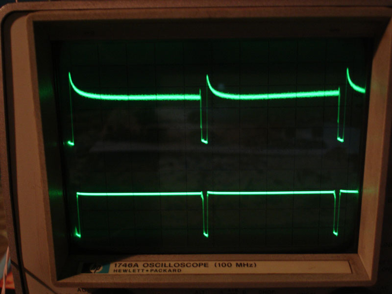

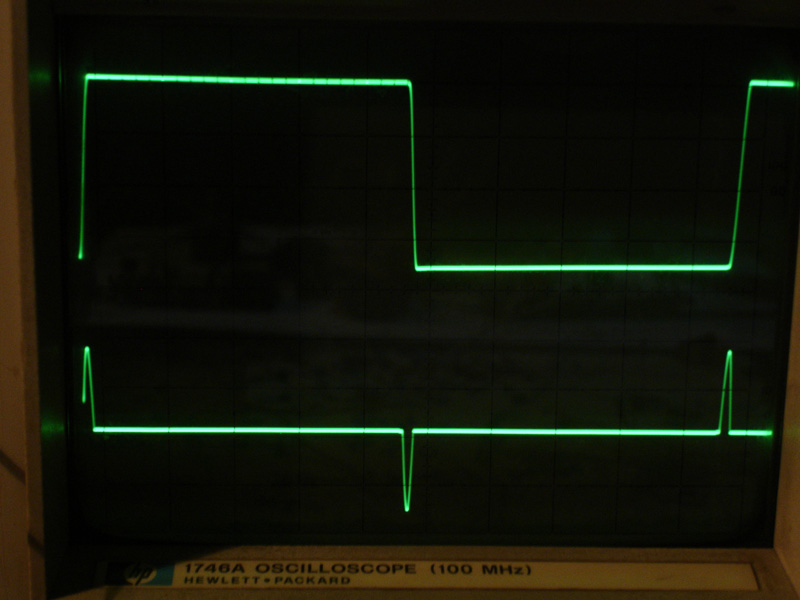

            Here are the real pictures of the signals in the circuit . The first is the coil current versus the flyback voltage -
            this is the same signal , magnified by the scope -

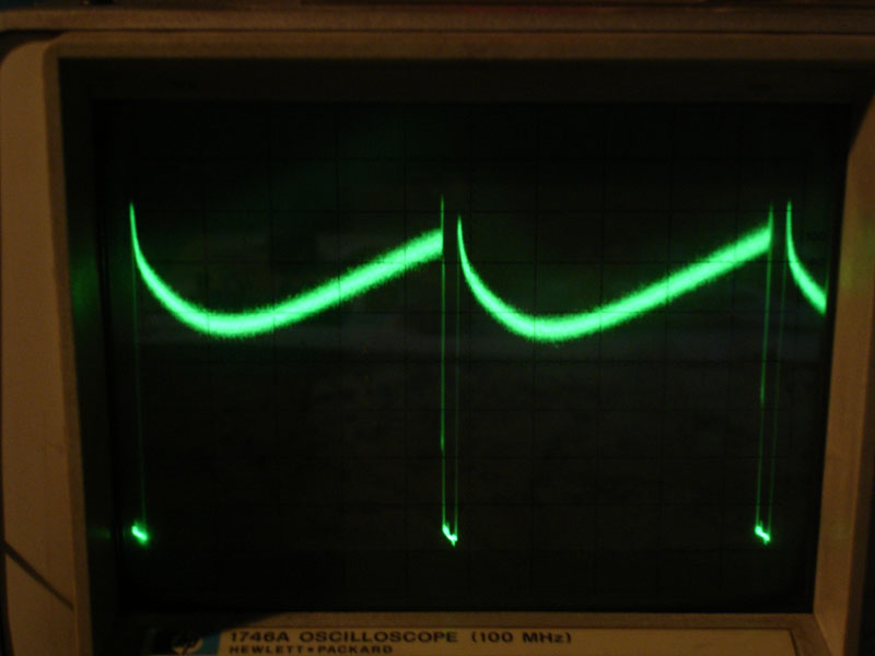

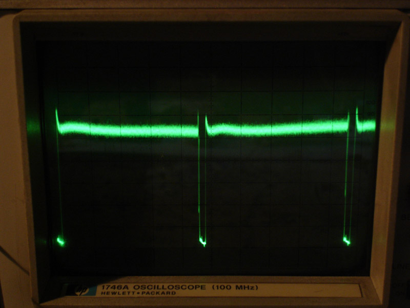

            this is the coil current signal after the full-wave rectifier , so the both half-waves has the same ( positive ) polarity -

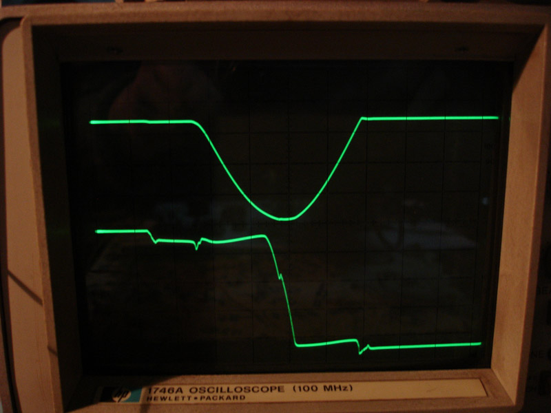

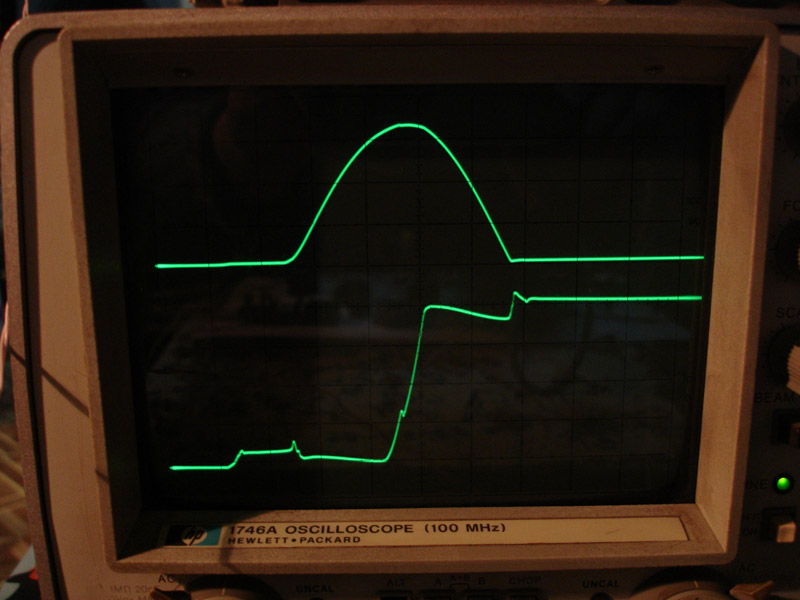

            and this is the output signal with the metal target ( 0.33 coke can ) near the coil -

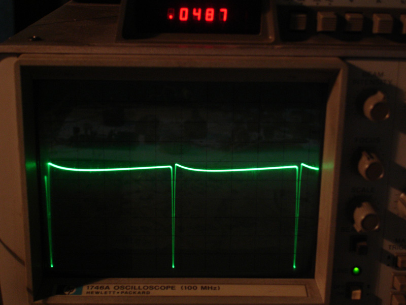

            We can see a big amplitude drop with relatively low remaining exponent signal on the working interval , as I explained before .... and we can see also a power chain supply current drop ( from 63.8 ma to 48.7 ma ) .

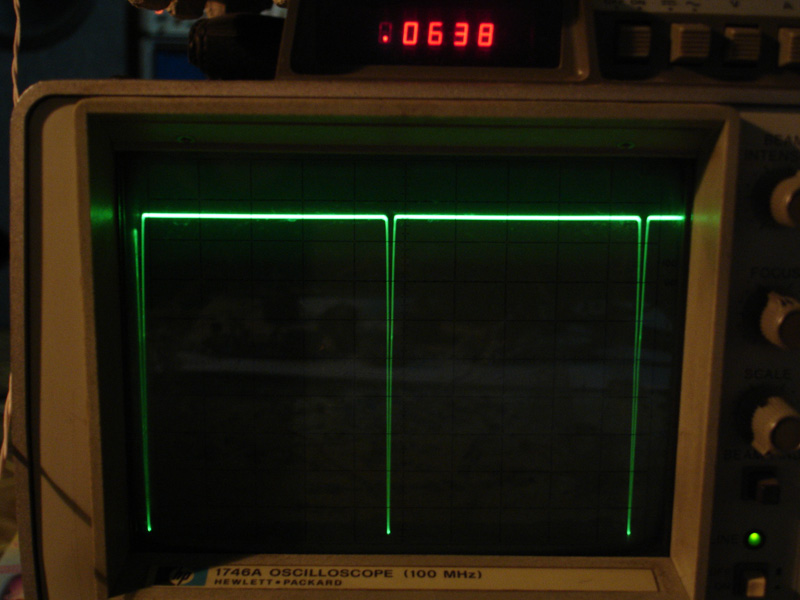

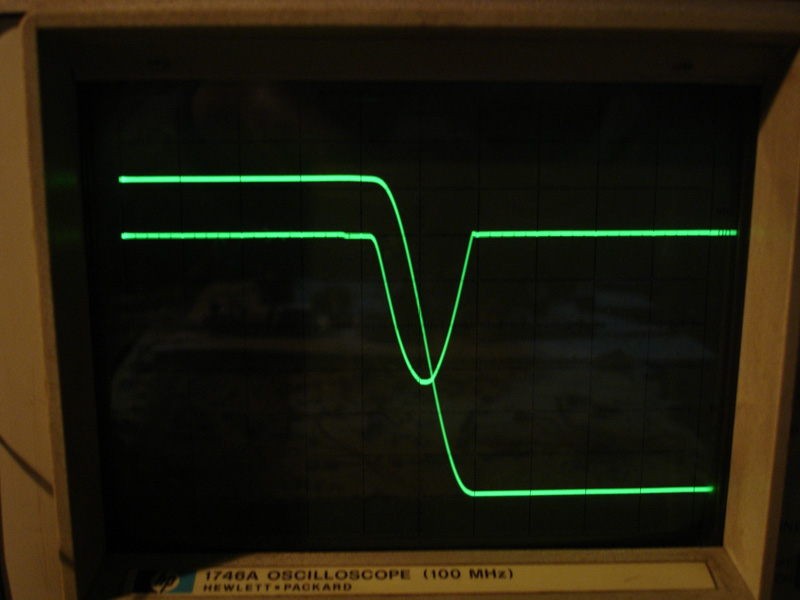

                  All waveforms are real , of course . What about turn ratios - I marked them on the power chain circuit ( n , n/4 , n/5 , 2.5*n , etc ) on the page 1 of the topic . N is a turn number of the primary coil - TR1.1 . Current transformer TR2 has 2 turns on primary and 500 turns on secondary side . And also I marked coil inductance of all transformers - it will be enough to make them . All what you need is to recalculate all windings for your core - because I used the cores that I have here , but your ferrite may have a different permeability and saturation point . By the way , these 2 pictures shows the "kick circuit" operation ( look the power chain schematic , test point TP3 ) - positive and negative transition .
                  Flyback pulse ( upper scope trace ) has 330 V amplitude , kick circuit pulse - about 20 V . Timescale is 2 uS/div .

                              Yes , I have these pictures ..... one example we can see in the post 35 on this page - the bottom picture is the target response of a coke 0,33 can near the search coil , taken just from the preamp output . I use here a kind of differential preamp based on a dual op-amp , so I have both positive and negative signal waves in the same ( positive ) polarity , then I used a simple 2-diode rectifier and shot this picture . So this is a signal without any further amplification , just from the frontend . But the signal destination is different in a different signal processing algorithms ( see block diagram in the post 29 on this page ) .
                              In the simplest first variant of processing ( version 1.0 ) we feed this preamp rectified signal directly to the low pass filter ( about 15 Hz cutoff ) , in order to select its DC component , proportional to the average coil current . So we don't interest about the signal shape , we are catching only the amplitude drop when the target is near the coil . So we cannot see a detailed picture of the signal - we don't need to do it .
                              But in the second variant of processing ( version 2.0 ) , we have a goal to select and discriminate the signals from different targets with different time constant ( TC ) . So I use there a several gain stages , which makes an opposite operation - they discards the amplitude drop , but amplifies the signal on the top of the pulses . And after those gain stages we can obtain more interesting pictures . Here I upload a pictures of a signal after 2 gain stages , when the different targets ( with different TC ) were near the coil . You can see some RF noise on the pictures , it's because of amplification . Operation frequency is 2 Khz , time scale is 50 uS/div .
                              The first picture is an idle signal , without any target :

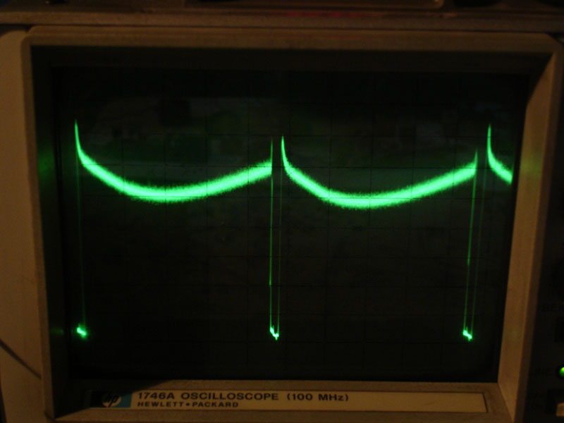

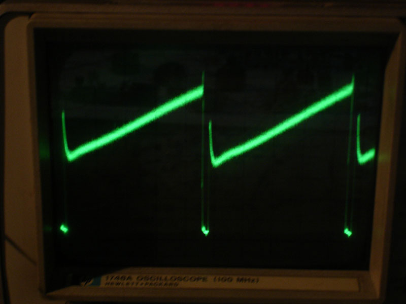

                                By the way , when we look to these pictures attentively , we can notice the same characteristic in the all pictures . I mean that the start and the end point of the curves are virtually at the same height . And the same feature we can see on the post 35 bottom picture . But as we know , the target response is a piece of decaying exponent , so the start point of the function must be higher than the end point anyhow . But why they are equal here ? The explanation is in the post 34 - I told there that when we have a target near , this exponential decay causes the current amplitude drop , and the power chain , in order to prevent the current from total dissipation , "inserts" its own linear rising function to the current signal . In another words , the power chain tries to "equalize" the start and the end point of each period , maintaining the stationary operation of the circuit in every conditions .
                                And this is why we see not the target exponent itself , but the target exponent + linear supplement function . This not a problem for signal processing , because I use further a correlation procedure , with a set of a linearly independent reference functions ( square , tilt , parabolic , cubic , etc ) , and can easily separate this linear append from the other function components . But what if we wanna see the PURE target signal , without any additional stuff ? This circuit also can easily do this . What we need is to use an appropriate algorithm of the kick circuit operation control , in order to maintain now the constant amplitude of the coil current with or without the target near the coil . With this operation mode , the kick circuit control rules the voltage so that every amount of energy being "sucked" from the coil by the target , would be restored by the kick circuit before the next measuring interval begins . In another words , it's something like an ALC circuit in the oscillator . I tried this mode too , and took a picture of the typical target signal on the output of the second gain stage . The upper trace is the second stage output , the lower trace is the first ( the signal is much weaker on it ) :
                                This is a pure target signal , a classical exponent decay function . This mode can be useful in experiments , target TC measurements , etc . Maybe I will use it in a version 3.0 algorithm , but I will do it later , after finishing 1.0 and 2.0 .
