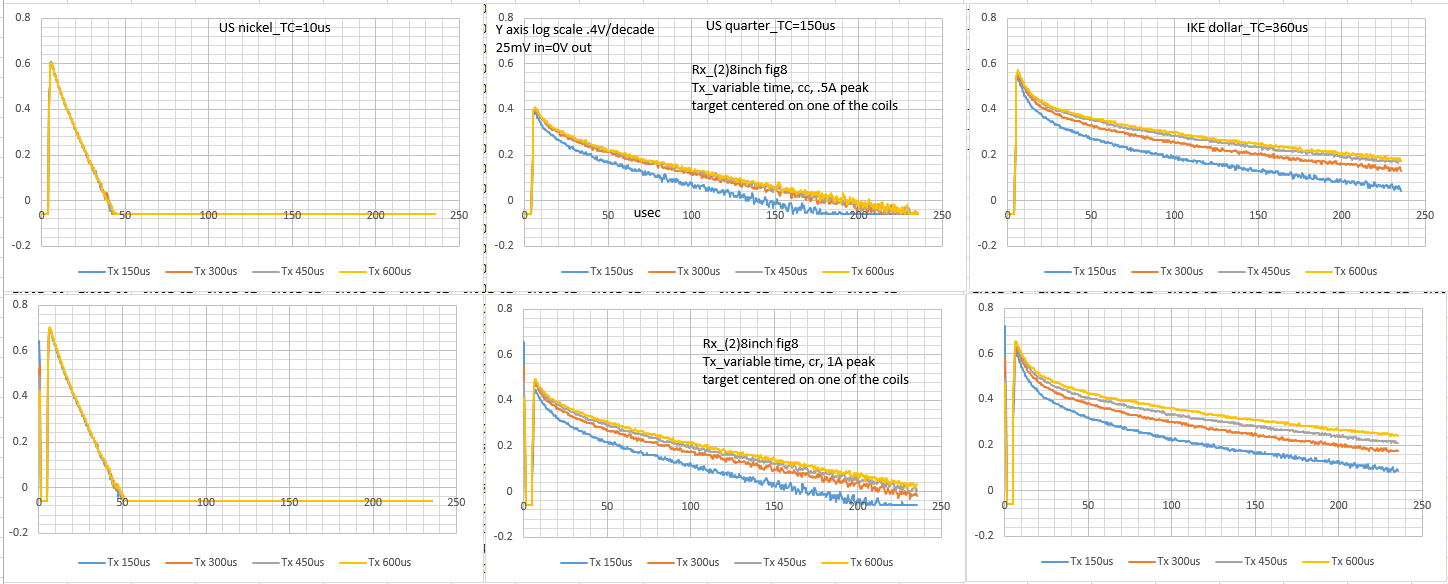

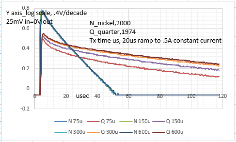

              If your Nickel coin is a US Nickel with a 11 inch coil you have a major problem. Target signal is effected by Tx coil peak current, turns, wave shape, Tx on time and maybe others. A US Nickel has about 10us TC so not effected by Tx on time greater than 40 or 50us. That leaves peak current and Tx turns. After Tx comes Rx, signal to noise ratio. Doubling signal to noise should increase detection distance maybe 4.5cm. I'm guessing the detector should detect the Nickel at around 40cm. No guess why detection is so low. Increasing sample delay 7us would halve the signal, maybe a 60 to 70us delay would come close to what you are seeing.
              Including a couple charts I posted awhile back with US Nickel and Quarter targets. Three minor lines on chart doubles or halves the signal.
