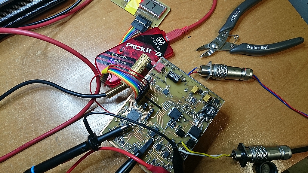

        Actually, as I figured out from source code, goes more like this: 60uS EF cancellation sample, followed by 150uS TX pulse. Then, without “hole shifting”sample, goes 10uS delay, then 10uS positive, then GB delay (integrator disconnected). This is variable and used to adjust GB point. Then, 150uS negative, again GB delay, same duration as before, then 140us positive. Optional “hole shifting” is 5uS negative before first sample.
        Hi Tepco, thanks for explanation from the QED source code.
        • #49
          I dont know how to write real code useing timers and such, just tried an amateur bit banging hack useing great cow graphical basic, dropped s2 5uS hole shifting pulse, but with variable GB width control.

            You tried to compile and upload the code (orginal assembler code) to dsPIC?
            • #51

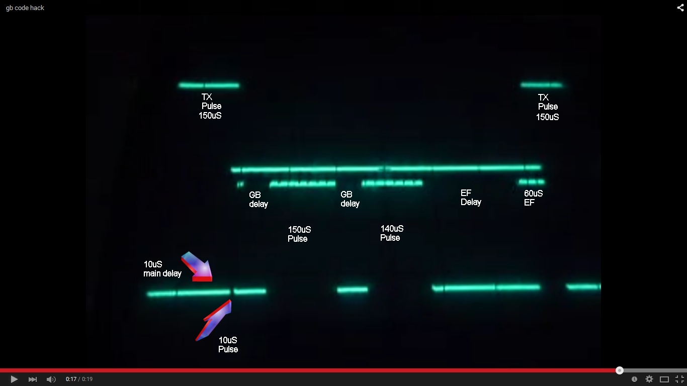

              Hi Taktyk, I just put together some of my own code purely based on Tepco's description of the pulse train, I used great cow graphical basic and a recycled picaxe 18f14k22 running at 64 mHZ.
              Here is a small video.
              https://youtu.be/VEGTQ8emWUk

                      6666...
                      This is not consistent with QED - interpretation of the code is incorrect.
                      T.
                      • #56

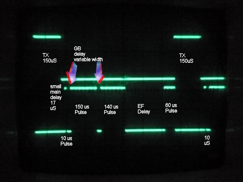

                        Hi Taktyk, thanks for the feedback, you say there is a problem with my code in the video, can you please tell me what is wrong with it so I can fix it
                        my code was based on the description by Tepco, Thanks.
                        I have labeled this picture with pulse train , the camera is not square on to the cro screen.
                        • #57
                          Check assembler code - in the main loop...
                          T.

                            • #59
                              Hi, 6666, best to build a system to check
                              You only change the position of the first pulse (150uS) - the second pulse is immutable (140uS).
                              It is best to check yourself.
                              T.
