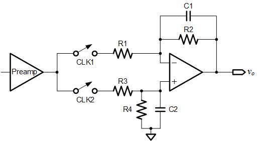

                    Hello George
                    do you remember back when you did all the maths in reply #27 for Mickstv GEB solution ?, which intergrator configuration does the maths apply to, was it this one attached , with the signal straight out of the preamp ?
                    Thanks.
                    • #70
                      Hi 6666,
                      I'd use an inverting stage after the preamp then use a single ended integrator stage....
                      • #71
                        Hello George
                        Thanks.
                        I'm not sure it really matters which integrator configuration is used. The one you posted is similar to the Hammerhead, which I believe will work by adjusting pulse widths to change the gain.
                        • #72
                          Hi 6666,
                          G'day Mick, good to hear from you, hows things ?
                          • #73
                            Hi George, I spent plenty of time testing both options, but the best method for GB and EF cancel is to use the single ended integrator method. It works better for wide samples.
                            • #74
                              Hi Bruce, yeah going good, spending time out detecting yellow stuff...
                              • #75
                                Thanks George, maths is not my strong point in my ageing years, was trying to match the circuit to the maths.
