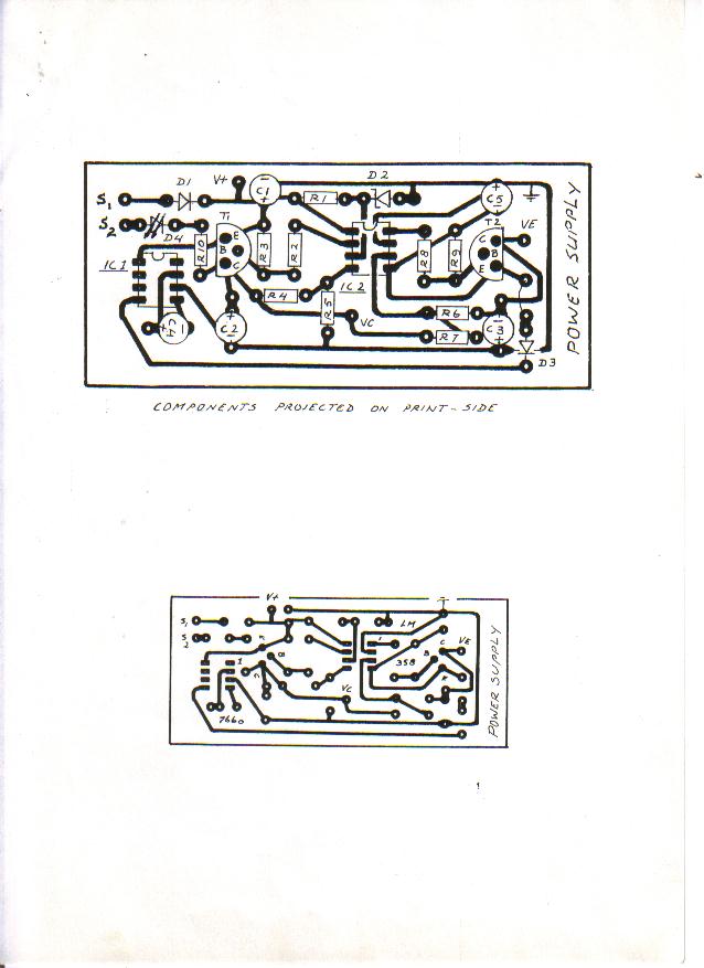

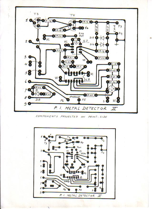

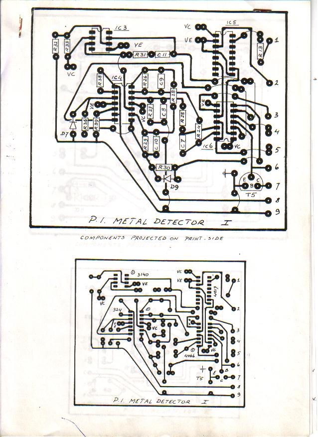

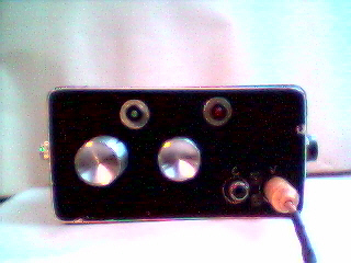

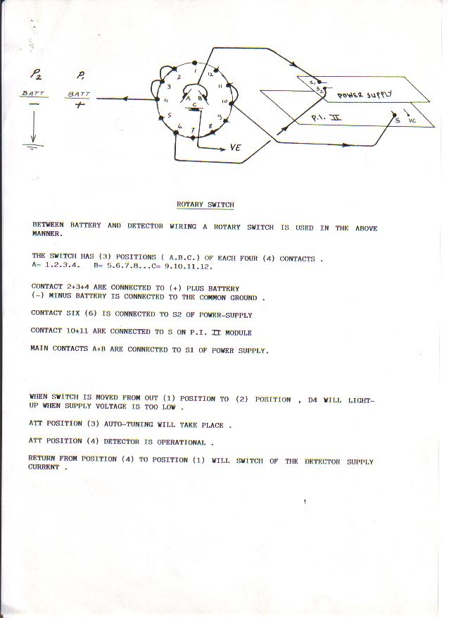

      Picture of the PIDX as I have built it . Kees
