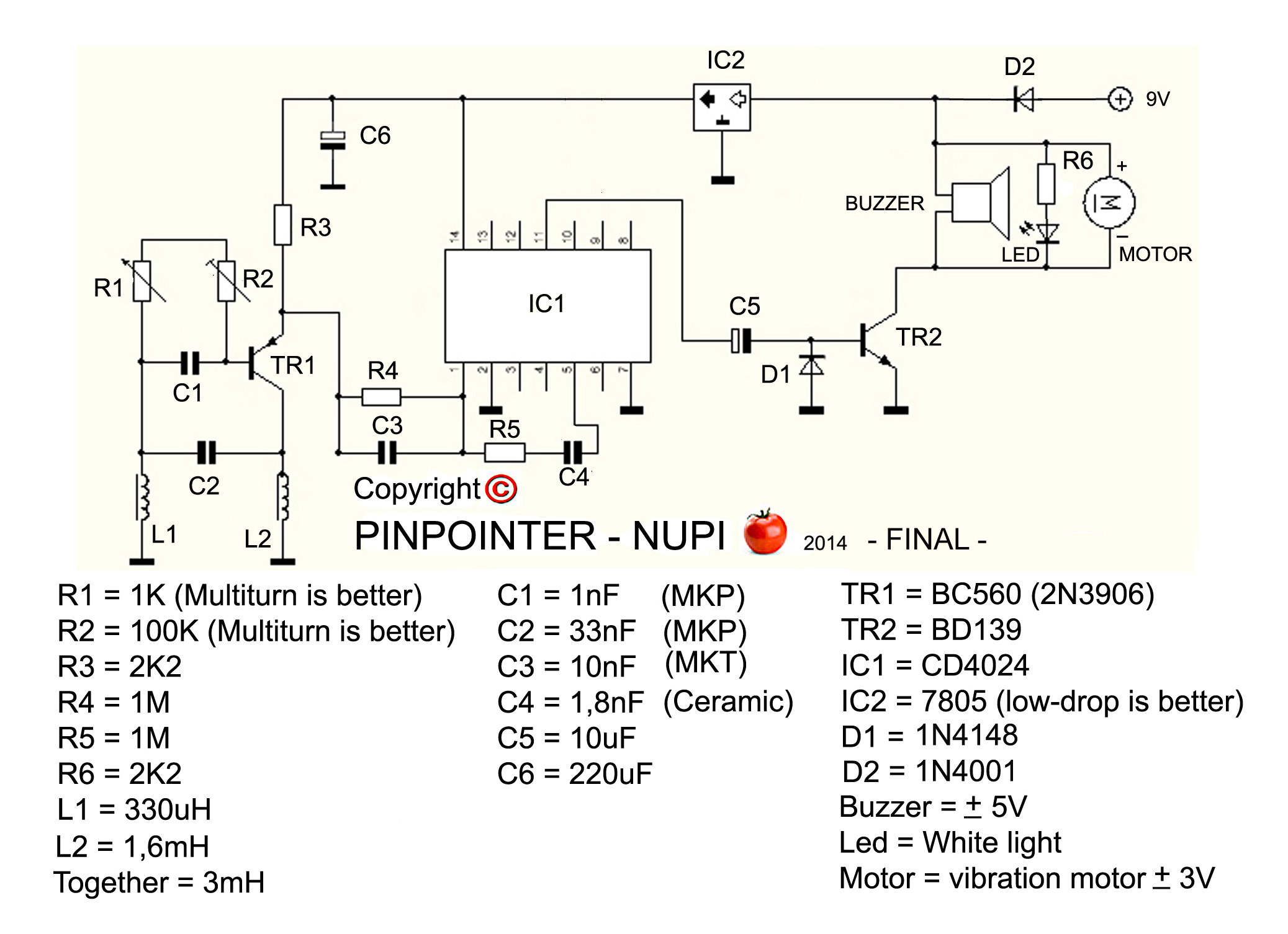

    Mine didnt work. ( I made the NUPI Pinpointer ) NOT the mini one
    I made some changes in some components, because local distributor didnt have them
    I thought it would work, but, with lower results....but it didnt
    Coil....same as yours
    IC1 HEF4024BP
    TR2 BD135
    TR1 2N3904
    C2 47nF cant find 33nF
    C4 2.2nF
    Also removed LED / Buzzer and R6 leaving only the micro-motor for vibration
    Will try to find out why

        TR1 should be a PNP 2n3906 or similar
        • Originally posted by Thomas View Post
          You're right Thomas, it must be a pnp. Thanks!
          Silly of me that it is not been noticed me.
          Sorry Nezocas it's my fault.

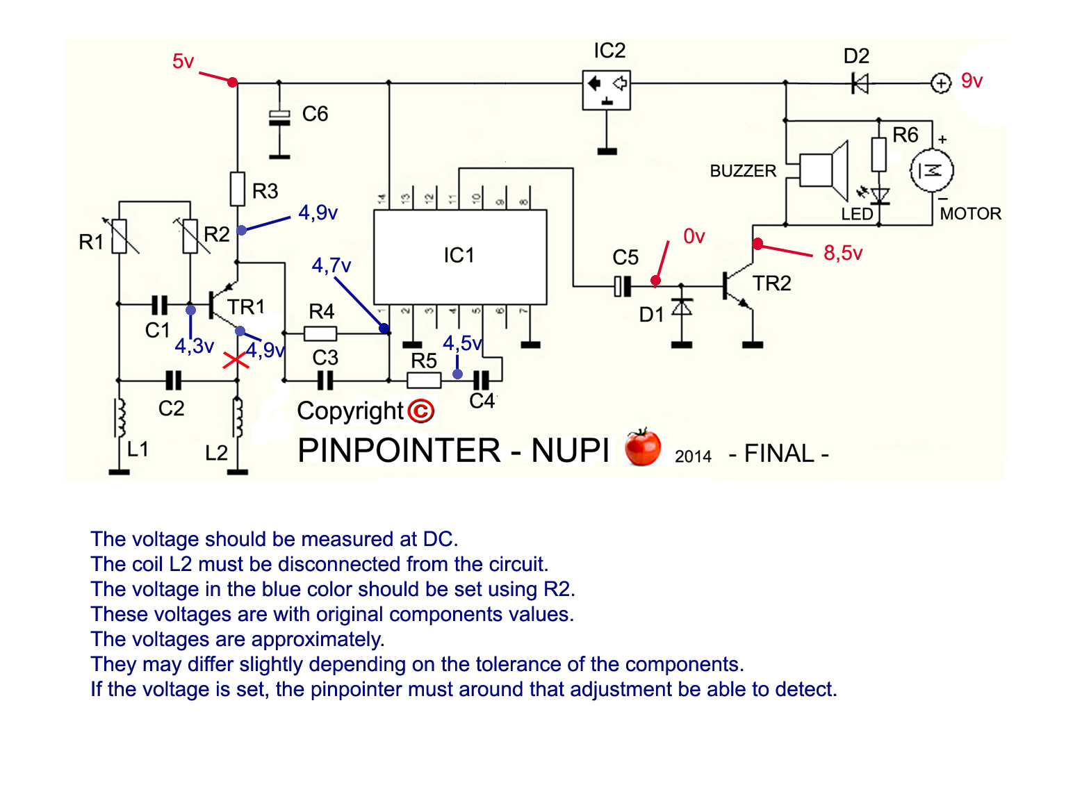

              With your parts must be able to detect but with the 2N3906, but he's a little less sensitive about 15% less.
              Check all parts and compare them with the schematic.
              Here are the voltage and components schematics.

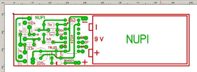

                  • Originally posted by nakky View Post
                    [ATTACH]29443[/ATTACH] Nakky
                    It looks nice and clean and pompact.
                    But I see some mistakes.
                    I have no time no, but over the course of the day or tomorrow I more time.
                    Maybe there's someone else who wants to chek the circuit.
                    Few points: Resistor R5 - 1M in series with C4 - 1.8 must connect from pin1 to pin 5
                    of the IC-4024.
                    On pin 10 is no signal.
                    R1 must be a potentiometer. It is the adjustment of the sensitivity.
                    good luck.

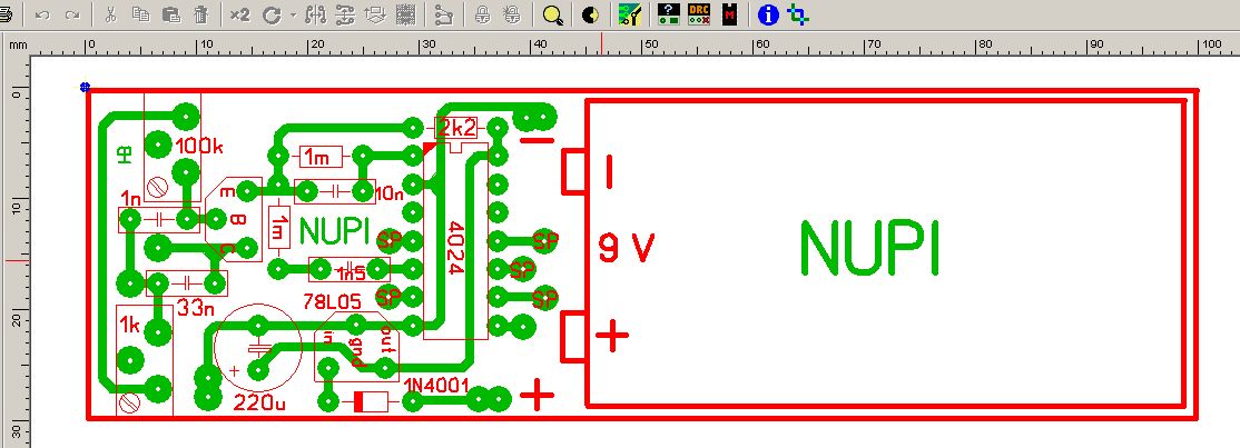

                    • Sorry,change it. Nakky 29444
                        Hi, Nakky
                        Does not matter, I probably make more mistakes than you. In that aspect, I am a super nerd.
                        I think it's okay now, well-done.
                        I want you to say that there is no signal from pin 10 of IC 4024. But You can take it from pin 12.

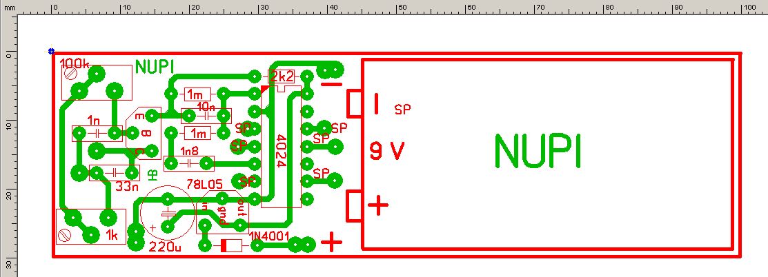

                          • Hi, nakky!
                            I just had a short view on the second pcb and one thing jumped into my eye:
                            The two spindle trimmers will work as fixed resistors in that configuration. Connect the middle pin to one of the outer pins at each trimmer.
                            • Originally posted by migusch View Post
                              Hi, nakky!
                              Thank you for participating in this thread. You're right.
                              Sorry, nakky, I've overlooked.
                              • Verander het Nakky
