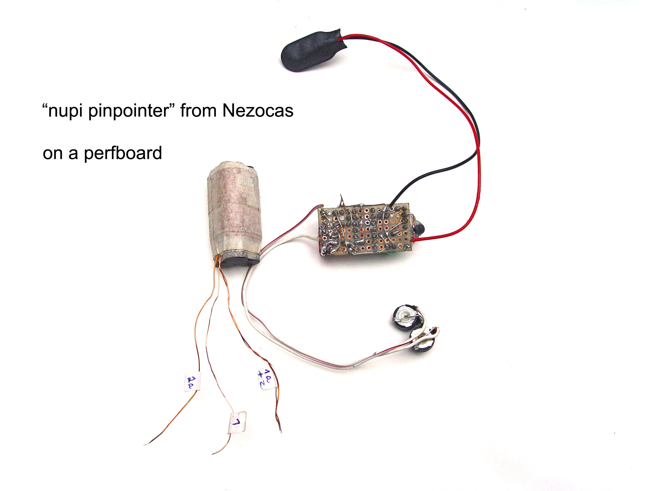

            • Originally posted by Nezocas View Post
              I have replaced R2 with 470K pot
              Also replaced R3 with original value 2K2
              3x 10nF cap are still in the board
              Now, if I turn very slowlly R2, I get to a point where the motor starts moving 1 second, and stops another second, and them moves again (1 sec sotps / 1 sec stops /1 sec stops)
              At this point if I move metal over coil, no change at all
              I have tried several positions of R2 and R1, but no detection at all

              I received the package today from Nezocas, with the pointer including the coil.
              I have consulted with him if I could post the results, so that others could have benefited.
              It makes him no matter what he would have done Incorrectly.
              I rejoice when I come across someone who is not affected by his ego, nice.
              Thanks Nezocas, to share it with us.

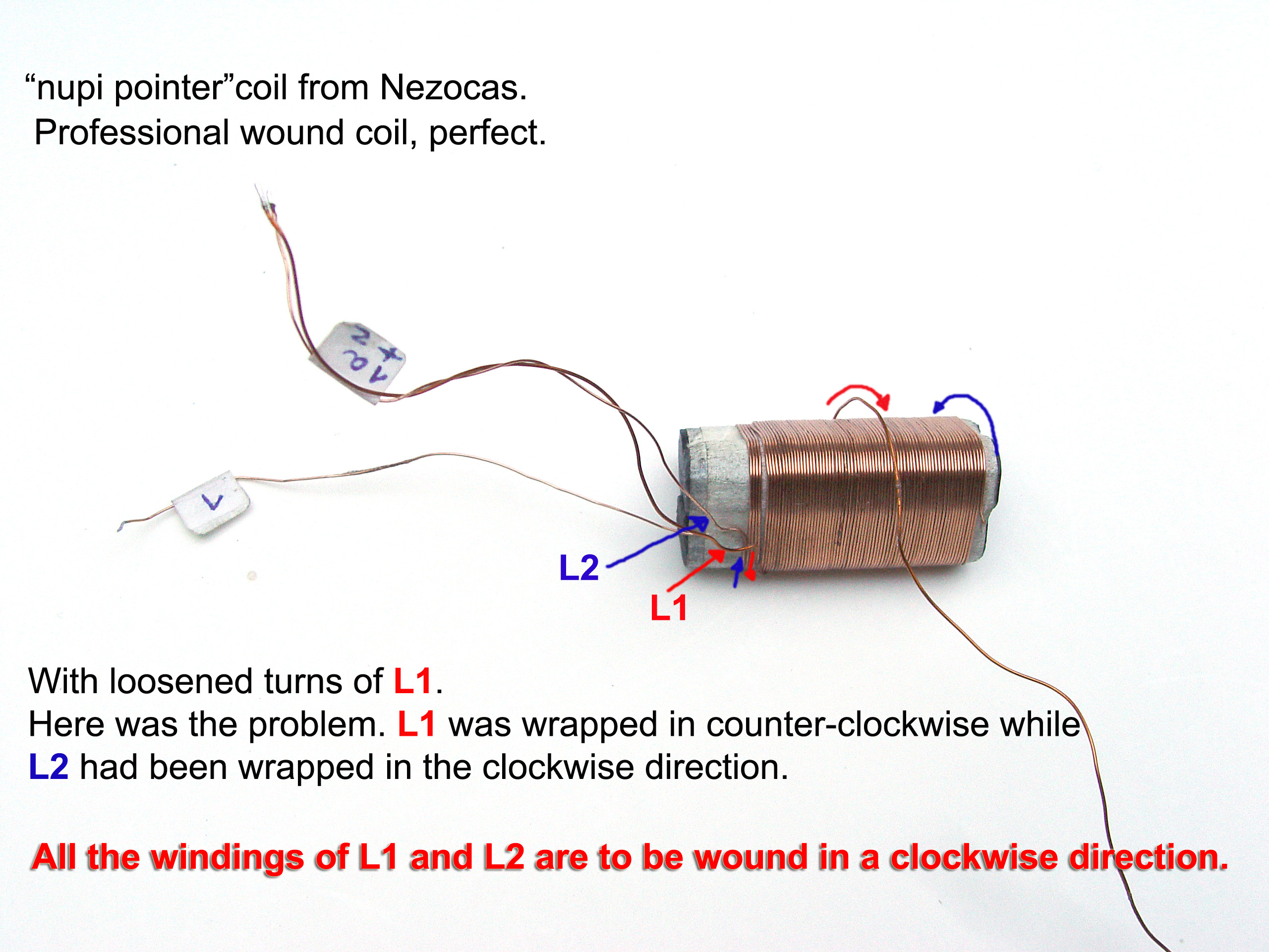

              I did some measurements and the coil is not wrapped properly. Independently of each other, the measure ar L1 = 2,32-uH
              and L2 = 1,34-mH but together is 537-uH. That means that L2 or L1 is rotated counterclockwise, and that should not be.
              All the windings of L1 and L2 are to be wound in a clockwise direction.
              Tomorrow I go further and turn the coil open. Maybe I can make tomorrow a video with the results of it.

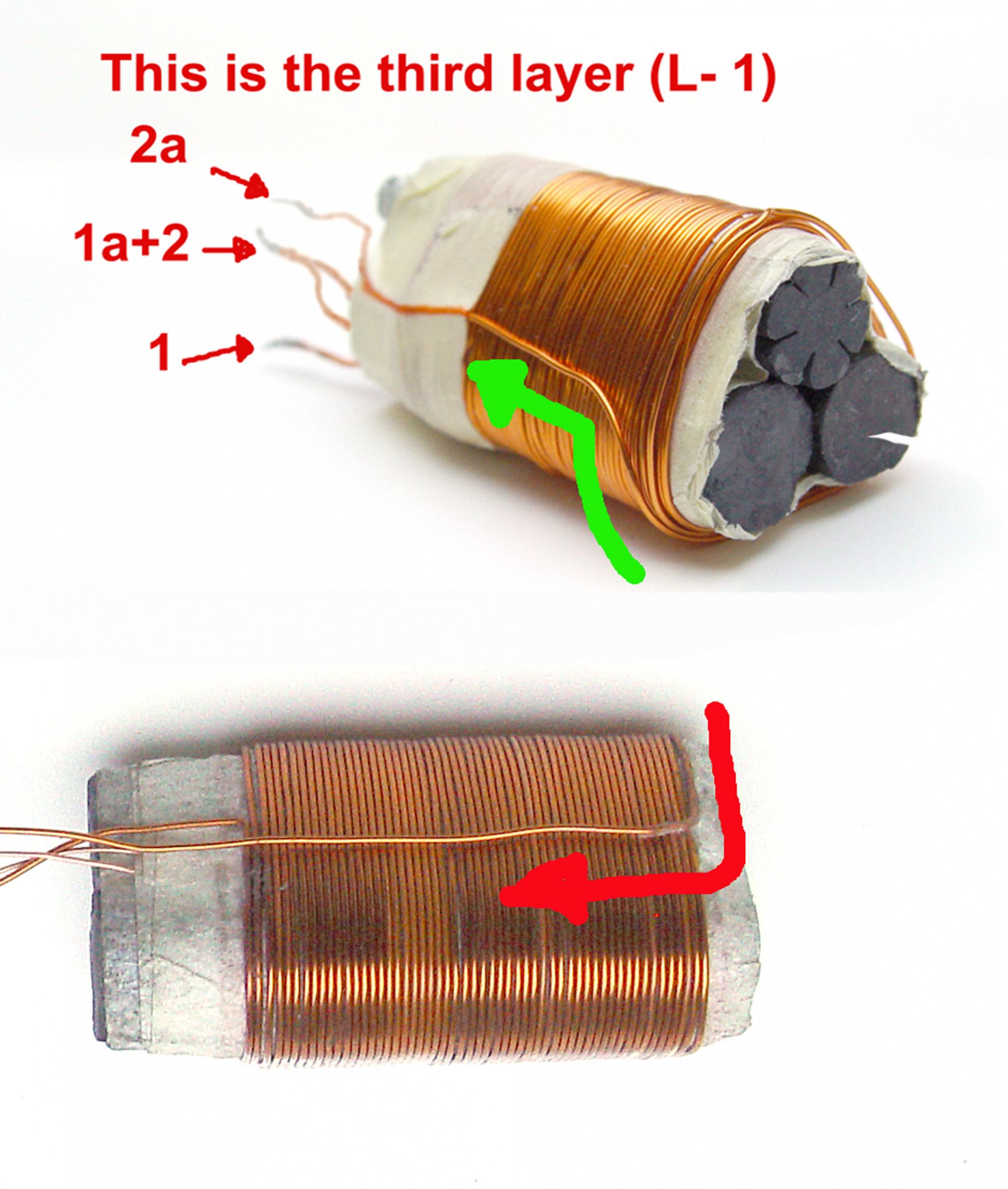

                    Hi Nezocas,
                    It does not matter that you make a mistake. There you can learning a lot from.
                    If you knew how often I am mistaken.
                    On these pictures you can see what has gone wrong.

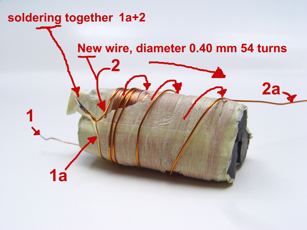

                              • Hi Nezocas,
                                Today, I had not time to make the video, but I did restore the coil. I can not wrap the coil so good if you do that,
                                but you should do it again by yourself, okay?

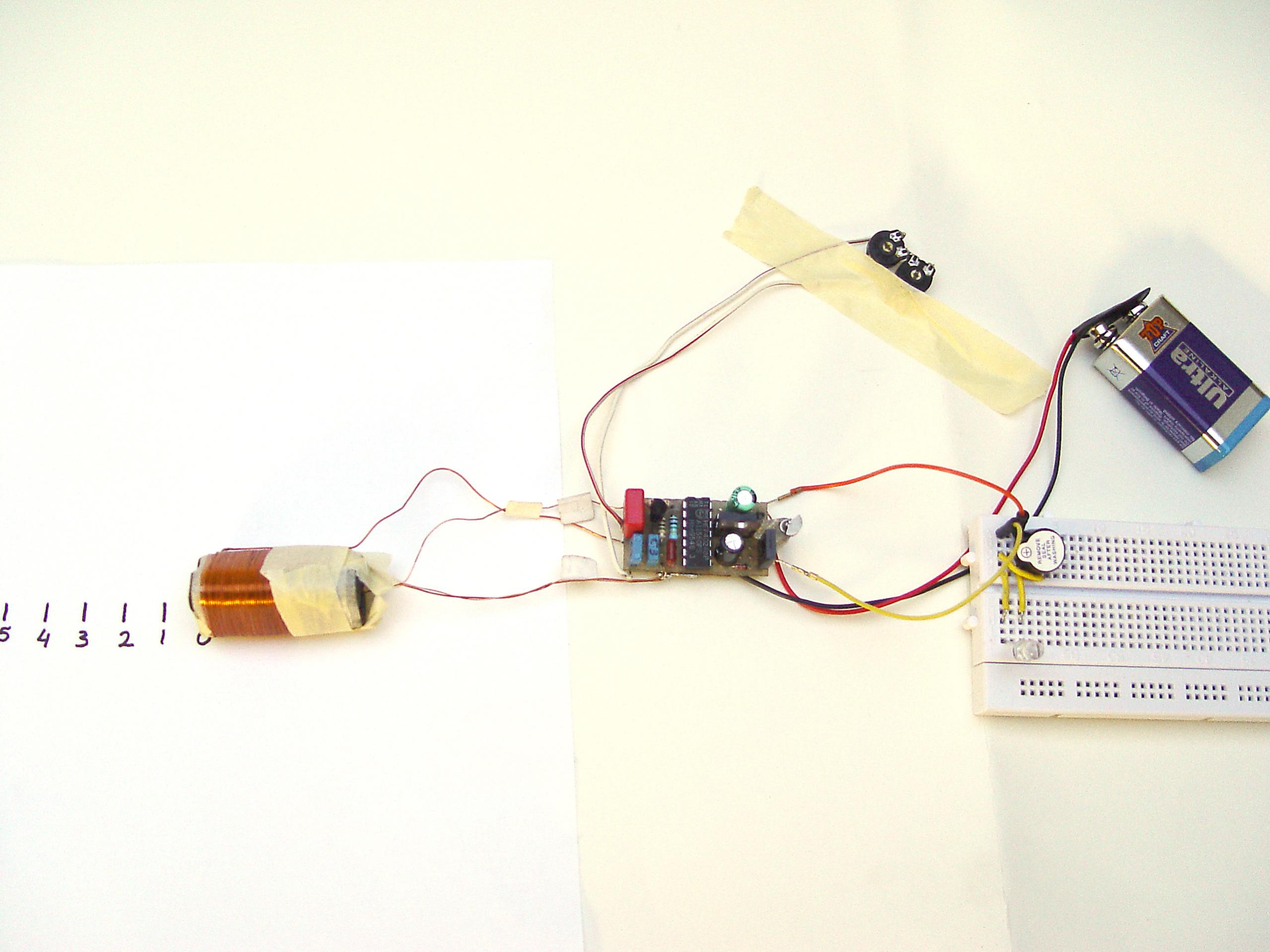

                                Everything is doing well now.I have, C2 - 47nF replaced by a 33nF and the 2N3906 transistor replaced with a BC560,
                                this for a better performance. He is now as good as the prototype.Nice!!
                                Tomorrow I try to make the video, Which includes a stability test.
                                In this photo you can see the setup for the video tomorrow.
